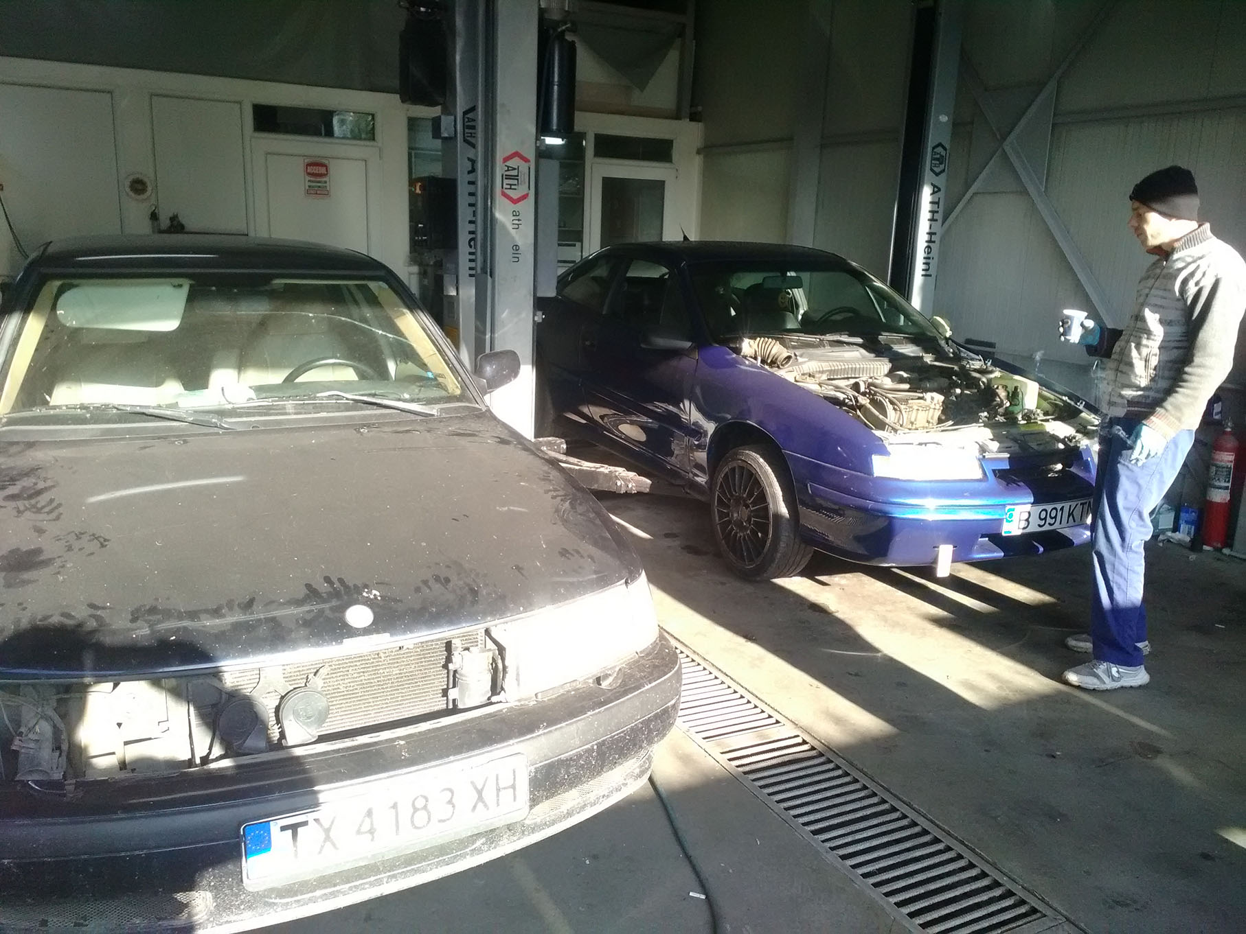

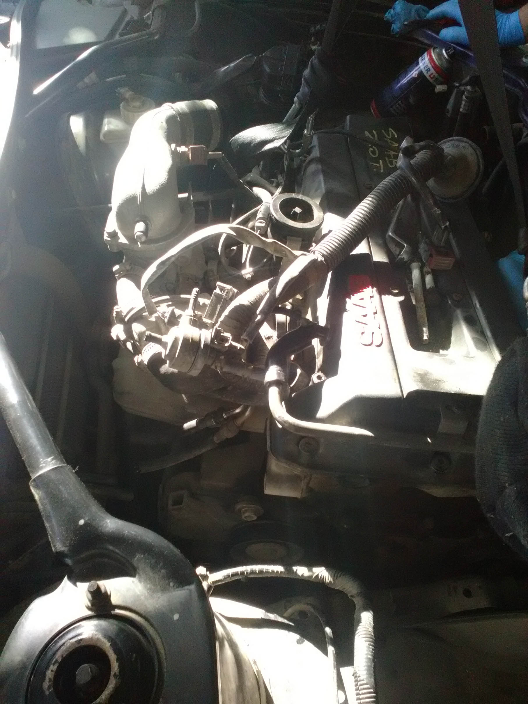

Hello guys.My name is Cosmin,i am from Romania,and i just started my b204 calibra project.
These swaps are popular in uk,but here nobody did it before.The donor car is a 93 saab 2000 reg,b204e lpt.
I checked the engine,is in very good shape,no smoke on exhaust etc,changed the sparks ngk ones bcrcep-11,water pump,accessories belt,thermostat,rocker cover seal,cleaned the oil bay and sump.
I was ready to make the swap.i am using saab engine,gearbox fm05,507,hydraulic, new clutch.Bought the v6 electronic speedo, and change the rev counter from 4cyl one.
Here are the pics with the progress so far and parts bought,painted engine bay,no rost at all(very happy). :)
8v OUT
ready for transplant :)
donor 93 LPT
