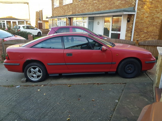

Hi All . Thought it was time I joined this site after some reccomendations on a Facebook page .

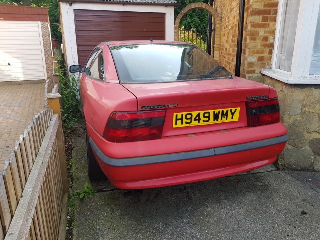

Back in 1994 my neighbour purchased this H reg calibra for some £5000 in 2hich time it was used occasionally covering very small mileage . For the past 5 years or so it sat on his driveway going more and more pink and gathering mould and not a week went past where I didn't ask if he wanted to sell it . Finally ! Just before Christmas he did ! For the sum of £250 a set of alloys and my ford puma lol

by Allanc20xe » Tue Apr 17, 2018 5:32 pm

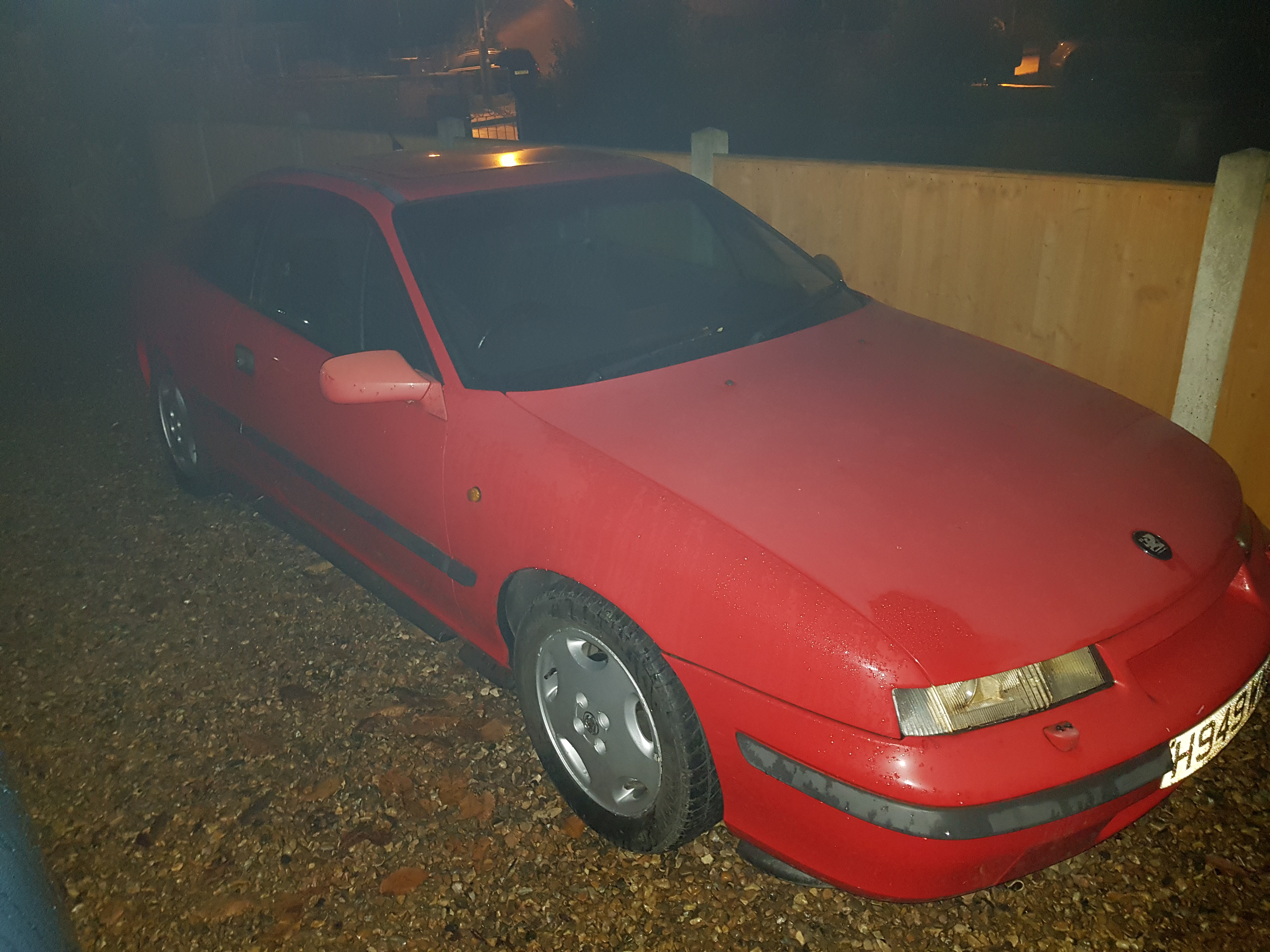

It would turn over and not run and hadn't done for a long time . The original slabs had been removed and the tyres taken off and just left in the garage :think: . First thoughts to me was just store it and sell it as it sits then I had a 4 day break between jobs . Looking over it it has some rot on the body but underneath was solid and she had only covered 61k . Non running was diagnosed down to the fuel pump . Stuck a new one on and changed the filter and boom she started however would not idle for love more money . After some fannying around and changing a few bits a new fuel regulator and idle control valve made it run like a dream

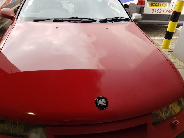

by Allanc20xe » Tue Apr 17, 2018 5:36 pm
I then proceeded to get the propper alloys back on it . After a general look over I replaced the osf coil spring and top mount . Front discs and pads . Rear pads and sorted the handbrake . Replaced a load of bulbs . New wiper blades . Rebuilt the speedo as the clocks where peeling and stuck it in for an mot and held my breath

by Allanc20xe » Tue Apr 17, 2018 5:40 pm

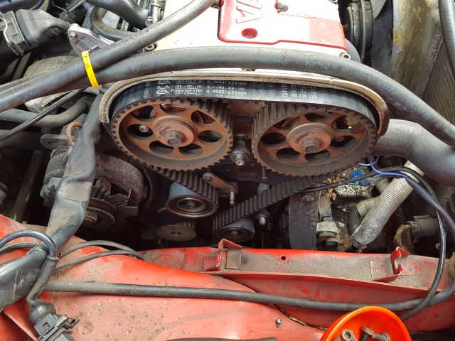

And with a fresh ticket there she sat for a month until I gathered some parts , time and , money . Sorted the heater which didn't work at all ( resistor ) and run it up as much as I could to get decent fuel through it I then proceeded to change the cambelt kit . Water pump . Thermostat and the aux belts aswell

by Allanc20xe » Tue Apr 17, 2018 5:45 pm

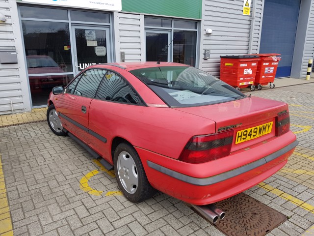

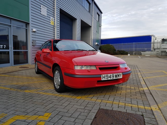

I decided to tax it and temp insure it and drove it for the first time in months and she drove like a dream . A very pink and dirty one lol . I got it to my work and then hit it with TFR and the jet wash then came the mopping and polish

by STEVA » Tue Apr 17, 2018 6:33 pm
Hello and welcome matey
What a cracking job you've done!
looks like a different car amazing work
