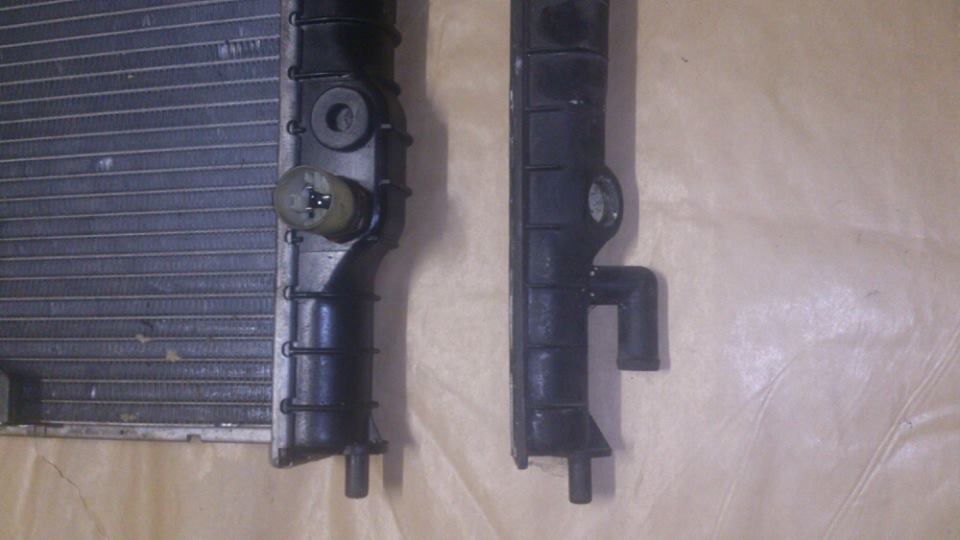

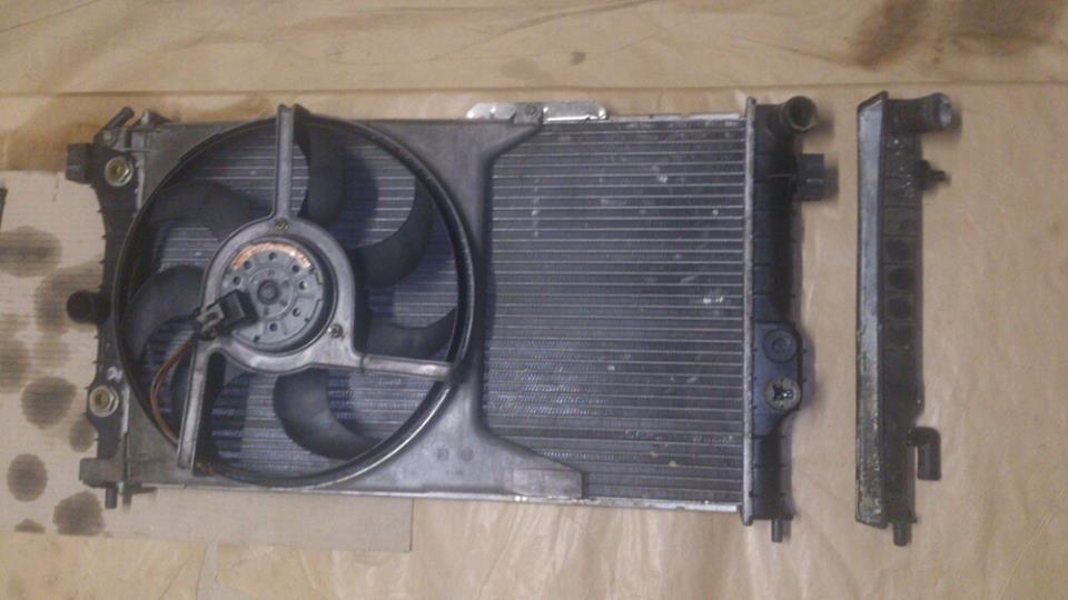

Installing new rad today , unfortunately new rad is useless as it doesn't have the connections on it for the pipe work for the secondary water pump

by EddeyDancer » Sat Nov 23, 2013 2:59 pm
Mate...
You can swap the side tanks over...
A mate recently had this same issue...
I sent him over the side tank, with the 'Aux Water Pump' fitting...
He heated it up in the oven, in order to fit in back onto the Radiator Core...
Also, I once scored a Radiator off a V6 that didn't even have a fitting for the Aux Water Pump...
It being so cold over there in UK, perhaps it might not be so necessary to have the AWP connected...

by Teejay » Sat Nov 23, 2013 3:11 pm
Hmmm, might give that a try
