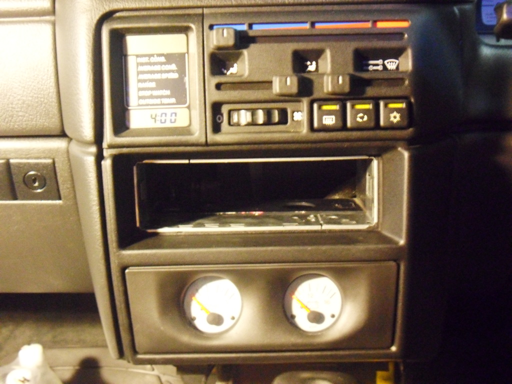

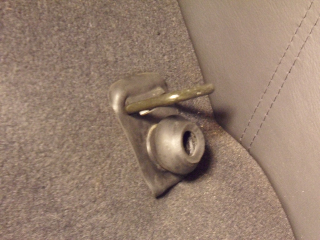

Just touching up on some of the smaller aspects, of the Interior...

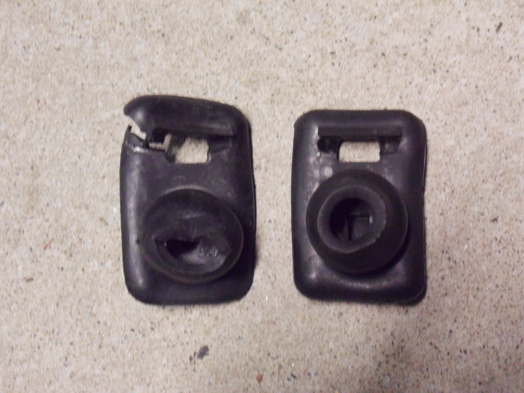

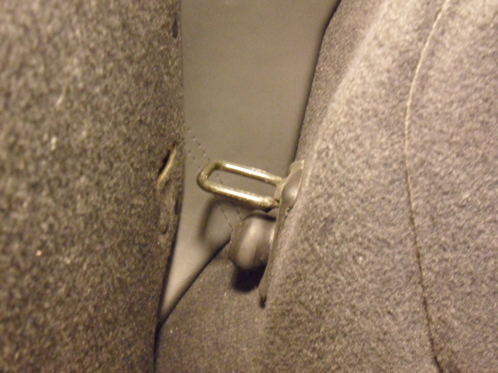

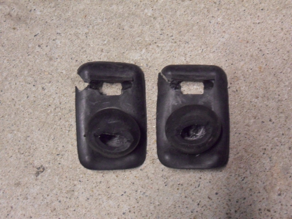

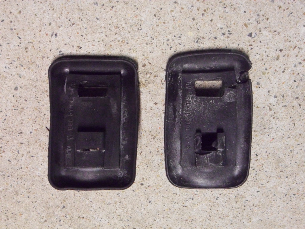

Have You ever checked Your 'Rear Seat Rubbers' condition??? If mine were shocking, Yours will be even worse!!!

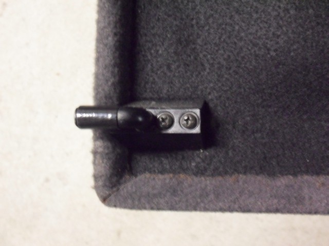

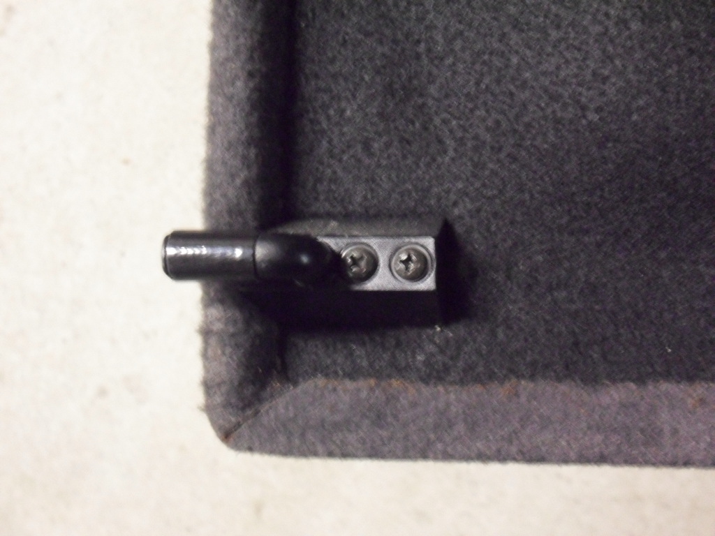

I also tightened up the screws on the Parcel Tray hinges, and taped up the rubber sleeves on the positioning shafts!

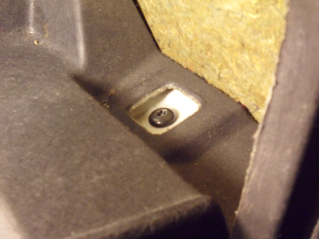

I then tightened up the torx head bolts, for the Inner Trim of the Tailgate, and they needed it...
I also removed the Old Eurovox for the Audio System to be Updated...

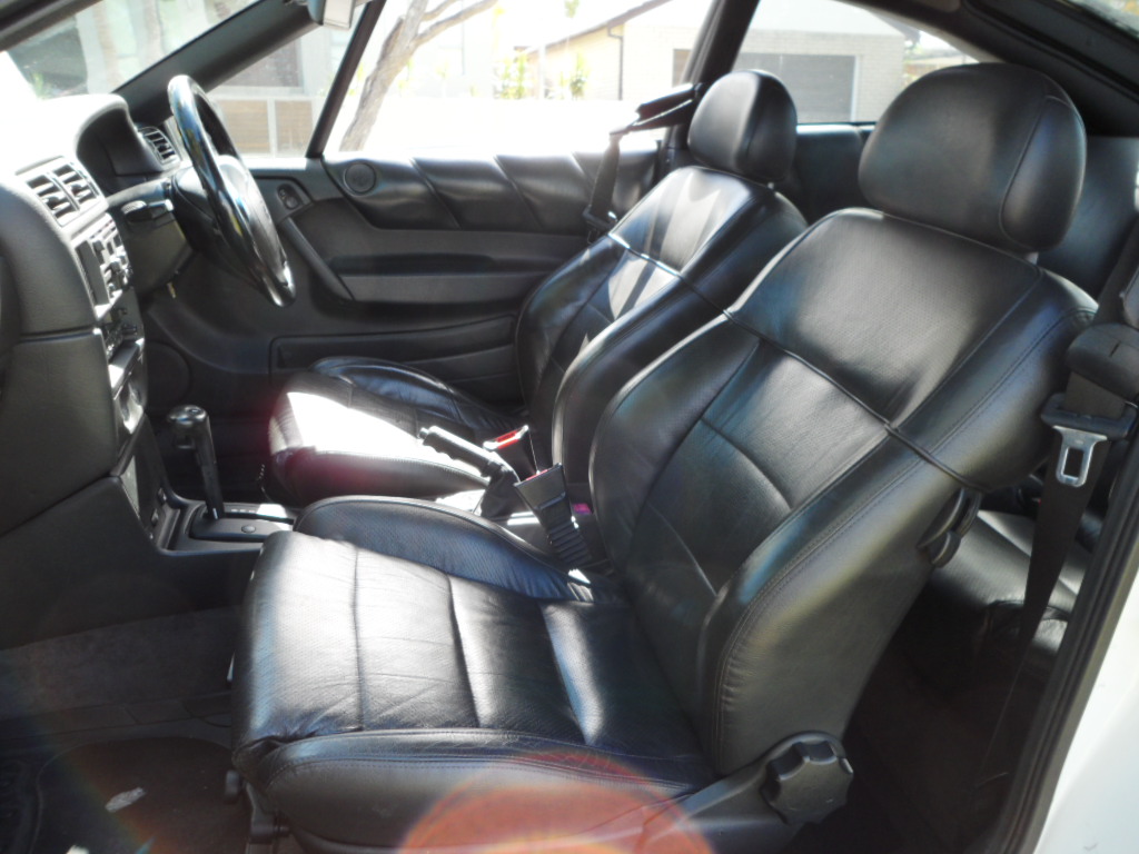

Today, I plan on finishing the 'Interior Phase' completely... Except for perhaps the Stereo replacement...
All that's left is to locate and re-route the Heated Seat wiring, reassemble the centre console, and fit the new front seats!
Then I'll take some photos and do a 'Before and After' Post on the interior Phase!!!

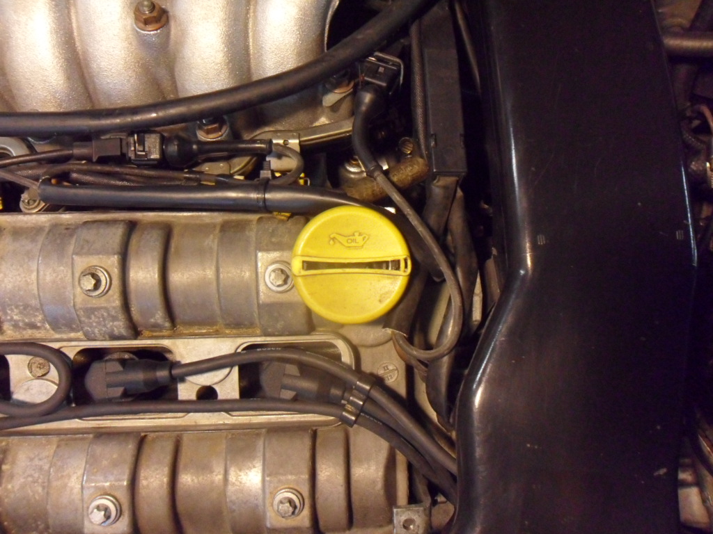

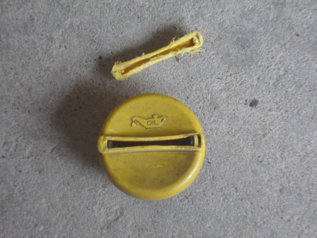

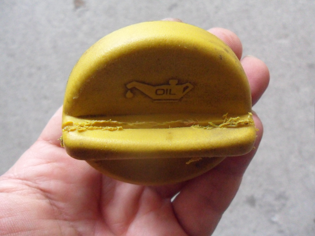

OIL CAP EXPERIMENT
I trimmed off a bit from the Top of the Oil Cap, in order to reduce the clearance...
This experiment was done to allow fitment of the V6 Engine Cover, after the Cam Cover Metal V6 Vectra Upgrade!
The reduction in clearance helped for sure, but might not be really necessary...
I did have to Modify the Engine Cover as well, in order to get the Cover back on...

I'm really pleased with the 'New Look Interior' and I'm loving the Seat Warming Option too!

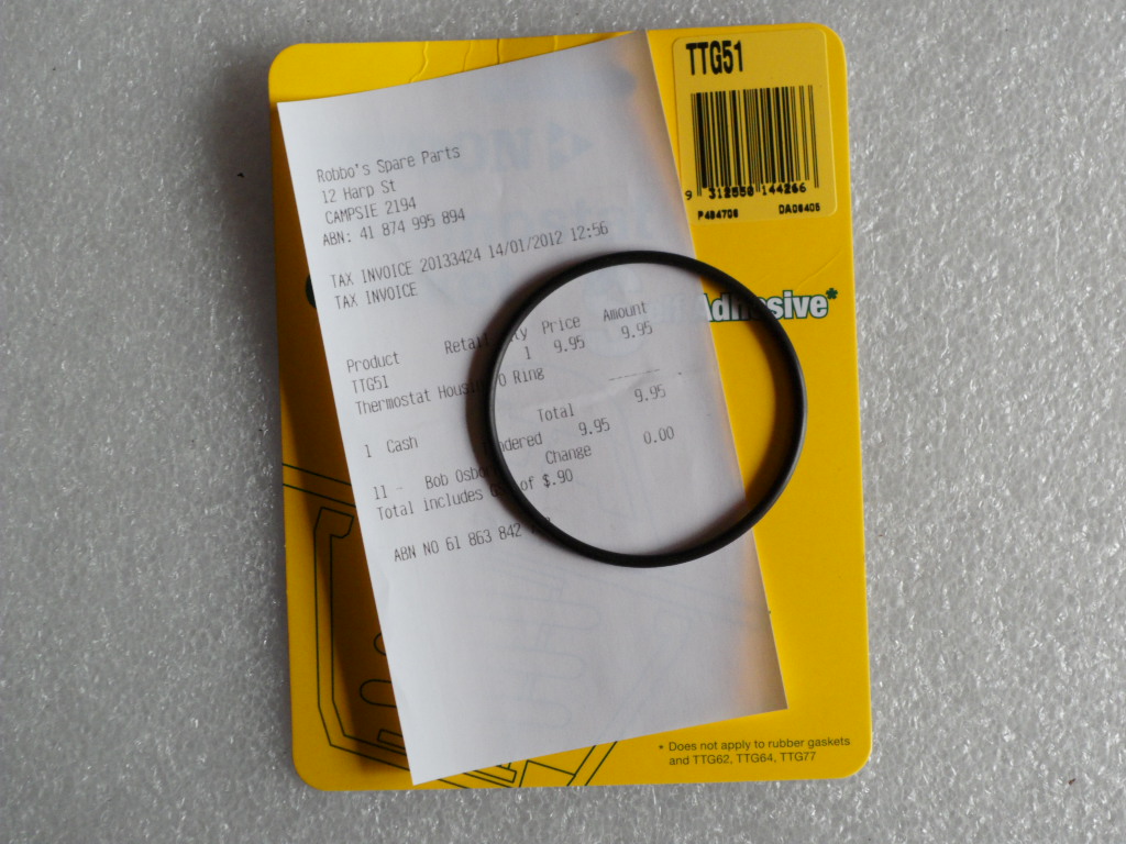

I eventually got everything done, and almost had to postpone the work, had I not have located the New Thermostat Gaskets!

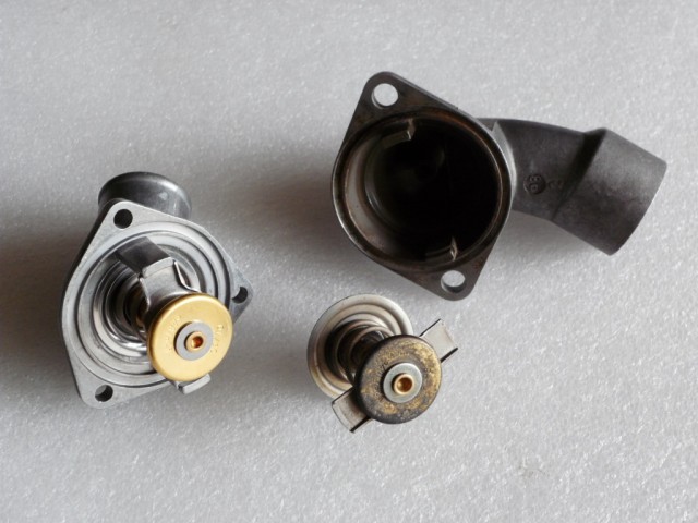

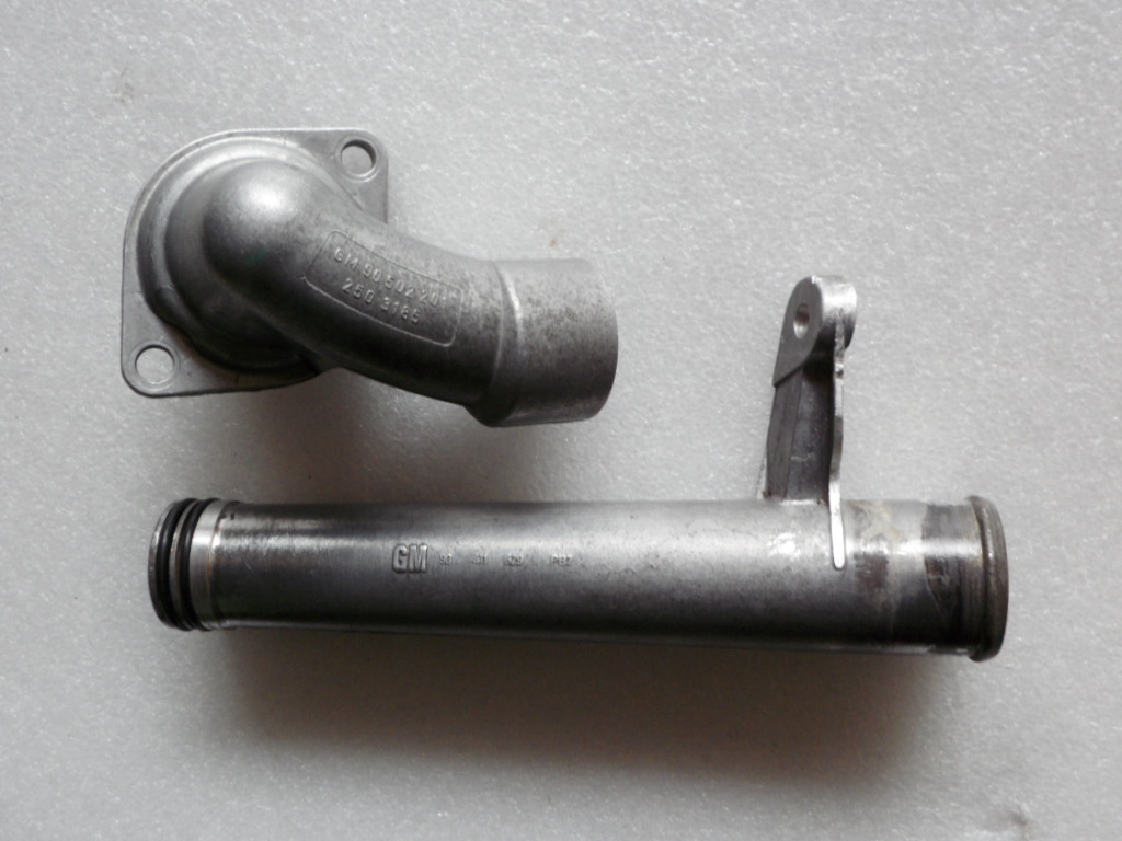

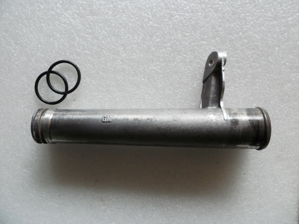

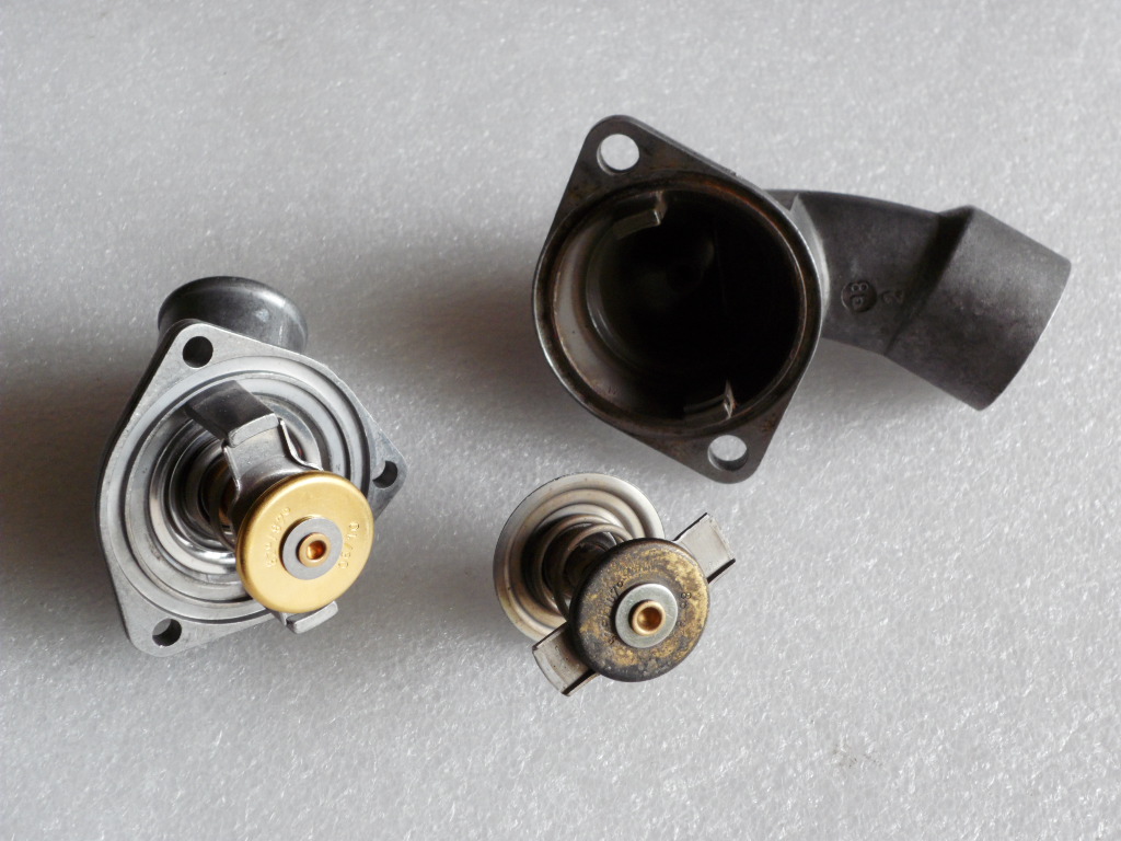

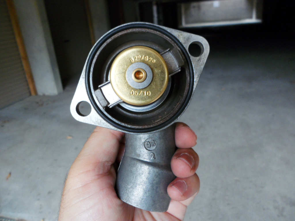

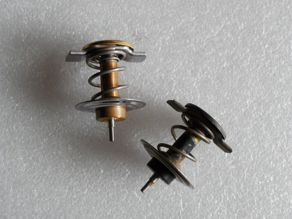

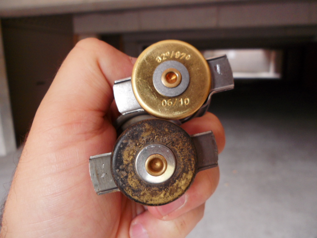

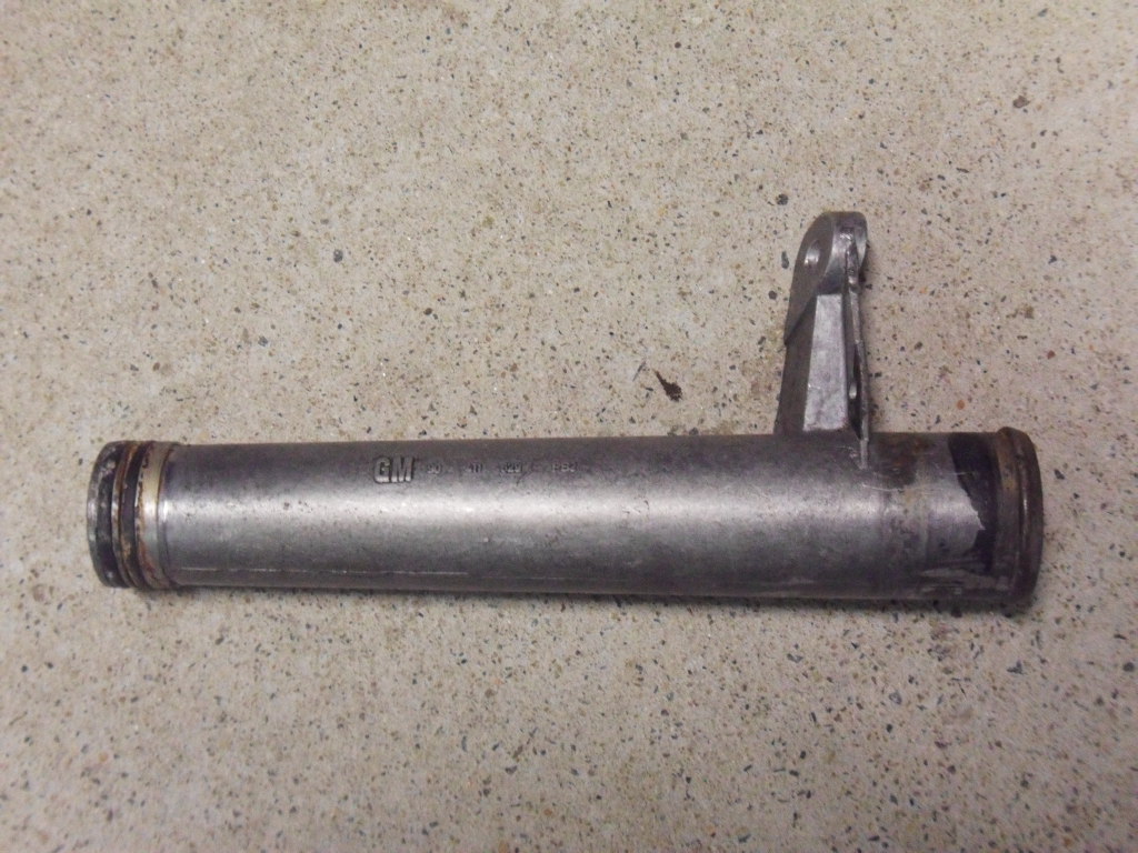

THE THERMOSTAT AND EXTENSION PIPE
Thermostat 82 - 97 Degrees - Housing and Extension Pipe cleaned, New Part and New Gaskets now fitted...
I gave these parts a good cleaning up, in preparation for this Phase!
THEY ARE NOW BOTH READY TO GO!!!
I spent most of yesterday cleaning, sorting and preparing all of the Parts for this Engine Phase!
The following entries clearly detail the events, of the day...

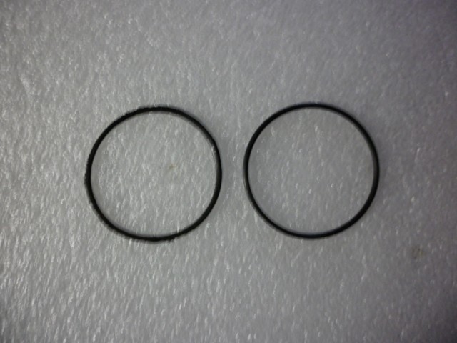

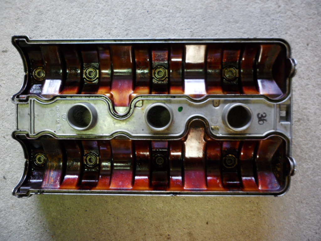

THE CAM COVER METAL UPGRADE

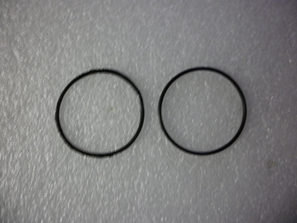

Cam Cover Metal Rear - Upgraded Vectra Part with New Gasket with O Rings (Front Cover already done a few weeks ago!)
I gave the Rear Cam Cover a good scrubbing up with Throttle Body Cleaner, in preparation for this Phase!
IT'S NOW ALSO READY TO GO!!!

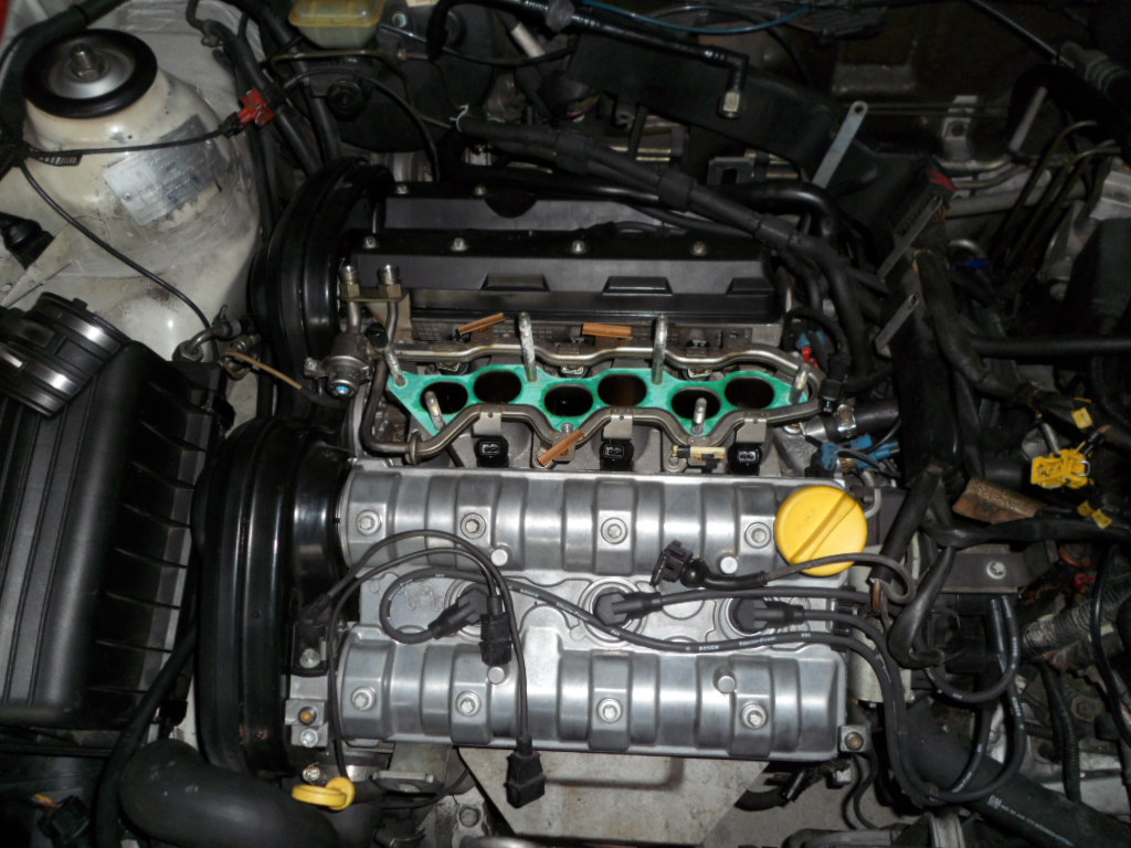

COMMENCED ENGINE PHASE:
I started the 'Engine Phase' the other day, and had a good start...
1 - Removed the Upper Inlet Manifold with ease...
2 - Removed the Fuel Rail and Injectors with ease...
3 - Removed the Centre Inlet Manifold with ease...
4 - Removed the Lower Inlet Manifold with ease...
Then the Headaches started...
Whilst trying to remove the bolt that secures the 'Thermostat Extension Pipe' with 8mm socket, it slipped...
Tried various different size tools, but none were gripping the damaged bolt, so I decided to give it a break and do some other work...
So I fitted the Metal Cam Cover on the Rear... All was going well till the last bolt... It was not tightening, and just kept turning, but the
worst thing about this was it's R1 location... I knew that the Cam Shaft Retaining Bracket was threaded, but the R1 Bracket is one that
I didn't have a spare... I tried several different bolts, hoping one would grab, but there was to be no suck luck...
I gave up one this R1 bolt, and continued with stripping the Original Upper Inlet Manifold...
I removed the all of the components, and transferred them over to the Polished Manifold...
Now that's ready to go, I then fitted the Serviced Injectors onto the Fuel Rail, and clipped them secure...
That then disappointingly concluded Day One of Engine Phase...
