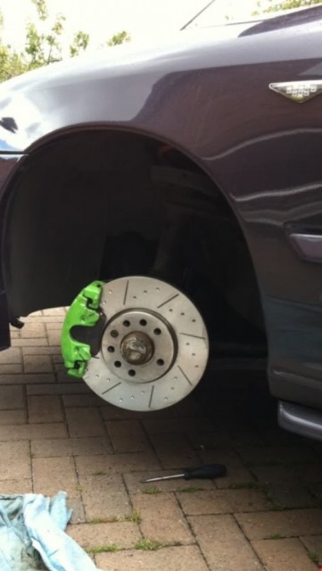

Refurbed the callipers

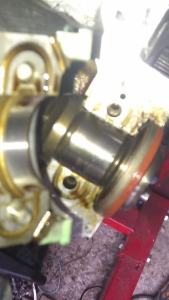

After fitting the New front crank seal i dropped the oil which looked quite new then removed the sump pan and found white metal shell debris on the bottom and also in the oil pick up pipe strainer.
I then checked the con-rods for movement and found i was able to rock No 6 from side to side due to clearance. on removing the con- rod cap on No 6 pin - i found the shells where overlapped and the con- rod cap was damaged due to contact with the crankshaft web.
this damage has been caused by oil starvation, and would have caused excessive big end knock which would have been very noticeable whilst running.

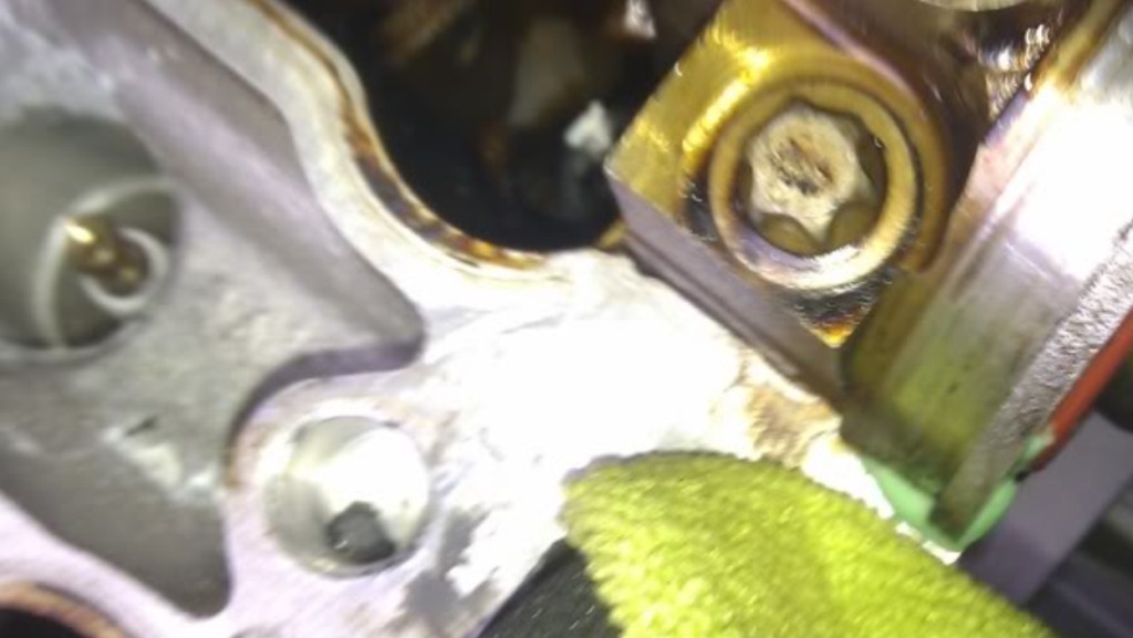

Next job was to remove the induction assembly and replace the heat exchanger which has seen better days. A hole in the heat exchanger plate had caused some coolant leaks.
No anti-freeze either so the water jacket looks a little ropey.
bore sizes 0= standard size pistons - they are under the vent housing on the 3.2 & 2.6 older engines had them by each bore but it caused the cylinder head to leak if not filled with sealer
Heat exchanger plate requires a liberal application of grey sealant.

Got some new discs

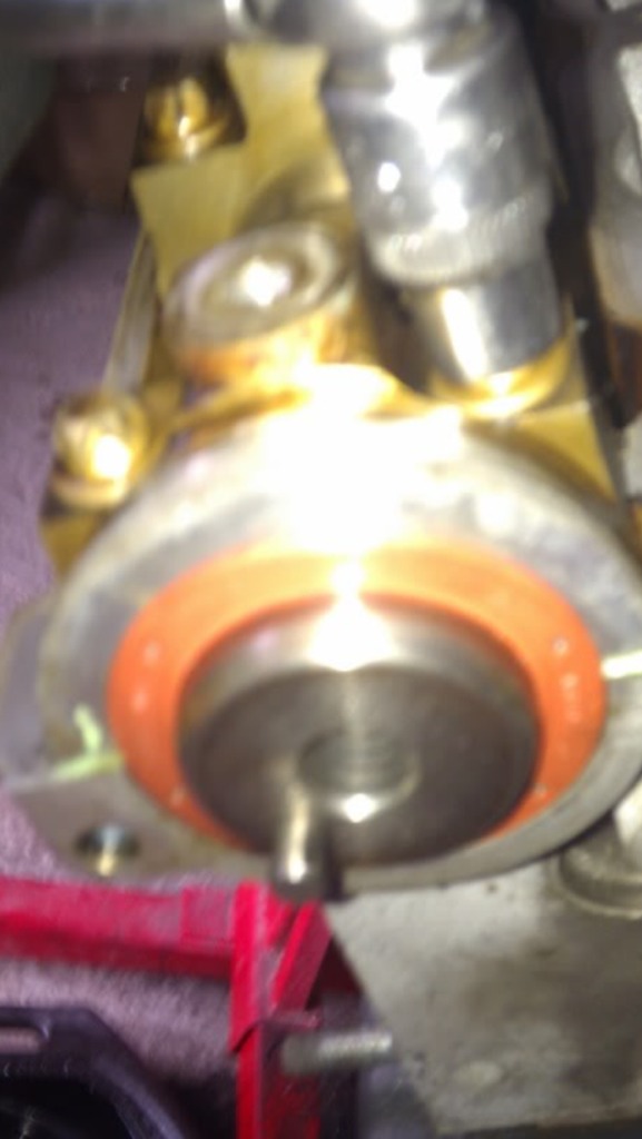

cam cover seals & O rings fitted
cam seals fitted - front cam caps sealed with Omnifit - be aware keep it well away from oil channel!
cam caps torqued to 8 NM
excess Omnifit must be removed for cam covers to seal

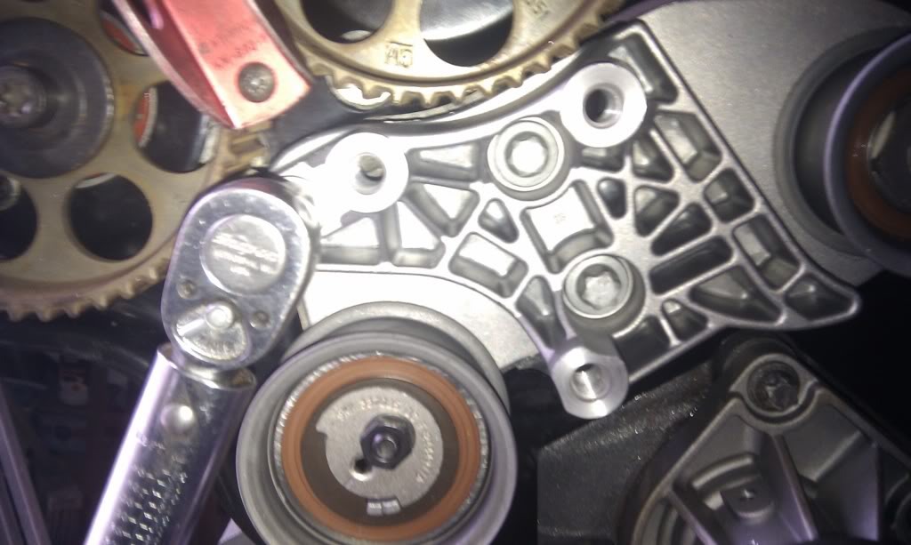

backplate fitted and torqued to 8NM

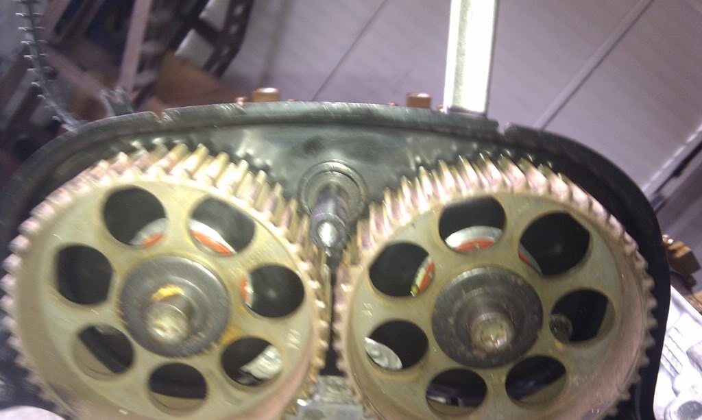

Cam gears fitted note from left hand side (1-3-5 exhaust cam aligns with No 1 1-3-5 inlet No 2 and so on
cams turned to align cam gears with backplate cutouts (this is what they are for)
cam gear locks fitted (factory tools) and bolts torqued & angled
half moons and front A Bearings cam caps sealed with loctite 5900
cam covers fitted and torqued to 8NM
tensioner housing (motorbike as known in the factory) fitted and torqued 40 NM

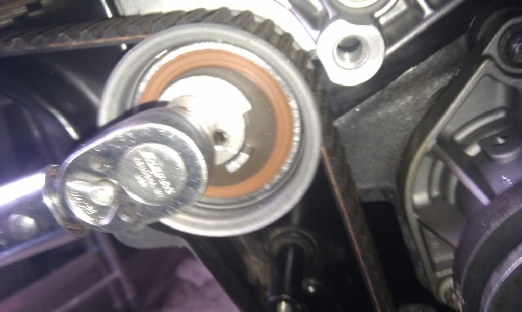

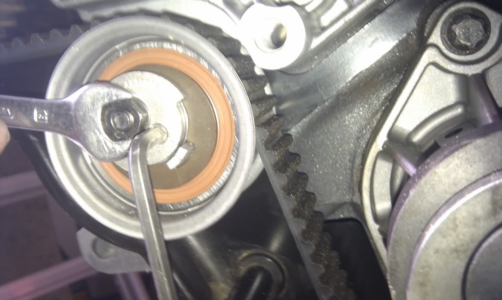

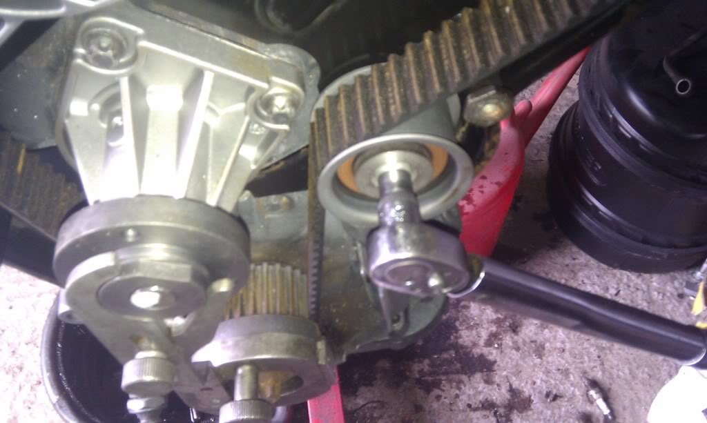

belt fitted note all slack pulled over to 2-4-6 bank in order to fit bottom none eccentric roller
all slack pulled back so that crank marker lines up with oil pump notch
top roller set
tensioner set to full tension
engine barred over and timing marks checked - (note no adjustment on 2-4-6 bank on this model due to none eccentric bottom roller)
rollers torqued up 40 NM
Tensioner set and torqued to 20 NM

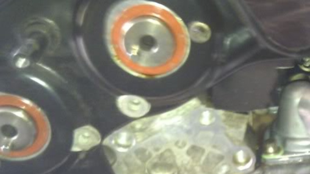

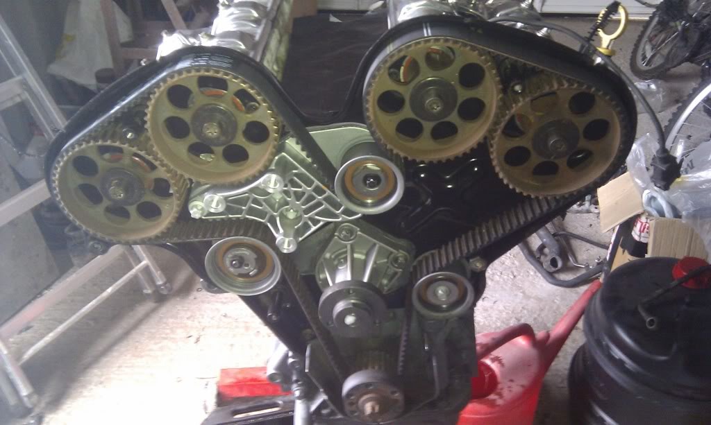

Timing complete
timing cover fitted and bolts torqued to 8 NM note - extra bolt fitted to later models
water pump pulley fitted - bolts must be loctited

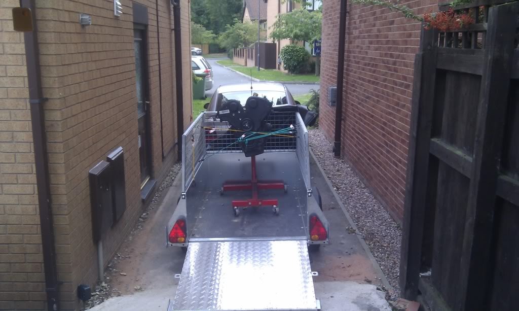

Engine on it 's way to the garage with a four poster
