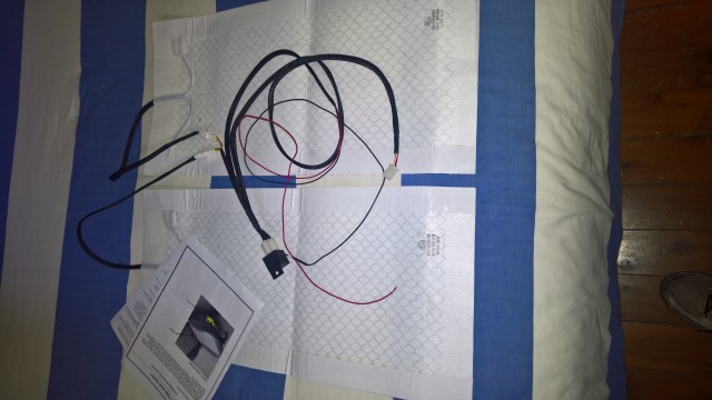

On somewhat of a brighter note this morning I received the following in the post;
The seller very kindly included the relays and the additional harness required. I like that the elements themselves are edged taped and even the additional wiring is properly harnessed. The elements also can be trimmed to tailor the fit with additional edge tape supplied to complete the job properly.

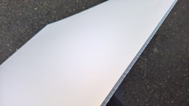

Started fitting the Regupol underlay in the rear sections of the floor. It moulds to the contours very well while remaining substantial... it's 10mm thick. Plan is to top it with a thinner layer of foam underlay before fitting the carpet. I'll post up some pics when I do the front section.

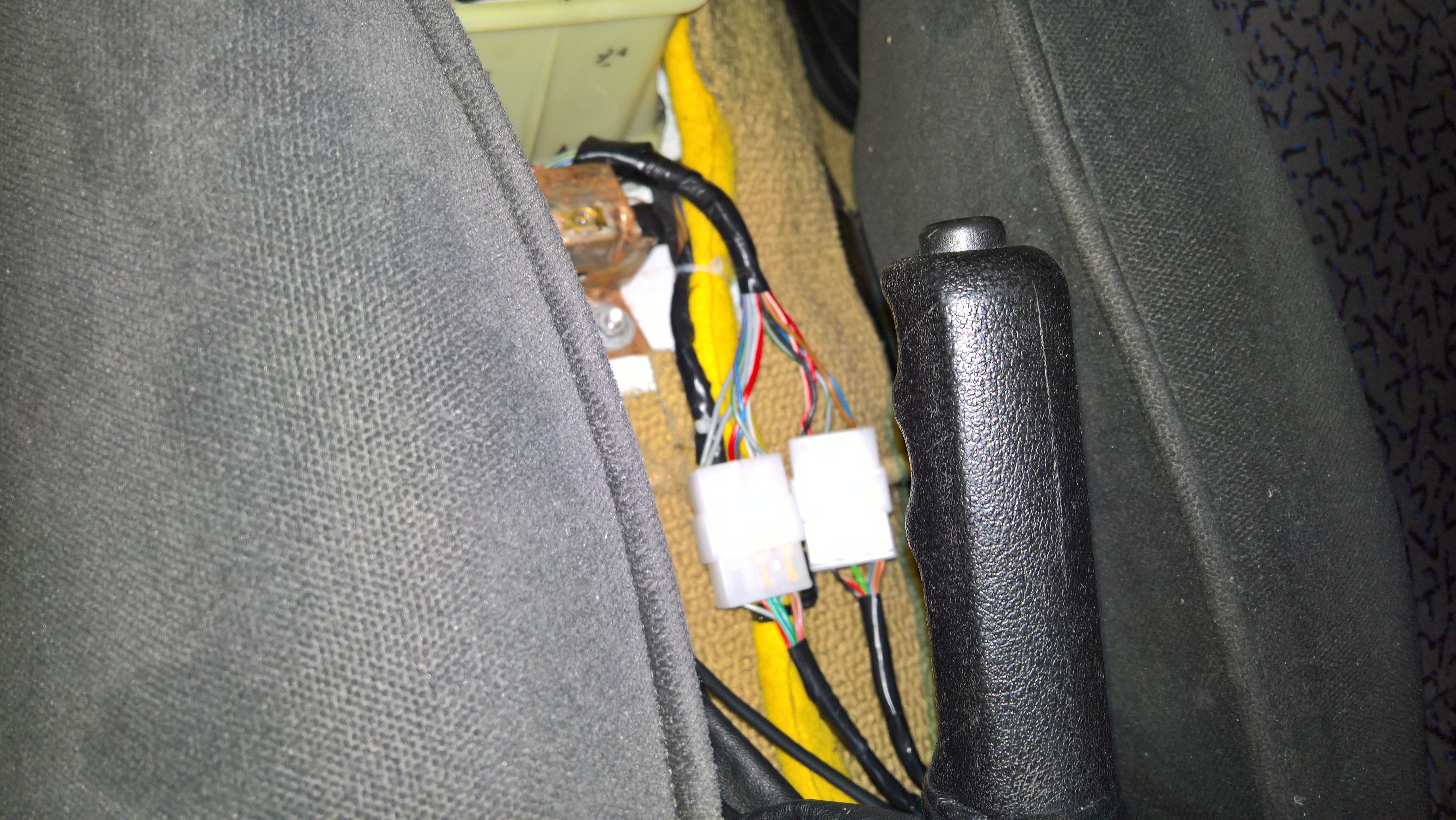

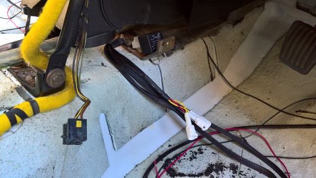

Just laying out a plan for the new heated seat wiring. Found a shifty spot to mount the relays

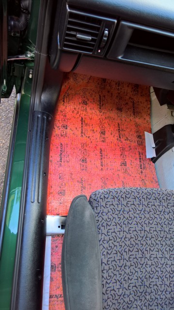

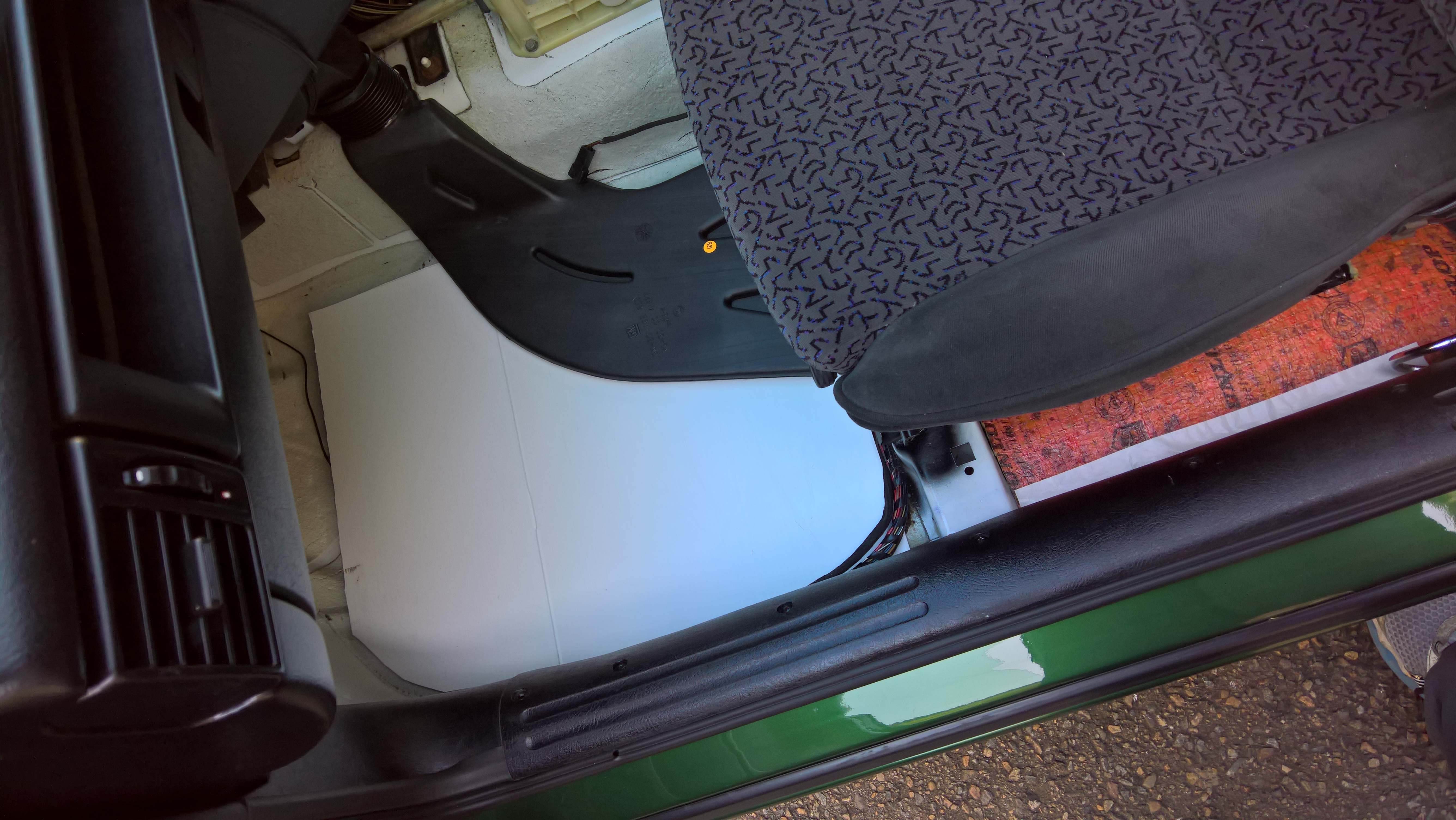

Ok, front underlay in place. Unfortunately I'm still waiting on the new carpet... was supposed to be here today
Anyway the task is not rocket science but some pics of what I used and how I went about things.
Just need to finish taping the foam around the edges in the passengers footwell (I ran out of cloth tape
) and layer either side of the tunnel to build up the carpet layer to finish flush with the sides of the center console.

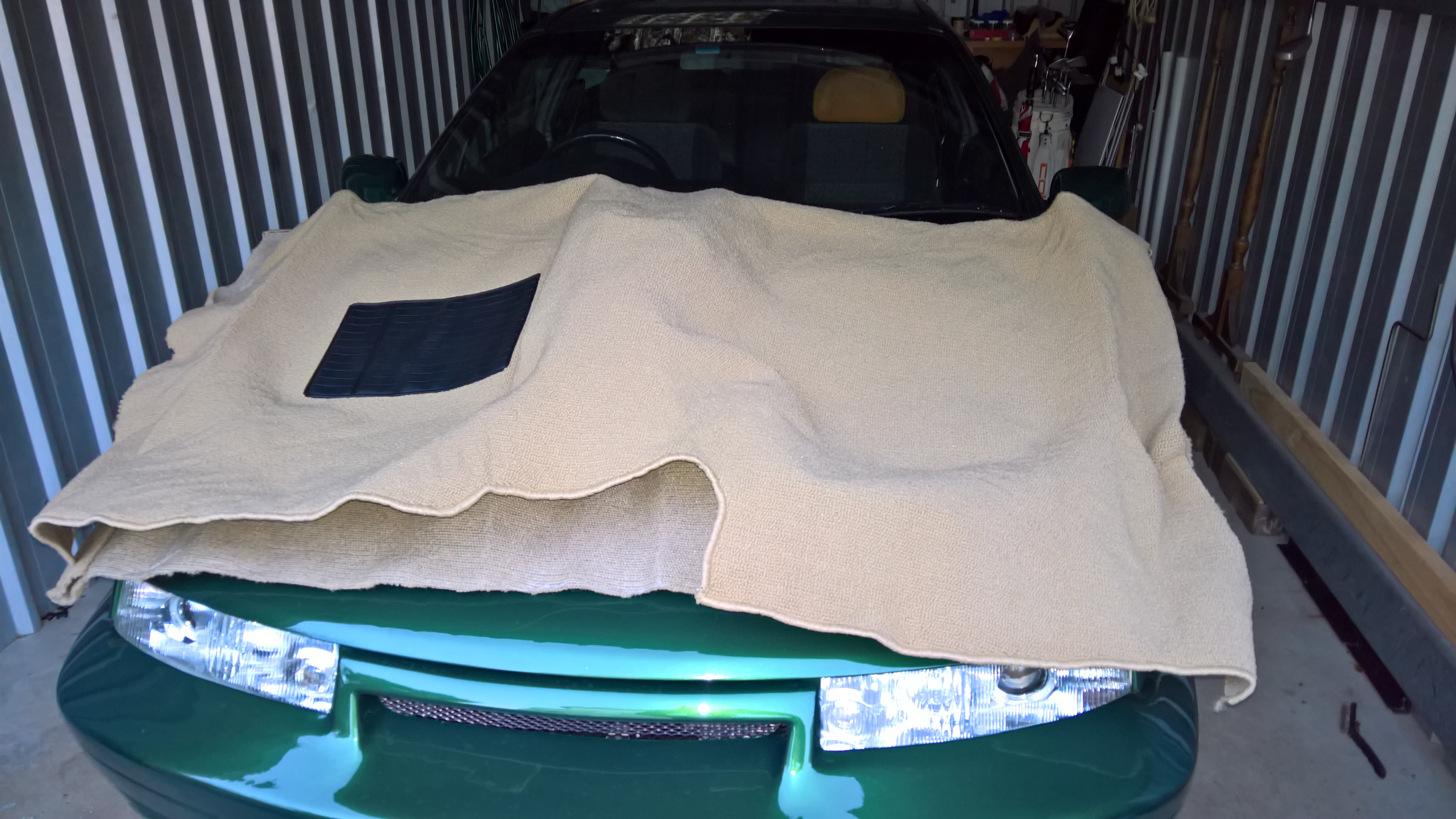

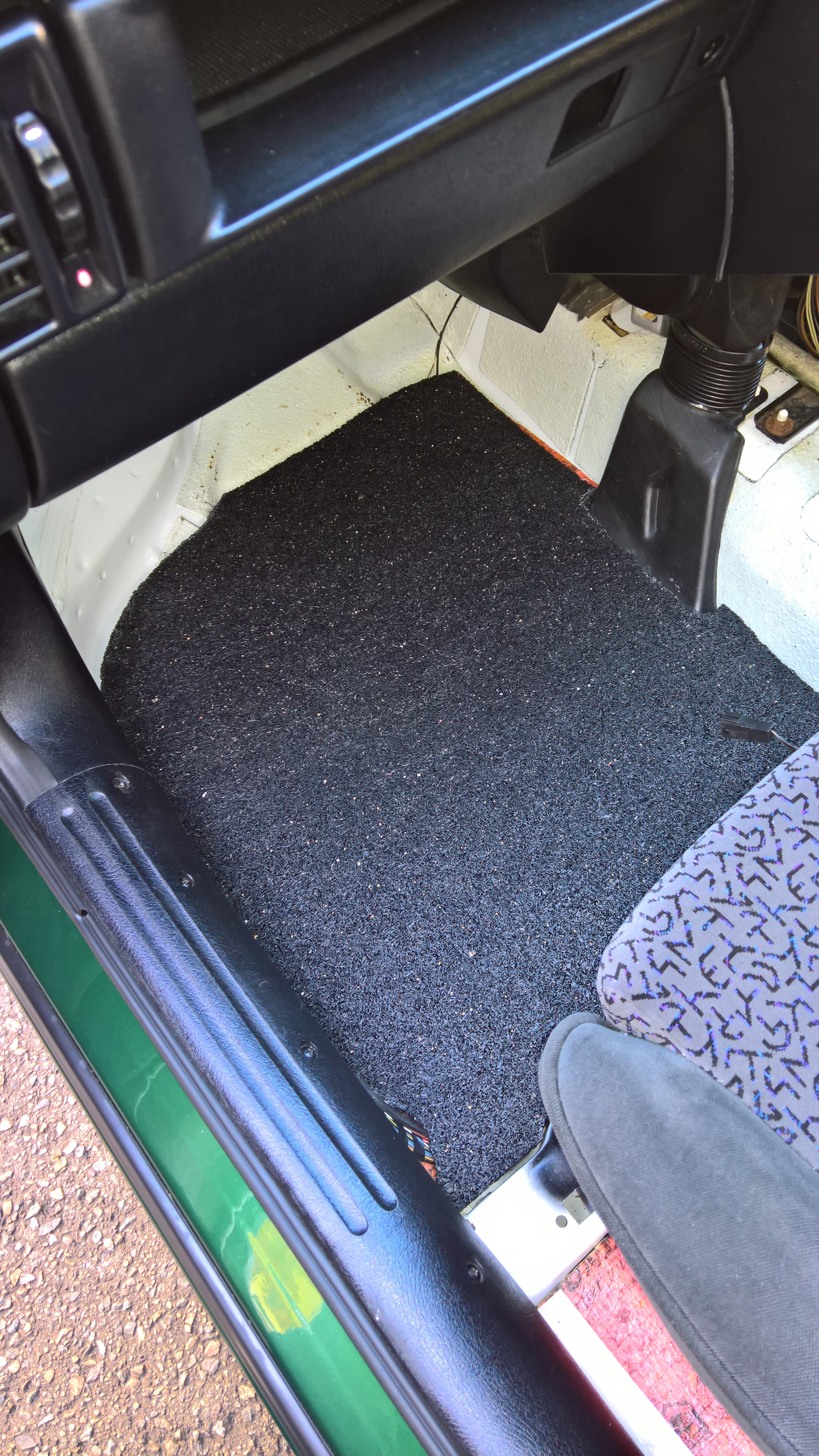

New carpet is now in place and I'm getting ready to send off the front seats for recovering.
Am a little disappointed in the number of hard creases the carpet arrived with from the manufacturer. I know in time these will fall out but as its the middle of winter here this will take some hot summer days and weight in the right places. Fit was good in the rear, not so good in the front but some strategic cuts and tucks and it looks ok now.
Pics up when the seats are done.

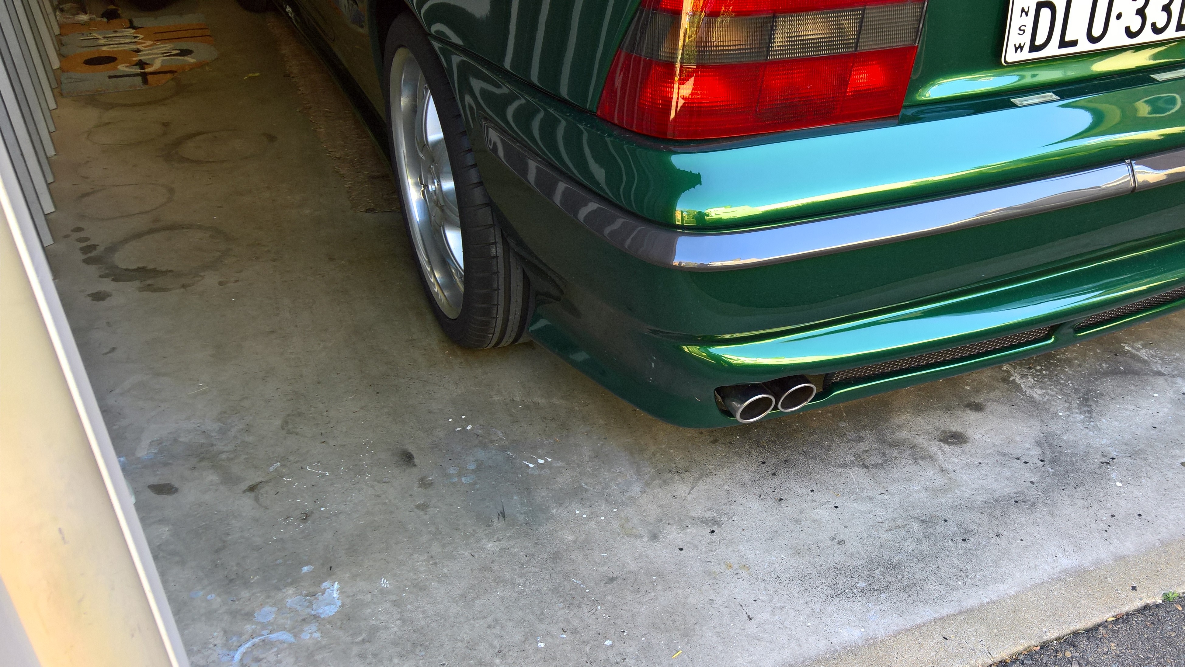

Also waiting on a time slot to have the exhaust finally tidied up... off with the rear rice bucket box to be replaced with a new muffler/twin tip arrangement.

Anyway now that the carpet is in it's time to run the permanent wiring for the heated seats and tuck that all out of the way. Refit the consoles blah blah
Exhaust booking for Tuesday morning fingers crossed.

Exhaust booking for tomorrow confirmed. Spent the day tidying up the consoles, leather gaiters etc. Seat wiring is now finished. Just all the little bits that always seem to get overlooked. Freshened up the seat belt stalks as they were badly faded.
