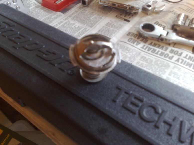

Here's the thermostat, it was new so i'll put it down to leaving it in the housing at the powder coaters. Also a different housing to my other one so it was another trip to the powder coaters (3rd time lucky)

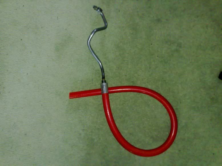

After I think 5 journays to Pirtek, the turbo water return pipe fits, just a few bends but will keep it away from the manifold

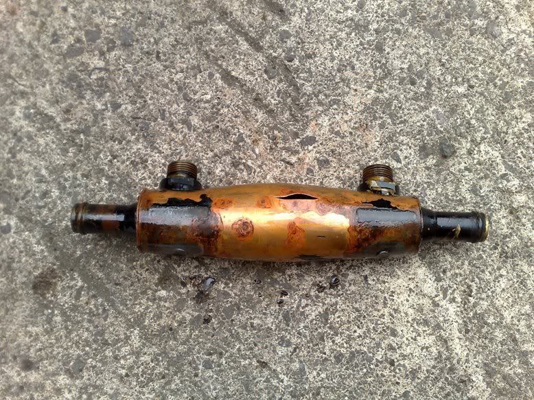

Hoping to get the car finished this weekend. Started off bleeding the PAS/4x4 system, was all going well until I put the steering on full lock and the temporary PAS cooler literally exploded. You can see from the pick where it expanded and split which managed to blow PAS fluid EVERYWHERE
Looks like theirs just too much pressure for a standard cooler having blown two now so I have bypassed it for the meantime

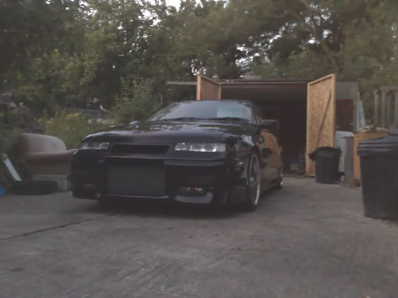

Fitted the bumpers this evening and even went on my first drive.....out of the garage
. Brakes are a little unexistant so will need to bleed them again before going for a spin.
