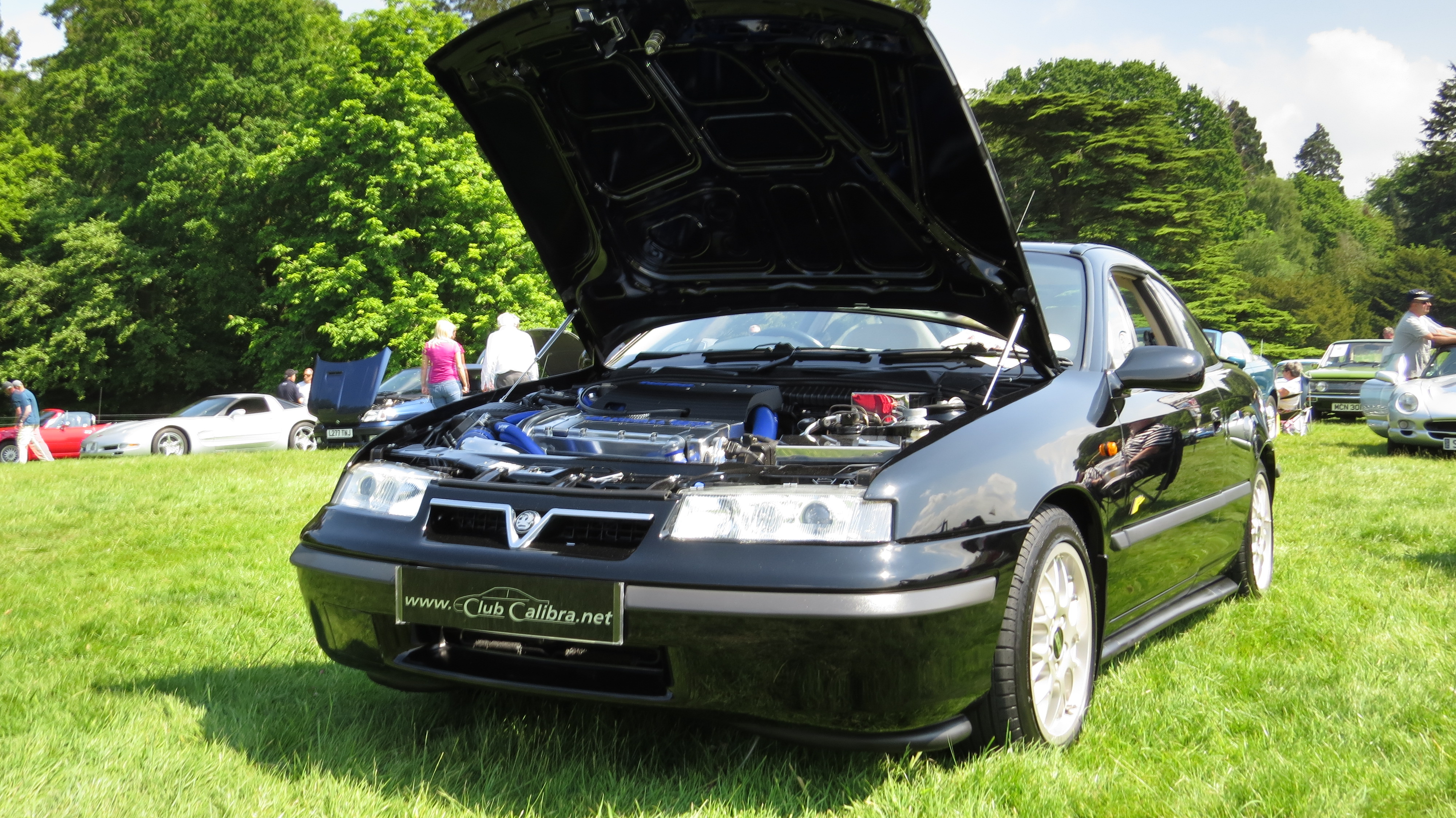

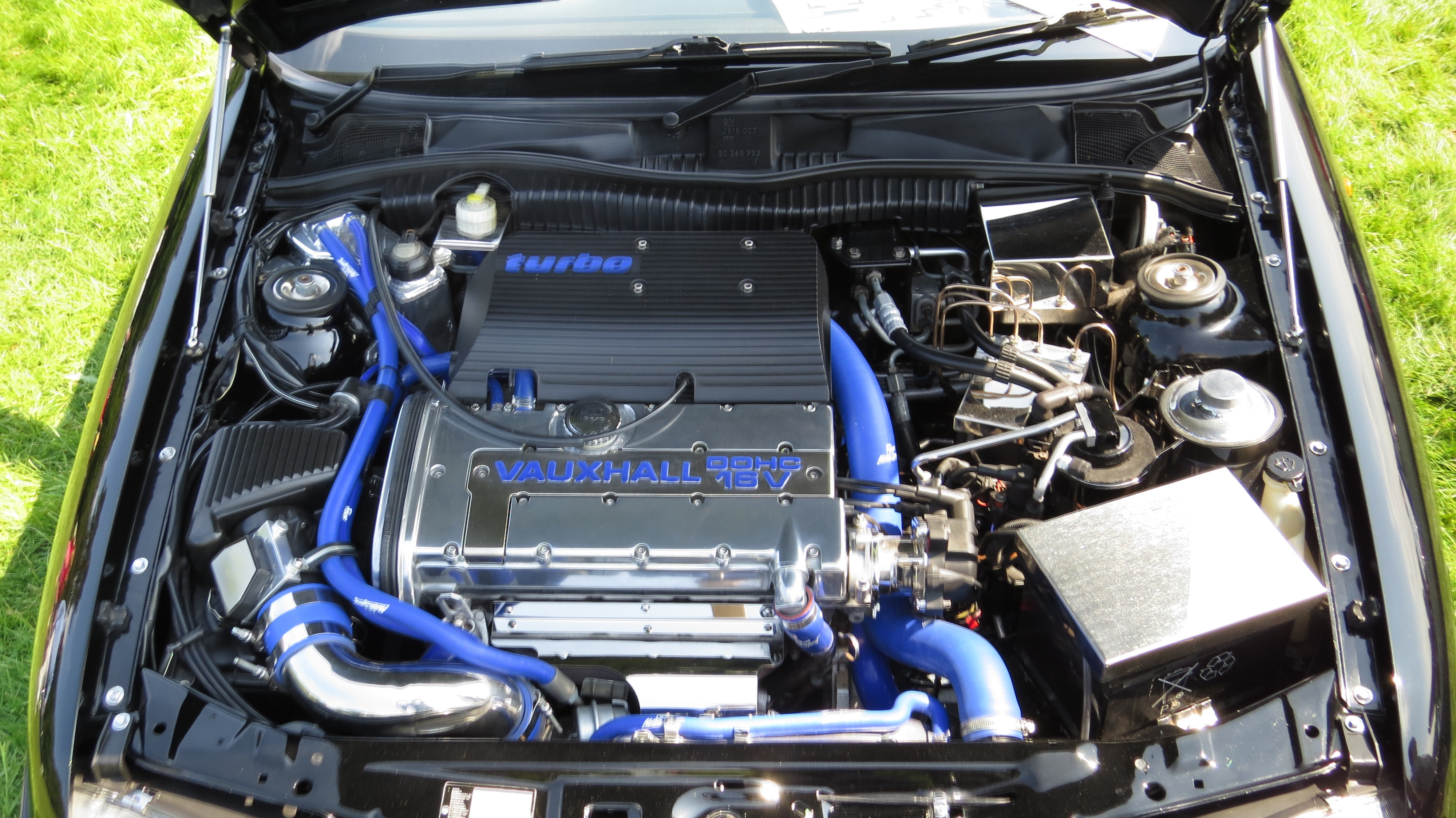

not up dated this for a long time so i thought i would have a play about and ad a couple of resent images

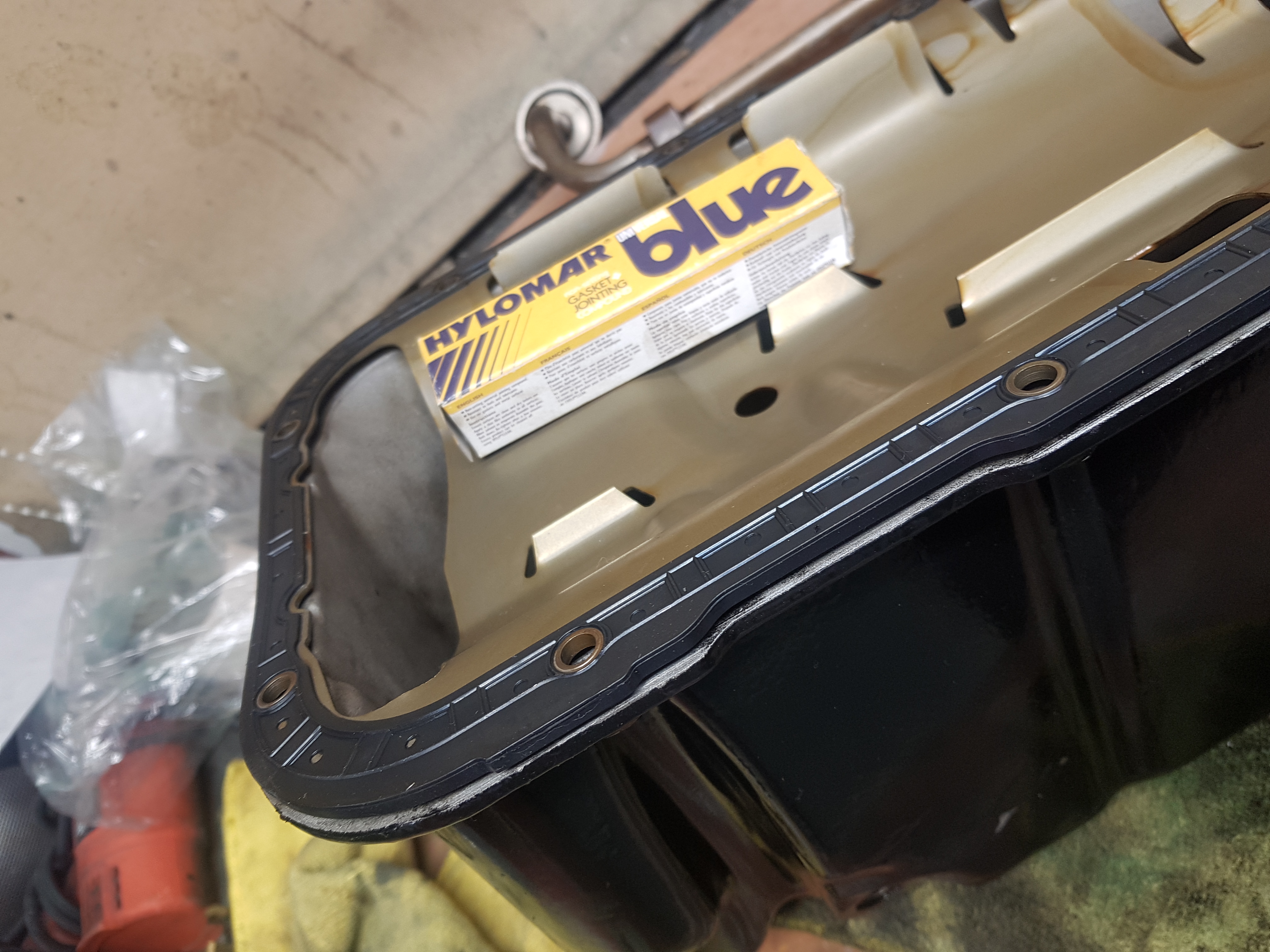

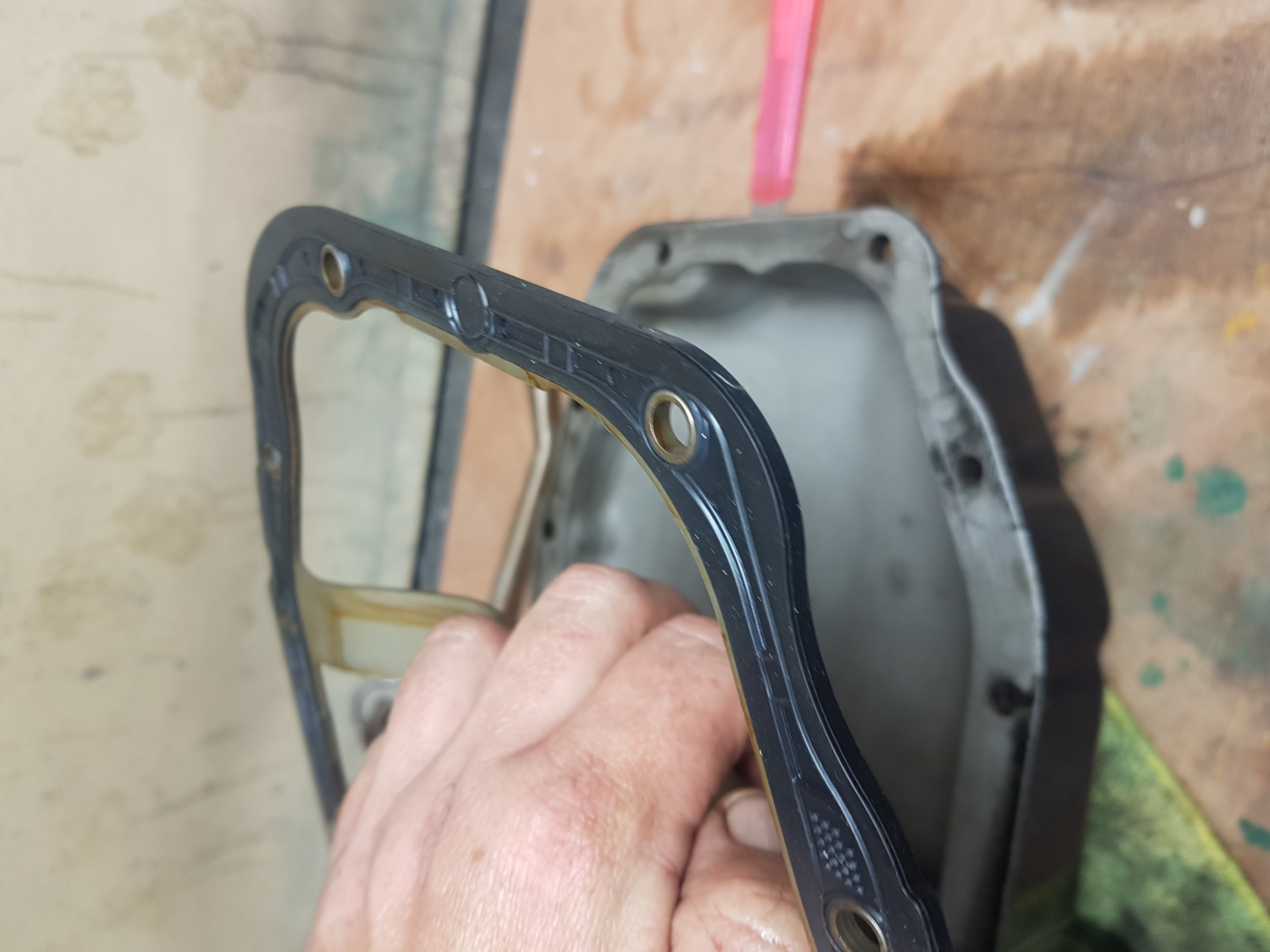

thought i best up date this as most know i have been concentrating on the green car for the last year so not much has happened to the old girl.
She had a bit of a leak on the sump from the old cork gasket so desided to upgrade the old baffle plate to the 8v one this i am told sorts the leaking issue out so last night i stripped the old sump and baffle plate off ready for the new 8v one to go on
Re: my new calibra le update feb 2016
They can and Will still leak, but using the hylomar will 99% cure it, just once a year check/nip the bolts up.
Callyman wrote:They can and Will still leak, but using the hylomar will 99% cure it, just once a year check/nip the bolts up.
will do just got the down pipe to put back on now then done mate cheers for the advice
