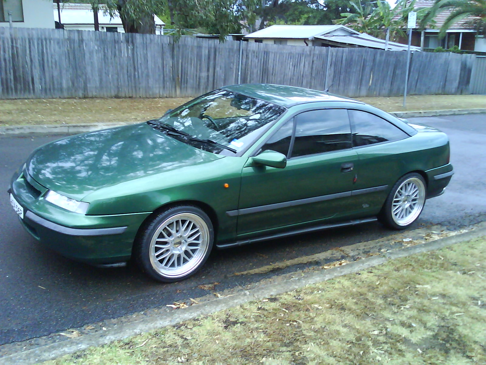

I know what you mean, I like the snow flake design also and went for a similiar design in the 18's.
Below is a picture of the new rims fittted.

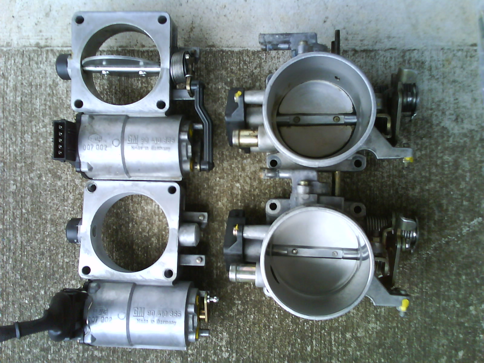

Hi Guys,
I received the reworked throttle body and traction control body just before christmas, the internal diameter of the throttle body was increased from 64mm to 72mm before the butterfly and after the butterfly increased to 68mm to match the traction control internal diameter of 68mm. Also I had the traction control body blanked, as this will soon be made redundant by the a quaife limited slip differential that is to be fitted soon.
Picture below:
Picture below:

If you wish to get this done here are the details.
Throttle Body & Traction Control Modifications.
