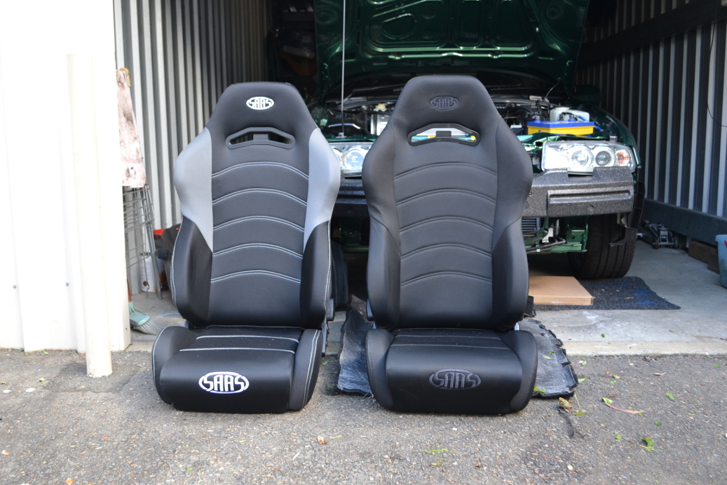

BigDaz wrote:... it wont matter what colour i get will get them re trimmed black/yellow
Ironic. I was all set to get these and then have them re trimmed!

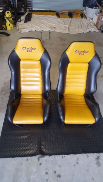

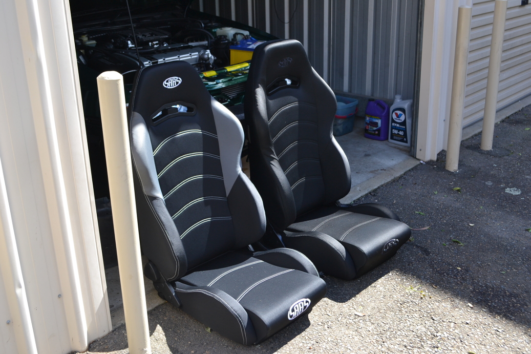

by cal16v » Sat Sep 03, 2016 2:38 am
After blackening out the offending areas...

by Cliff » Sat Sep 03, 2016 8:39 am
Nice job! Tbh, I like them both ways but I think the all black edition will suit the rest of the Cally interior a bit better - unless you want to "grey-up" the back seats!!!

Cliff wrote:Nice job! Tbh, I like them both ways but I think the all black edition will suit the rest of the Cally interior a bit better - unless you want to "grey-up" the back seats!!!
A tip for anyone using fabric paints/dyes for fabric upholstery recolouring...
To avoid 'hardening' the fabric after the colour has dried, first mix a solution of 25% fabric softener, 25% white vinegar and 50% water and mist the fabric until it wets. Apply a light coat of colour and re-mist in between coats until you have sufficient coverage.
There is no need to wet down vinyl or leather.

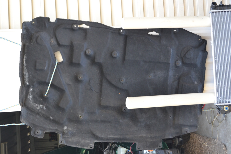

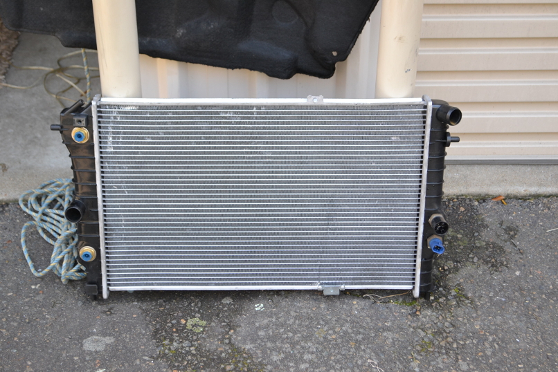

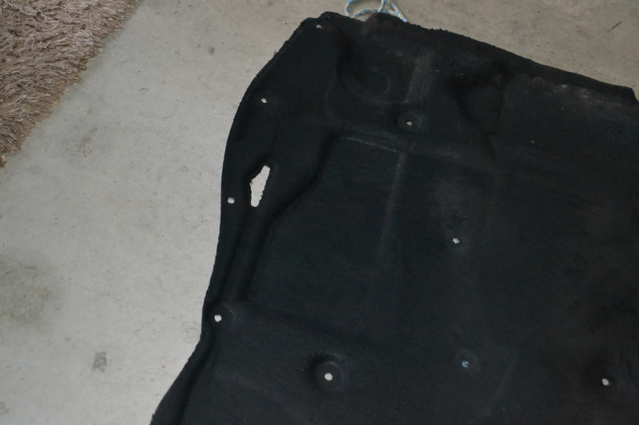

Picked up a near new battery and radiator from a lad parting out a Cali he unfortunately had a front ender in.

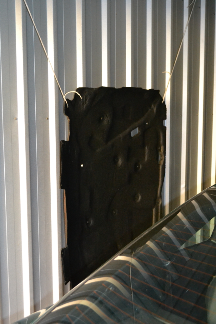

Also the original twin horn unit as I have no clue what happened to mine tbh and the bonnet lining which needs cleaning and a refurb.

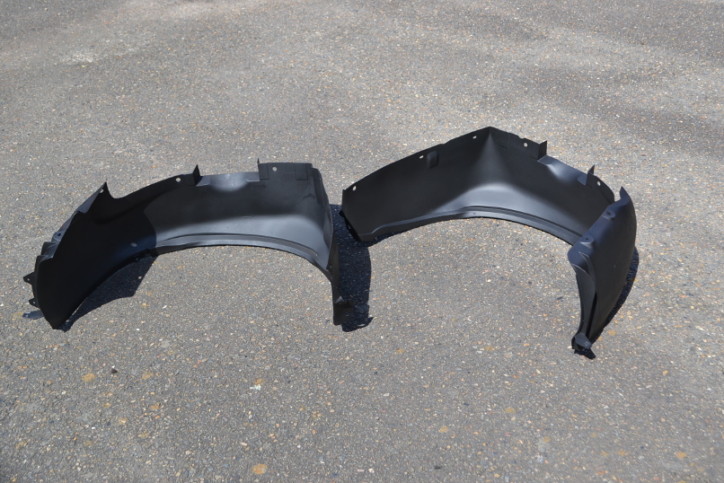

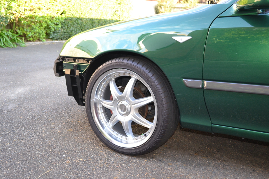

Cleaned up front inner guards
and this filthy piece of s!@t
Nice find...

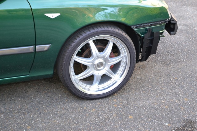

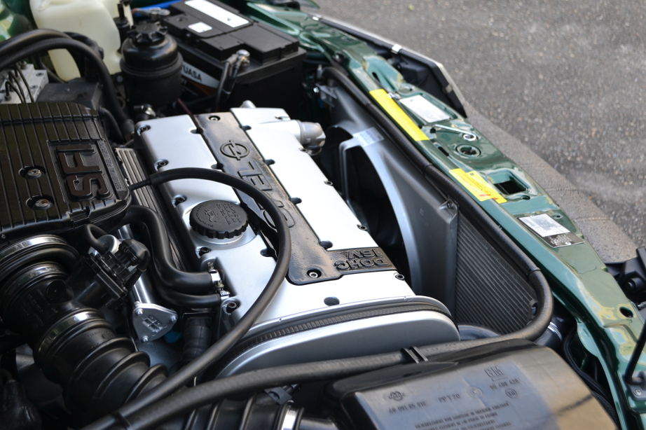

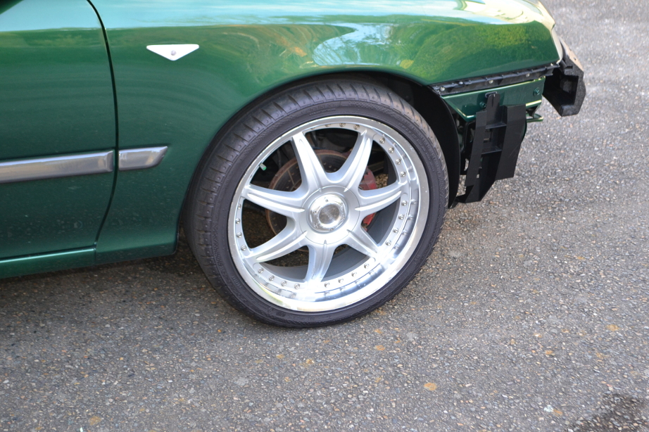

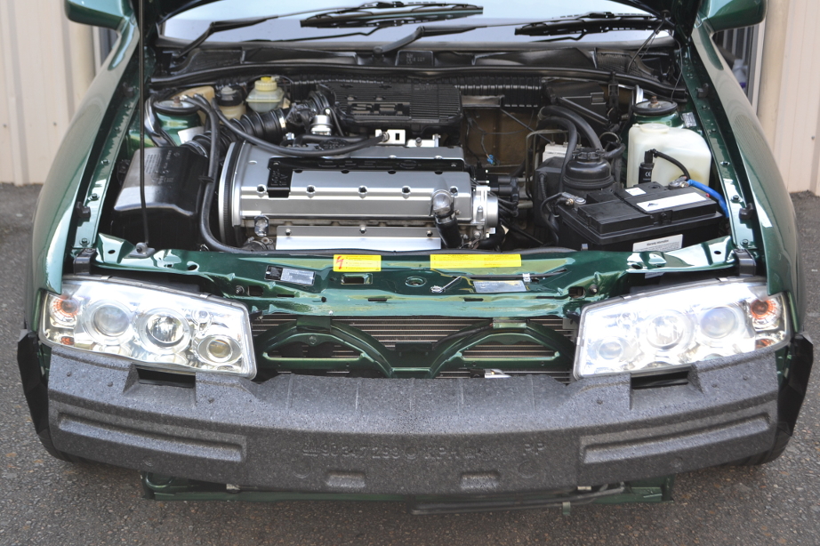

Inner guards are back on and cleaned up the front wheels a little. Wouldn't mind some other opinions on these wheels... never envisaged hanging on to them tbh but perhaps they're growing on me.

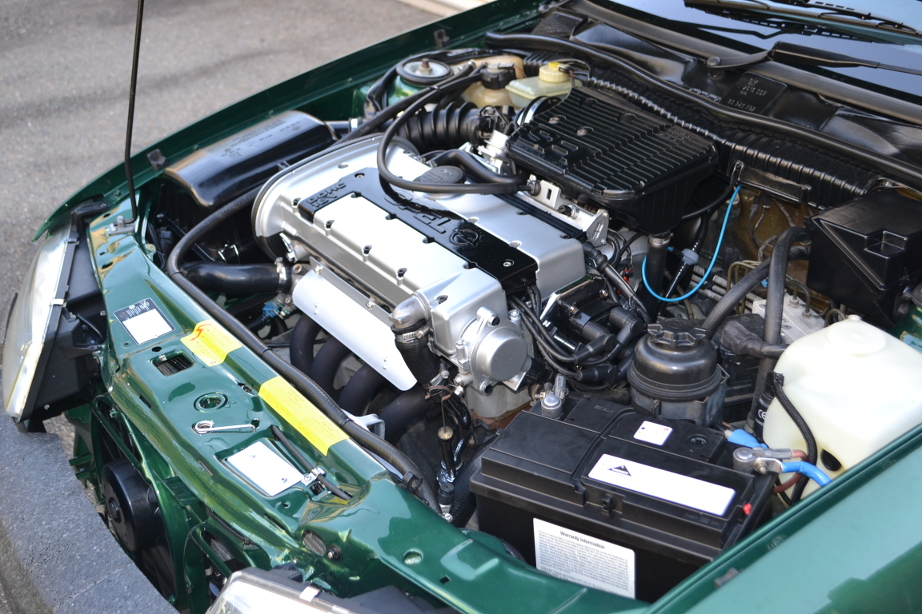

A few more pics of under the bonnet but still so much left to do... looking better without the bright yellow/blue battery :shock:
Started cleaning up the bonnet liner... hope you can see the difference in the small rectangular section I cleaned :lol:

More tidy up...

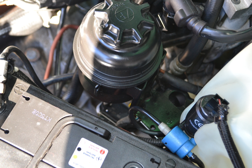

Replaced the P/S reservoir bracket and cleaned up the mess of wires and hoses underneath. Cleaned up the ignition module heatsink and refited with new thermal paste.

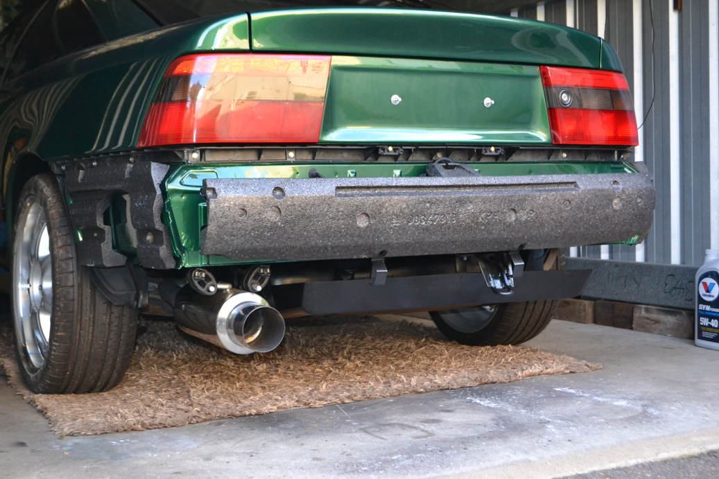

by cal16v » Mon Sep 12, 2016 9:07 am

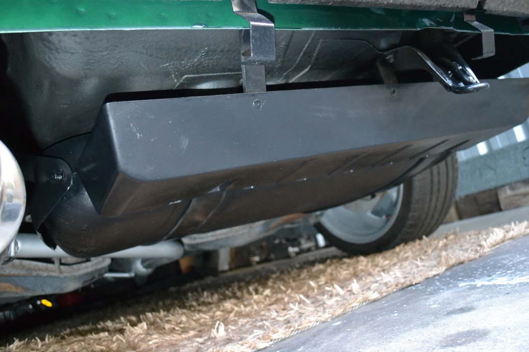

Dropped the fuel tank today and painted the rear underbody with bitumen. Cleaned the inside of the tank and painted the outside in matt black. Metal tank straps painted and rubbers cleaned. All back together and run the hoses through all their proper clips and fitted rear underbody tray. That just leaves the area behind the rear suspension left to coat and is the next job on my list.
