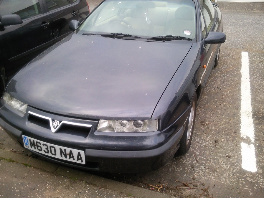

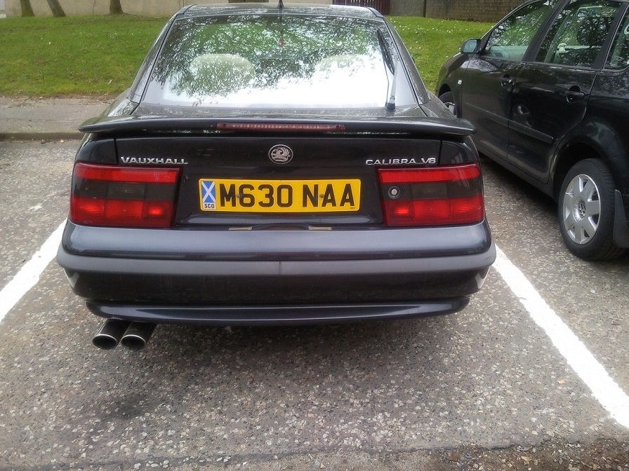

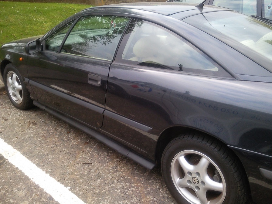

by BigDaz » Sat Jan 23, 2016 11:57 pm
Was looking at some old pictures of my cars and found a couple of my v6 so i thought i would post them up the pictures where taken before it was stored when the water pump went causing terminal damage to the engine maybe get it back on the road one day anyone got a spare 2.5 v6 lump lying around :lol:
