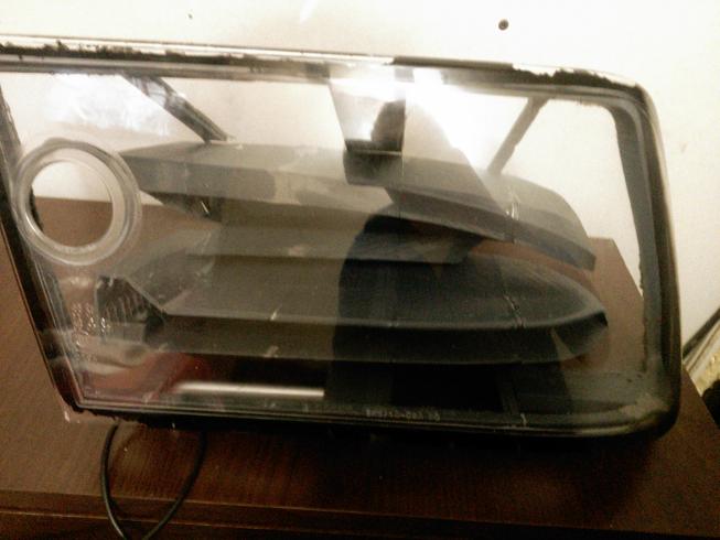

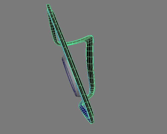

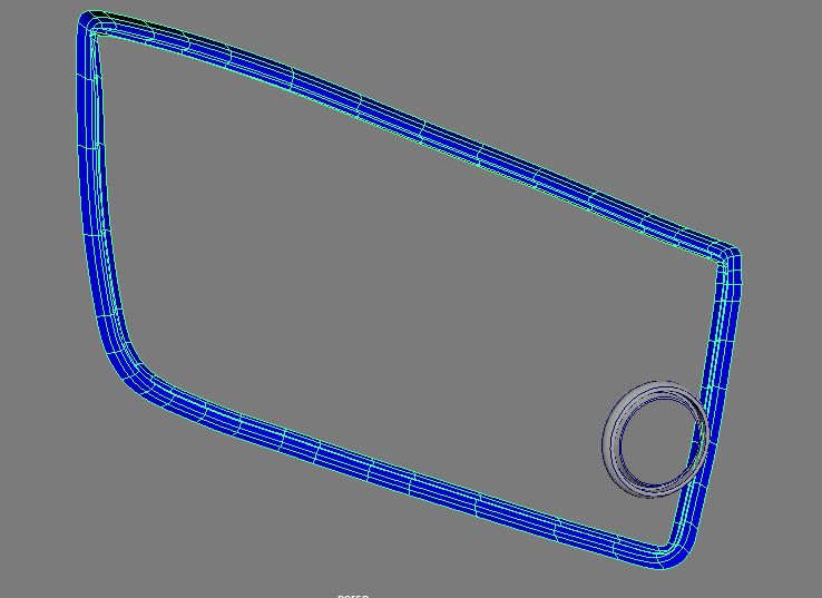

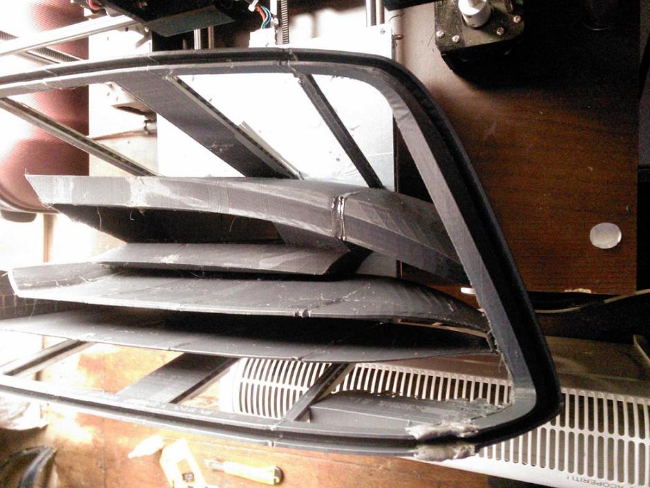

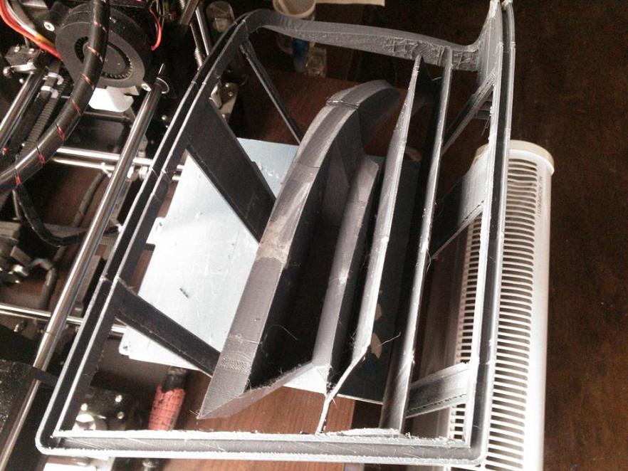

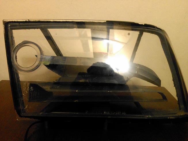

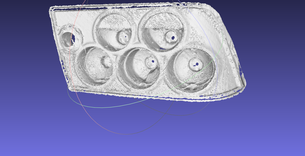

Taillight is now in design process. I have allready the modified version - 2000 -2005 design, but still too classic.
https://www.youtube.com/watch?v=3K4TKChBaNc
Here some pics with base frame.
I've reconstructed the frame reversing engineering over 3D scan immage of an aftermarket item ( I need to paint it in white for better scan results)

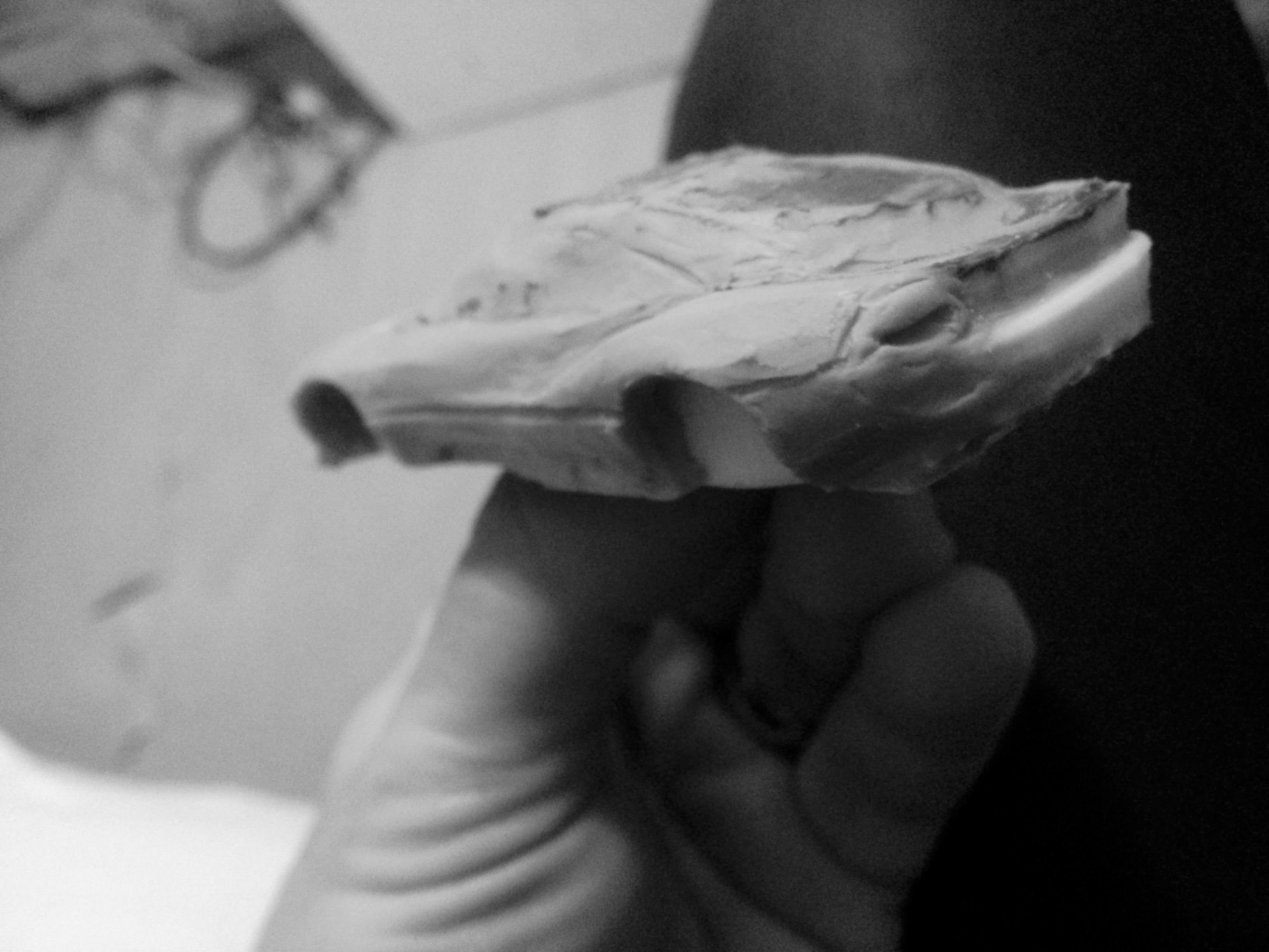

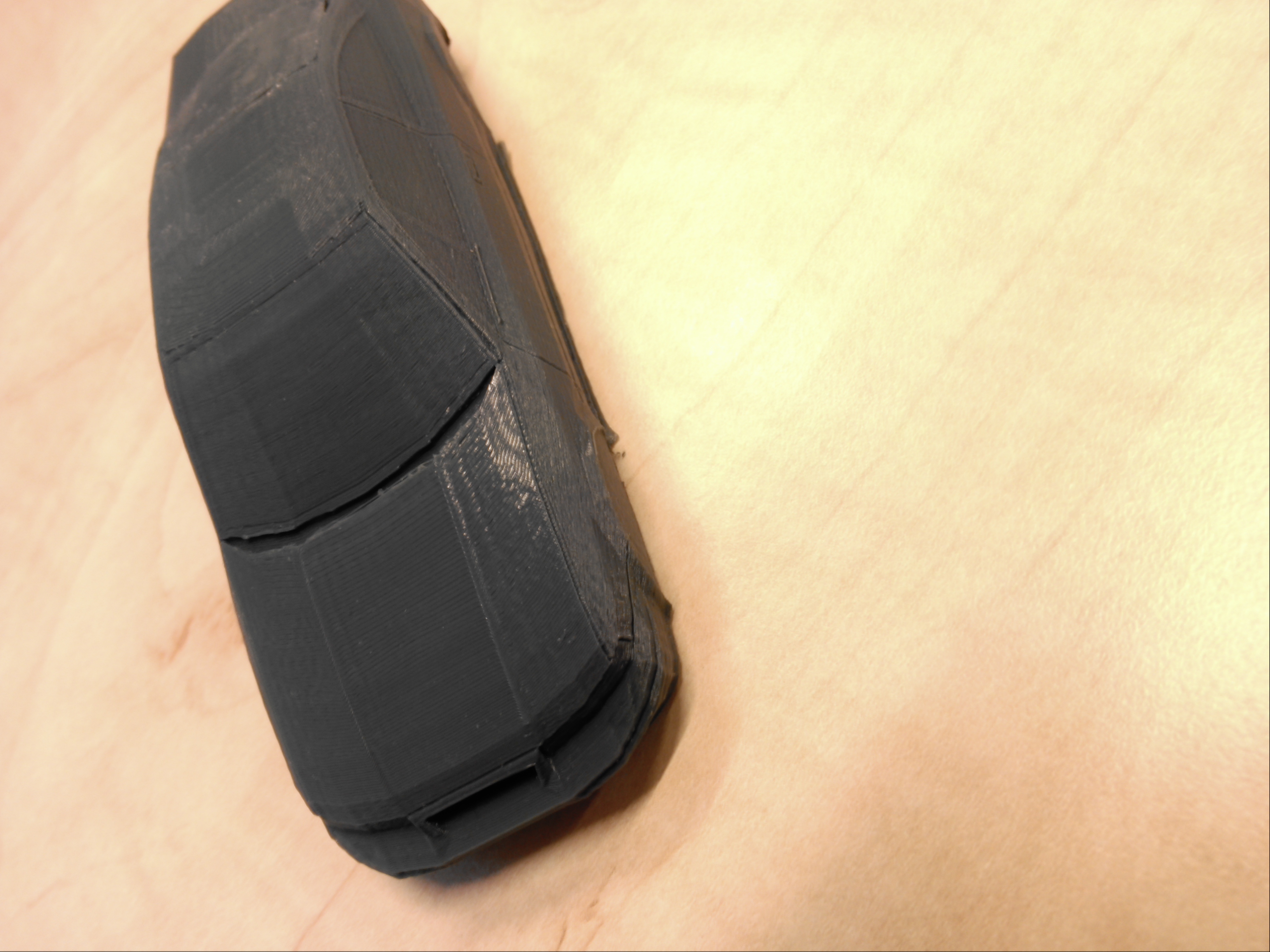

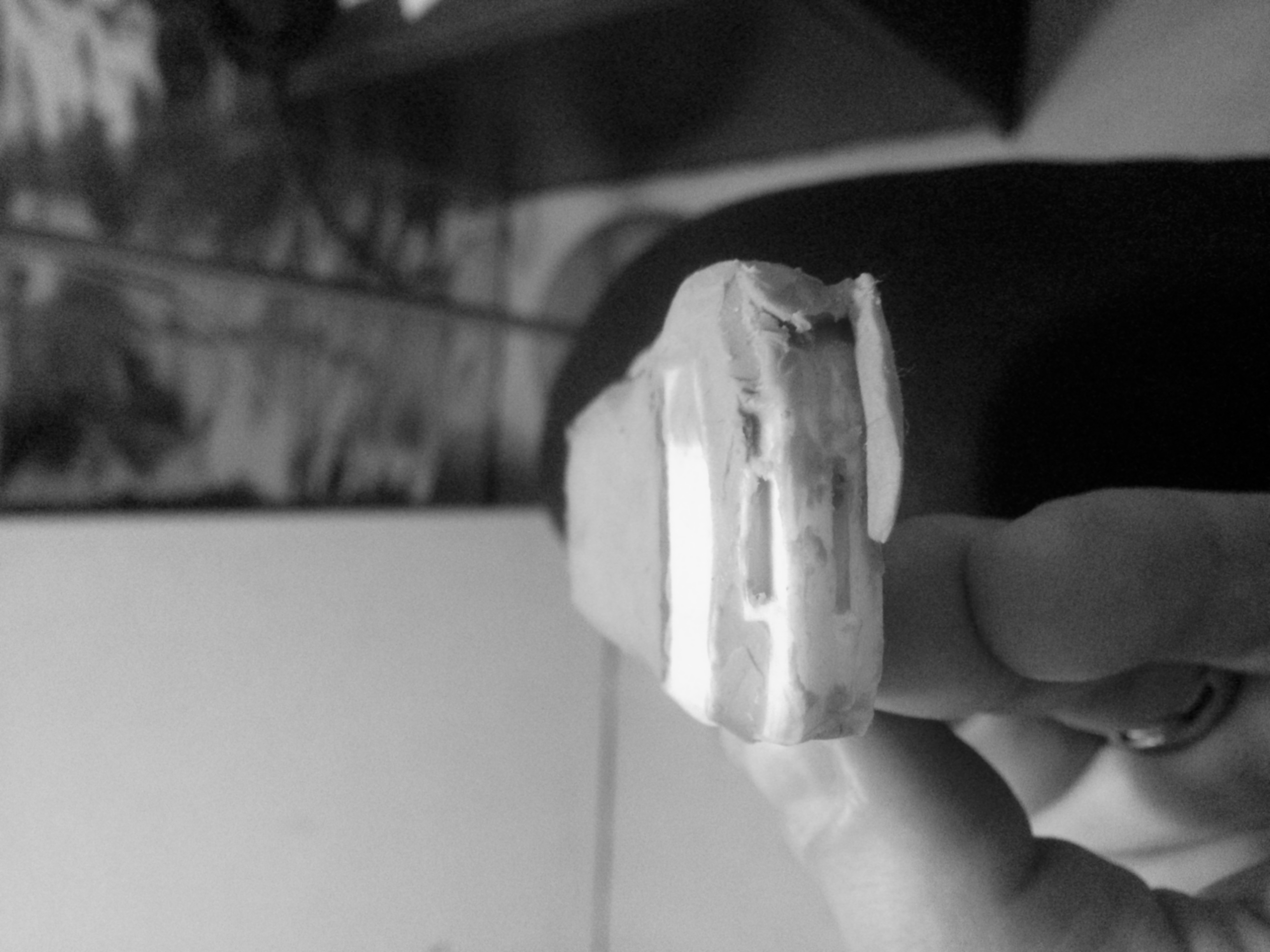

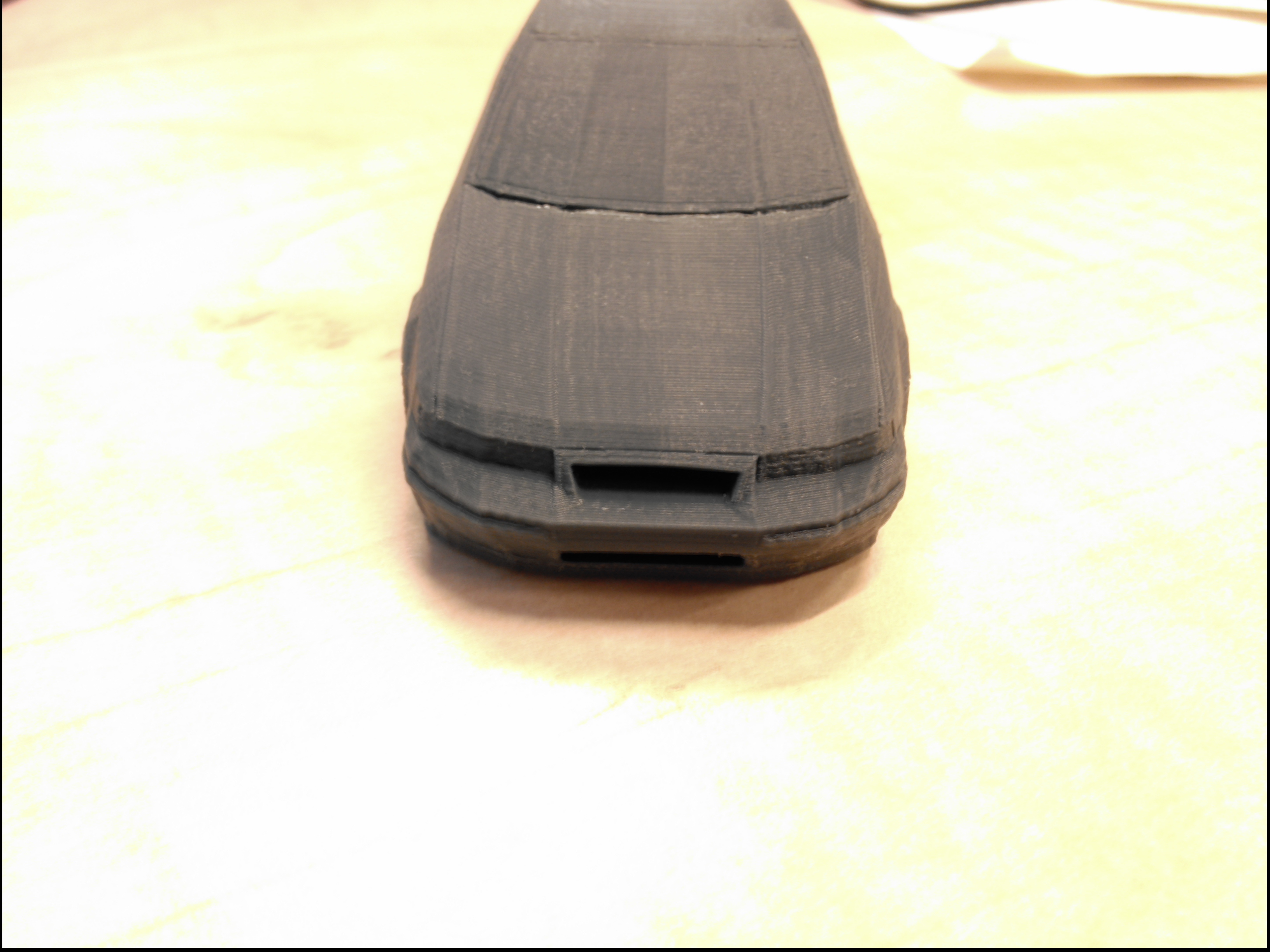

For bodywork, I intend to use Printed model. I just printed 2models . One I filled up with clay - just a test - model too small , so I just printed a bigger one.
I want to test the finall aerodynamics in a smoke tunnel.
The aim of wide body is not for the wheels, Is for compensating the effect which I was telling in the opening of topic : "Car is getting smaller and smaller"
So wide should harmonize with the rest of the car, but to keep somehow the same shape :
- drop look -wider in front thicker in rear
- narrow doors effect - given by middle plastic dent protectors
- wheel arches embedded in bodywork - not like additional wider arches
- taillights and headlights with same external shape

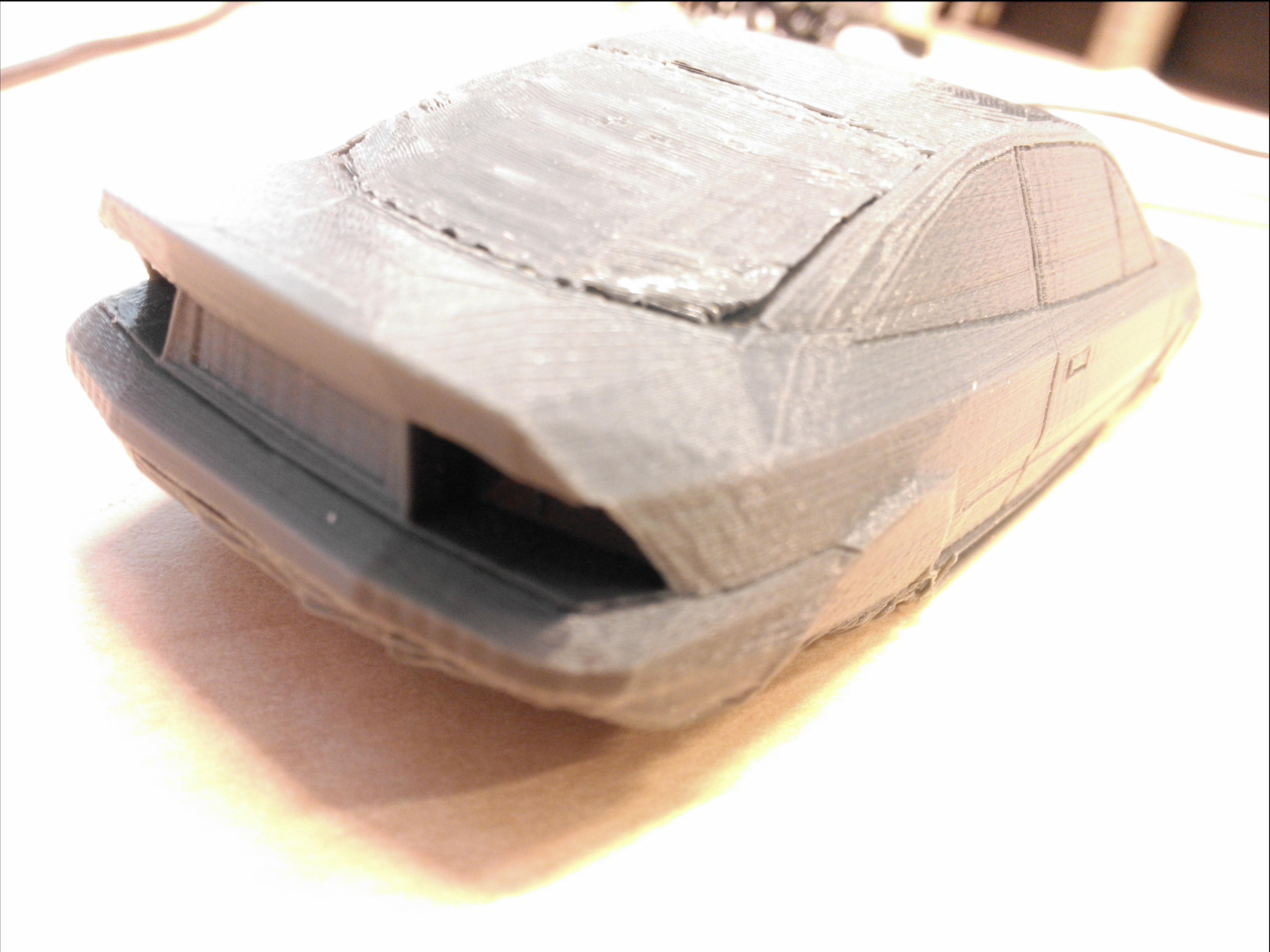

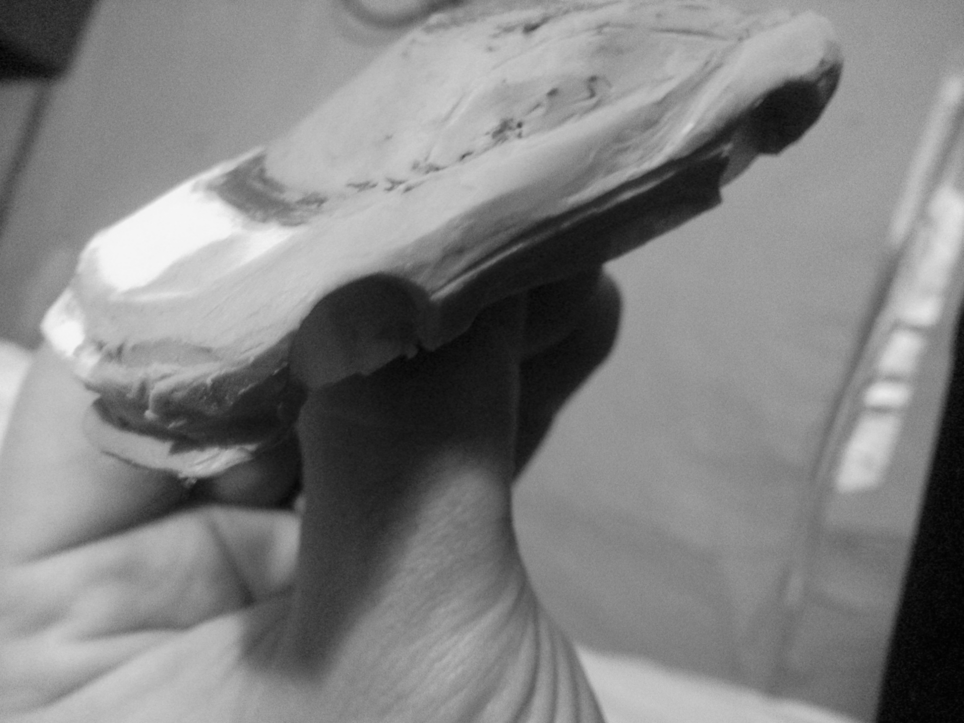

the draft clay design, adds 250mm offset to OEM body
You are welcome to post any design that you love and you think is suitable for the bodyshell.
Since the Cali was so popular in it's glory days, now-days, design should be choosen with care in the way as many as possible to love the new design.
In case you want 3D models to play on your own with clay, just let me know.

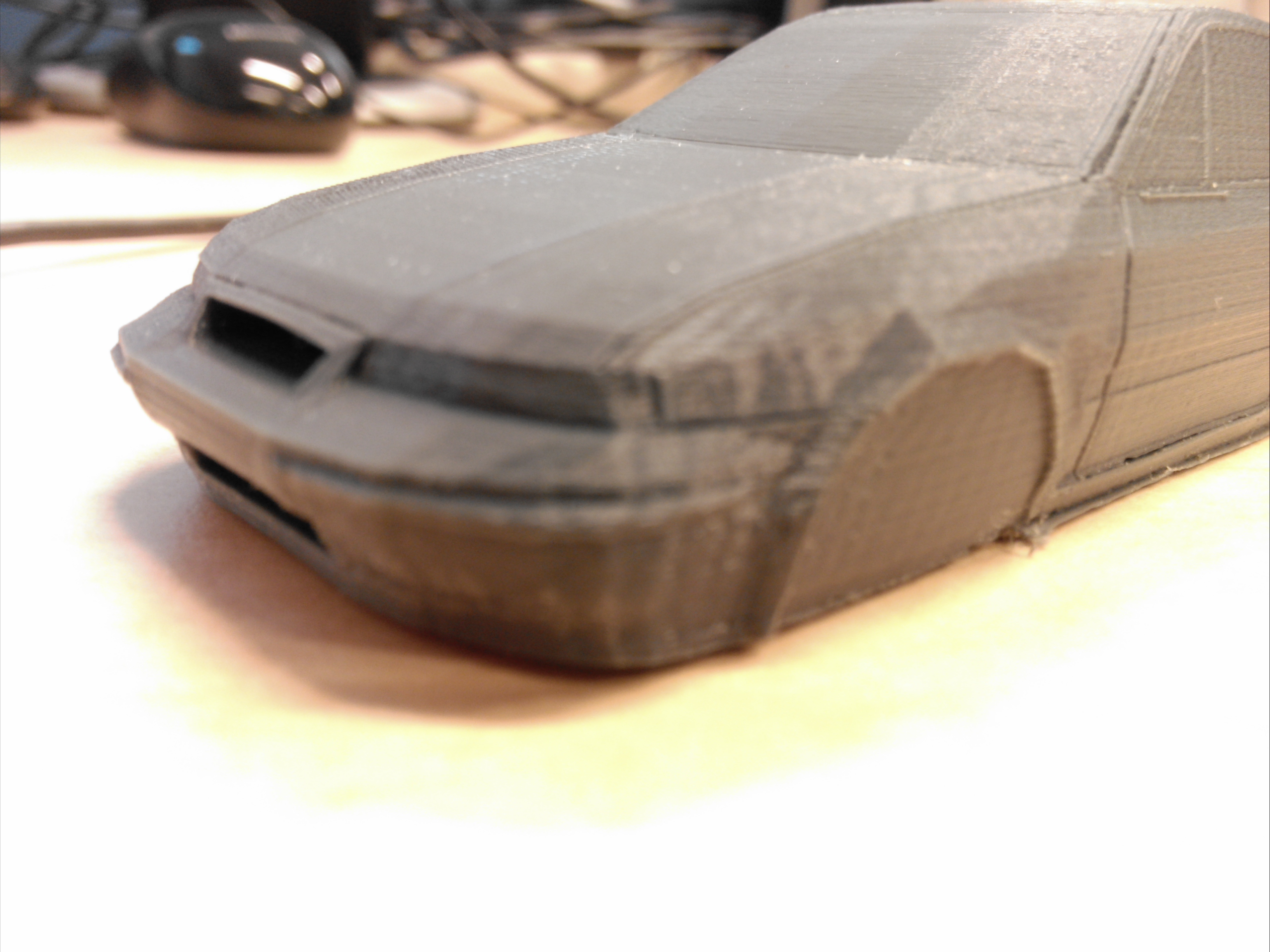

Yep, I will print out with 3D extruder (as model pictured here) the proto 0. But this is suitable for small to medium size parts. Taillight /HEadlight are mid size.
Meaning the first real part used to check dimensions, water tightness , light centering etc.
For big body parts, I will 3D scan the small model, then I will mill in XPS using a 3 axis router. -I would be lovely with a 6 axis, but not sure I will have any access to such CNC soon

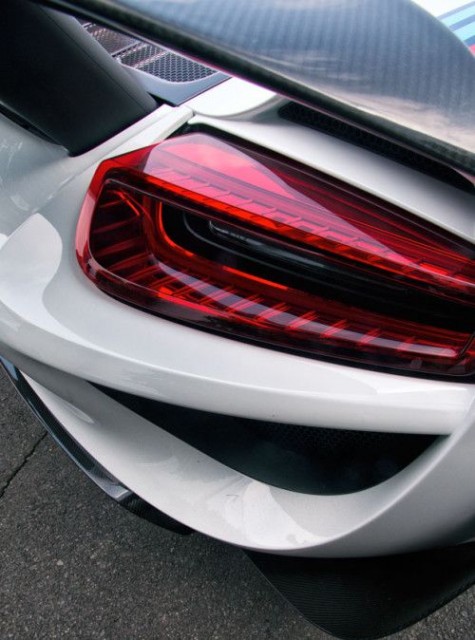

this is how the taillight I intend to design ..close to this one , keeping the Calibra outer shape

Currently I just got Proto-0 out for proportions check-up

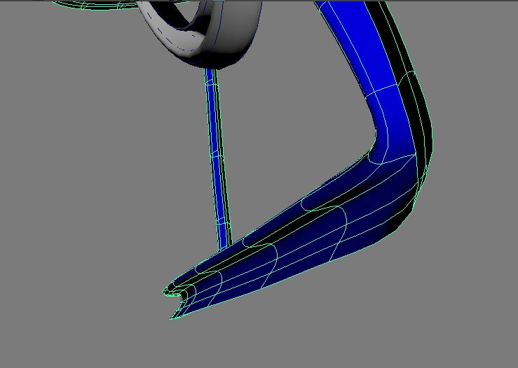

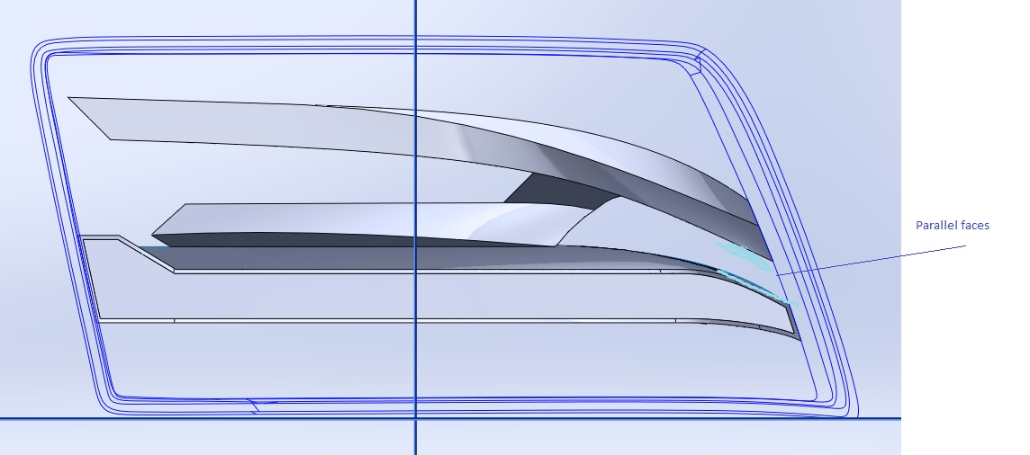

I tried to embed the Body lines, and I will keep red up/down and white in the middle.
Also I did a muffler tips and thank under-body aerodynamics deflector design to follow the same lines as the taillights.
