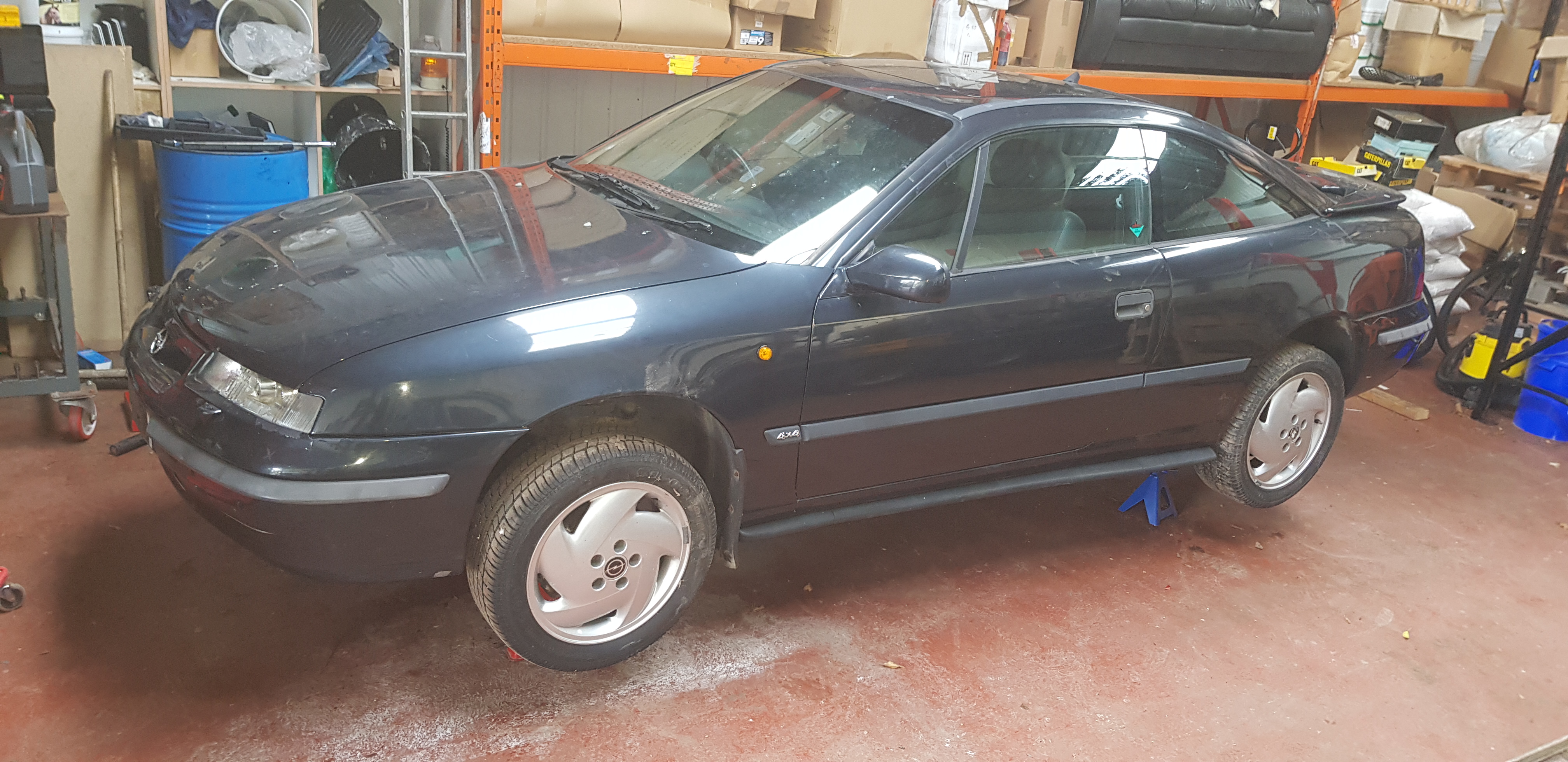

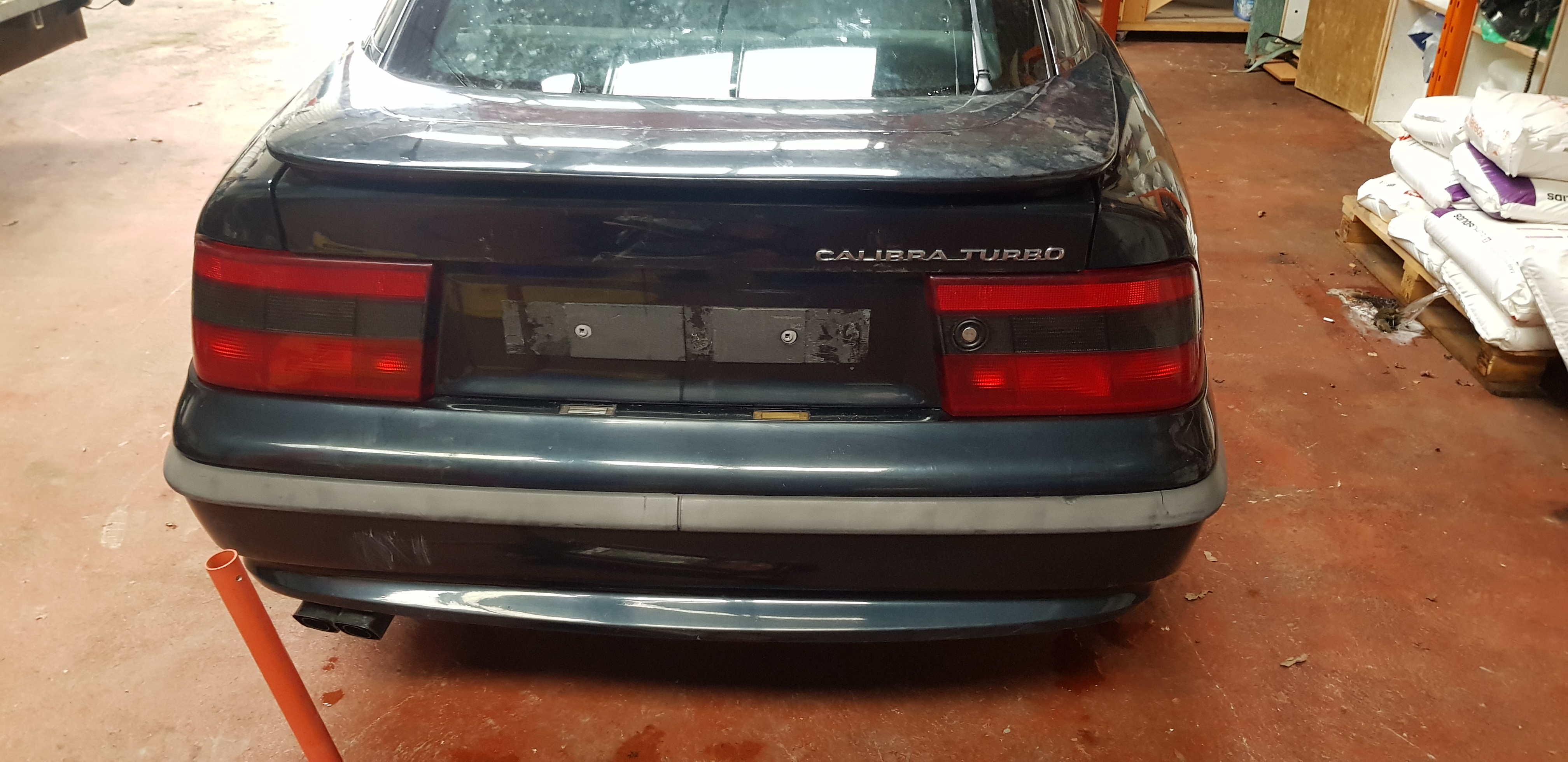

Well after being in storage for 19 years ive decided to resurrect this old girl , Its an itch ive had for a while now and now is the time to give it a good scratch , I intend to recommission fully and will finish it off with a full respray . Structurally and chassis it is very sound , no rust at all , only a little surface rust under neath, nothing a wire brush and coating wont sort out , I want to keep it as standard as possible , maybe spray the wheels and gunmetal gray and add a very suttle front lip as the standard bumper always looked as if its missing something ( suggestions welcome please on this one, no fast and furious stuff !!) All bushes and the likes will need replaced too Id be open to suggestion which be the best route to go with these

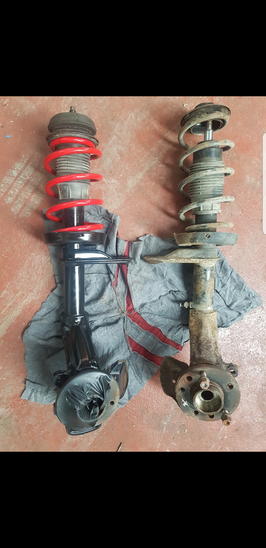

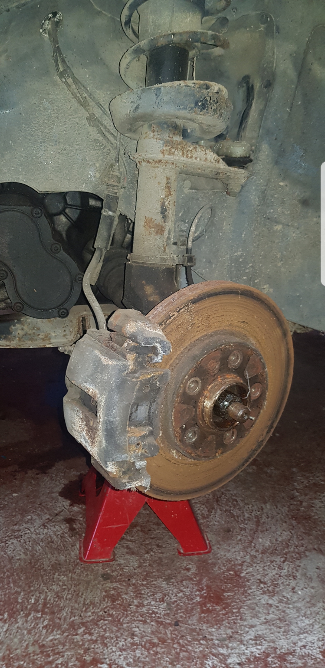

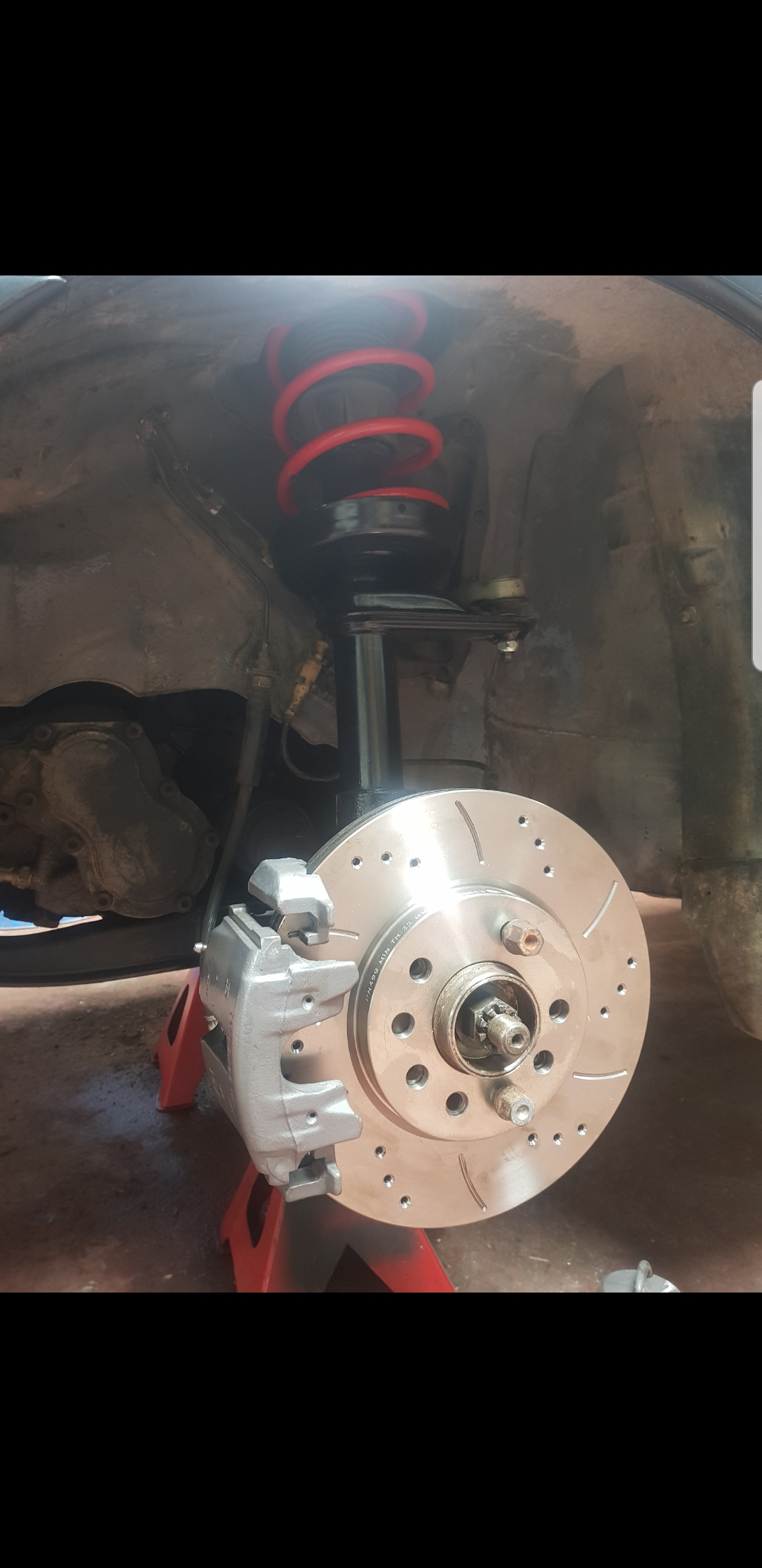

Time for a wee Update
Been tipping away since I first posted
Front wishbones and bushes all swapped out
Front struts cleaned , painted and new billy inserts
Front subframe dropped , cleaned and painted
Front calipers referbed and painted
New discs front and back & pads
