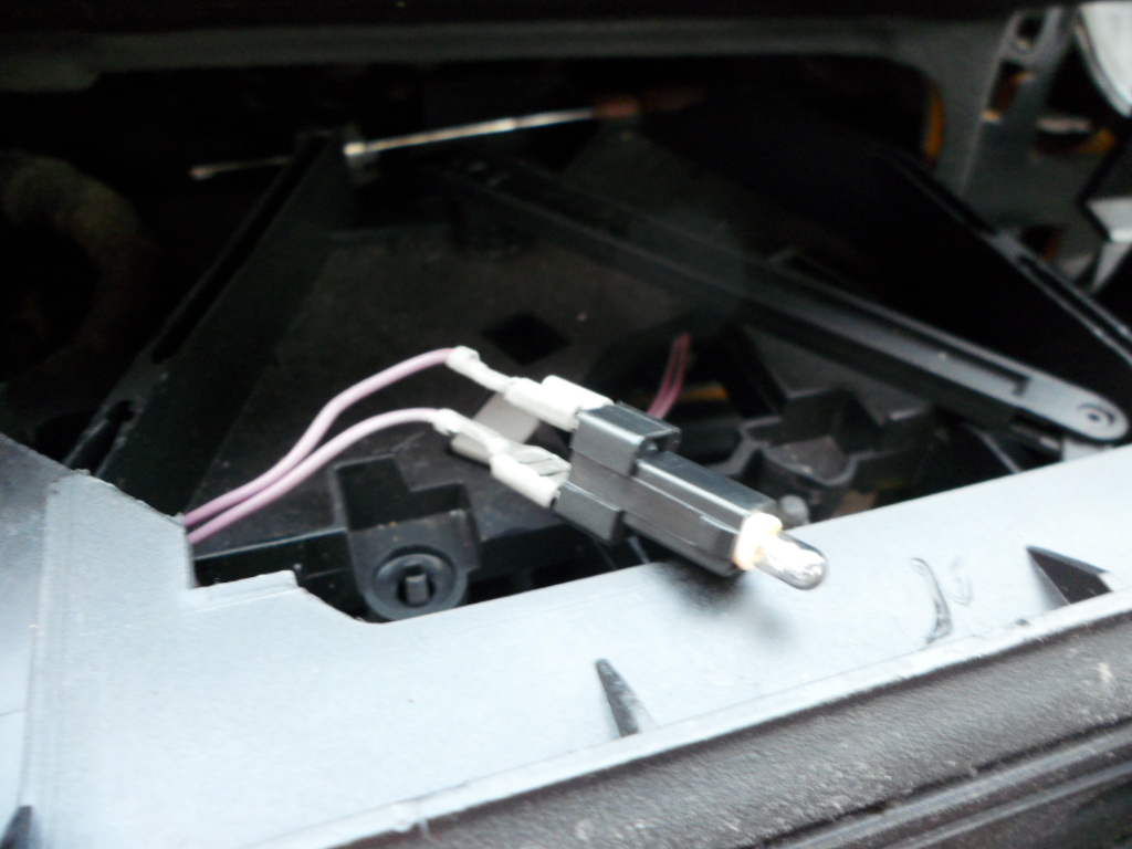

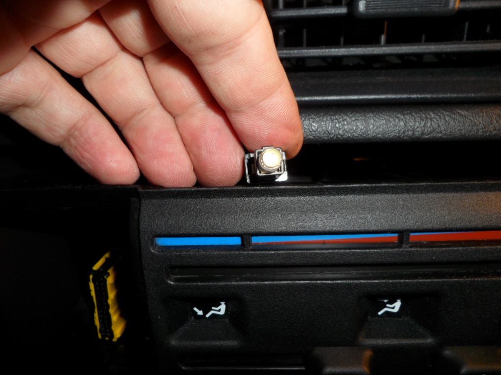

by EddeyDancer » Tue Nov 06, 2012 2:53 pm
I also fitted an LED Bulb in the 'Heater Control Panel' recently...
It's NOT as difficult a job, as I was expecting it to be...
So anyway, here's some more photo's of this Job...
