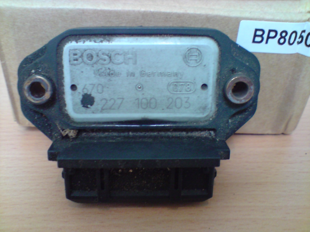

Ok, had a look in the area of the battery and just can't see what is supposed to be the amplifier. Can someone please provide some direct guidance, description of the amp and if possible a photo of the amp either in situ or out so i can at least see what I'm looking for?

Ive been told that you can locate it underneath the battery tray.

by sinbrad » Thu Aug 14, 2008 7:40 pm
Actually underneath? How are you to get at it? What does it look like?

by Fraz » Thu Aug 14, 2008 10:17 pm
couple of pics here...about half way down, post by Cornishtaz
http://www.clubcalibra.net/viewtopic.ph ... eb8b93489b
by sinbrad » Fri Aug 15, 2008 10:26 am
Cheers for that Fraz. Went out hunting after I posted my last post and whipped this out as it was the only thing that I could see?? Lo and behold it matches. Now to get hold of another one to see if it's the problem causer?

Just checked EPC and it appears that the Vectra doesn't have the amplifier,as it's the X25XE and possible different management system, still worth a trip as the Cav v6 will be the same

you might just have to get an aftermarket one (non Bosch) intermotor should do one ..or try a local Auto electrician, they should source one
oh and its also used on
Alfa 164 3.0 V6...
FERRARI 456 GT 2+2 2,5...
Volvo-960,S90... 3.0,125-150KW
