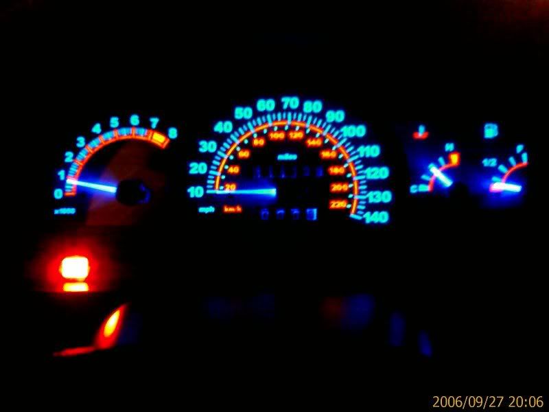

by noelboy » Wed Sep 27, 2006 3:12 pm
Put them in at lunchtime but they don't show up at all during the day.
I'll get some pics tonight and put them up
noelboy

by noelboy » Thu Sep 28, 2006 8:10 am
Your dials look slightly different to mine?
Here's mine:
noelboy
by MJ » Thu Sep 28, 2006 10:41 am
I like them much better [img]/smile.gif[/img]
p.s. you need petrol lol
MJ
by noelboy » Thu Sep 28, 2006 1:48 pm
lol yea, pretty much where the needle always is!
