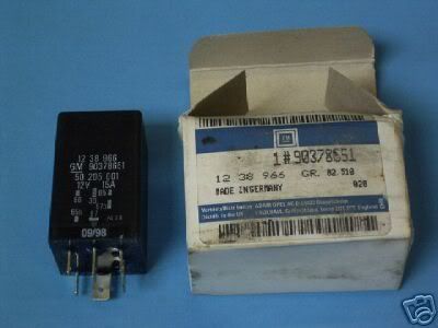

by RobbieV » Mon May 14, 2007 10:09 pm
Here's a pic, as you can see it's a plug and play thingy [img]/smile.gif[/img]

by Stupink » Tue May 15, 2007 9:06 pm
I think they're all the same part number. so take it off the box in pic above [img]/smile.gif[/img]

by hormonedmonkey » Tue May 15, 2007 9:19 pm
90378 ???? 51
hormonedmonkey
by RobbieV » Tue May 15, 2007 9:24 pm
90378651 fit's all calibra's [img]/smile.gif[/img]
