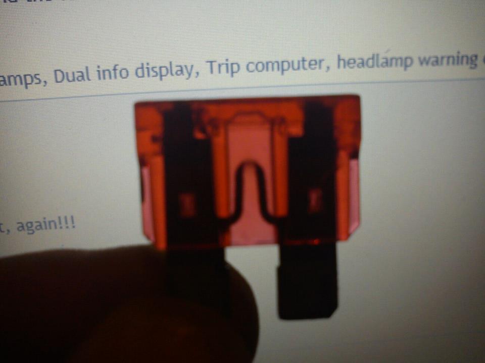

Re: Limp Mode caused By Interior Light Bulb
Fraz wrote:just checked mine and the fuse that takes the bug eyes out is fuse No. 22
22. 10A - Reverse lamps, Dual info display, Trip computer, headlamp warning device
YAY!!!
Turns out Fraz was correct yet again!!!
I knew I should have pulled all of the Fuses out, and inspected them with a Micro Scope...
Thanks to all those who contributed...
Much Appeciated
Fuse No. 22 put my car in Limp Mode... Who needs an immobiliser???
