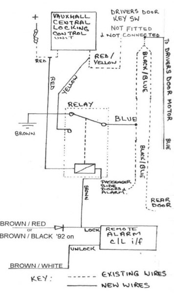

As for fitting, following the instructions above, hopefully the diagram inlined helps (not mine so I can't take credit but I did use it when fitting mine) you to understand how to wire one in. The only thing I would do differently is pop the footwell cover off in the driver's footwell rather than the door card since that's where the central locking ECU is. You can find the wiring colours in the diagram but check that you have the right ones by testing for a 0v (earth) pulse on the wires. Of course if you go for the deadlock & alarm solution below you'll need to do both.
And if you want to do a complete job and make the remote locking set your alarm and enable the deadlocks - here's the added parts needed to make it deal with the deadlocking and alarm.
I can't take credit for these instructions either, I assembled them including the diagram from a variety of sources.
You will need:
- a single pole 12v relay (SPDT) like this one - the current rating is way above what's needed btw, but it has simple spade connections: http://www.maplin.co.uk/p/12v-30a-dc-sp ... elay-n00aw
- a diode (the thing shaped -->|-- in the diagram attached) like this one: http://www.maplin.co.uk/p/1n4001s-1a-si ... fier-ql73q
- an additional passenger side central locking motor (you need to swap the driver's door motor which has mech deadlock for a passenger side one which is electrical)
Basic instructions:
- Remove the drivers door trim, the drivers side sill trim and the cover trim at the side of the throttle pedal.
- Remove the drivers central locking motor (you will need to remove the handle and whole lock mechanism)
- Disconnect the wires (at the bottom of the door - round plugs) to the two mirco switches which fit on the handle.
- THE WIRES TO THE 3 WIRE MICRO SWITCH MUST BE DISCONNECTED. DON'T JUST PULL THE SWITCH OFF AND LEAVE IT DANGLING IN THE DOOR.
- Fit the new motor to the bracket, ensuring it is as high as possible. When the mechanism is in the locked position, the motor plunger must be fully in.
- Fit a new terminal into the motor plug. This is a standard pcb edge connector, fitted to many fords, eg. to the old ford rectangular mirror switches.
- Connect this new terminal to black/blue wire at the round plug where the mircoswitch used to plug in.
- Re fit mechanism.
- Locate the central locking control unit in the drivers footwell. The new relay should be fitted close by.
- Follow the wiring loom that comes out of the drivers door and along the sill.
- As is starts to run along the sill to the rear of the car, remove the outer tape, and locate the 2 black/blue wires.
- Connect a new wire to one of these and then to the relay as shown on the diagram attached.
- Wire up as shown and fit the diode with the silver/black band side connected to the alarm. The silver line on the body of the diode represents the | in the ->|- in the diagram.
If you don't understand the wiring diagram, let me know and I can explain. This job takes about 1.5 hours - solder all connections and shrink wrap them or tape them (very well) for the best possible outcome.

That's just to show that you'll need to run new wires between the central locking unit and the existing wires as far as I know - you should be connecting the lock and unlock from the new unit to the loom connected to the standard locking ECU. You will also be able to pickup 12v and Earth from there too. I mounted my unit just outside the area of the kick panel, higher up so it is out of the footwell and won't be booted. I extended the aerial wire along and zip tied it to existing objects. Does that make sense?
