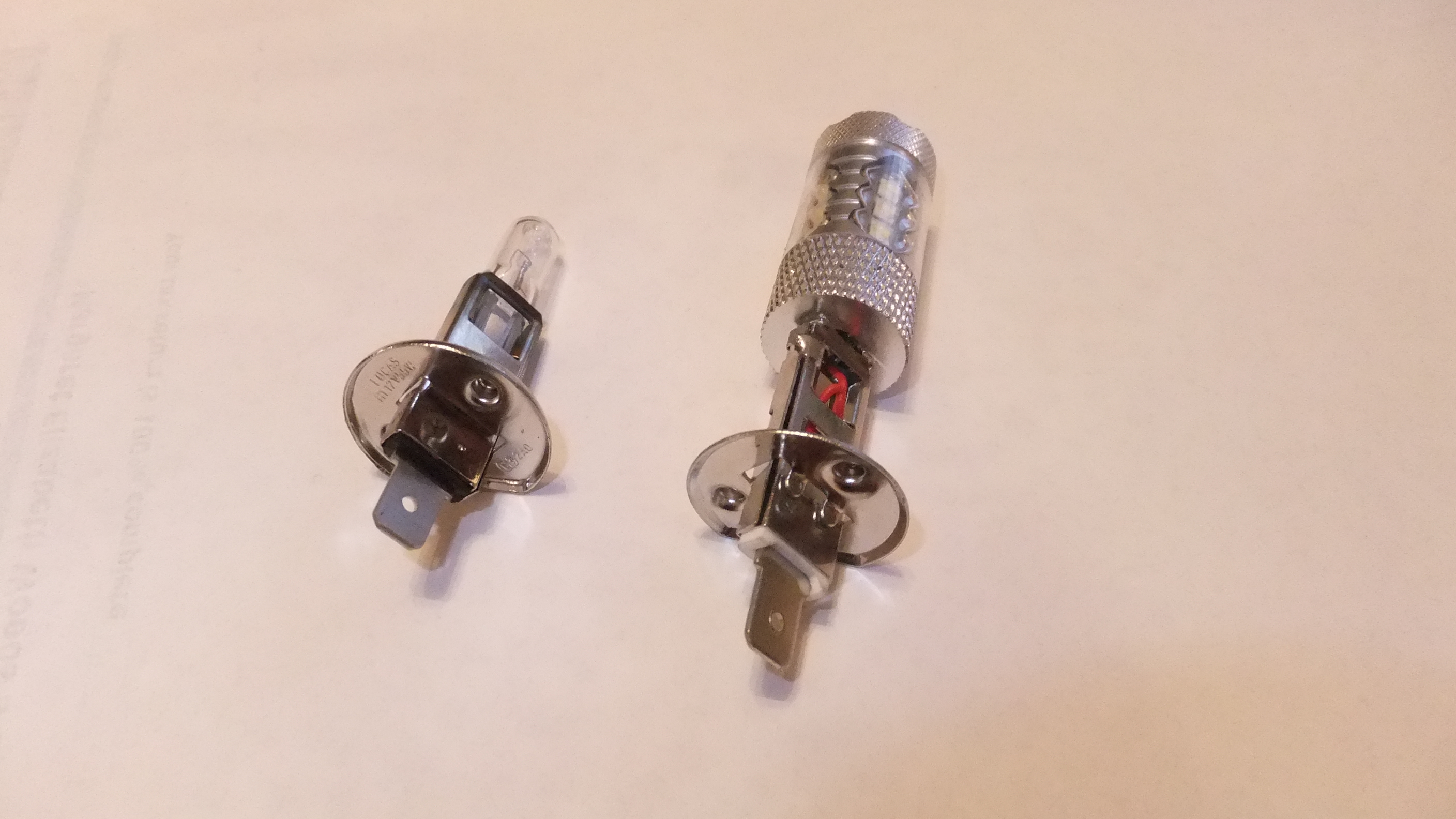

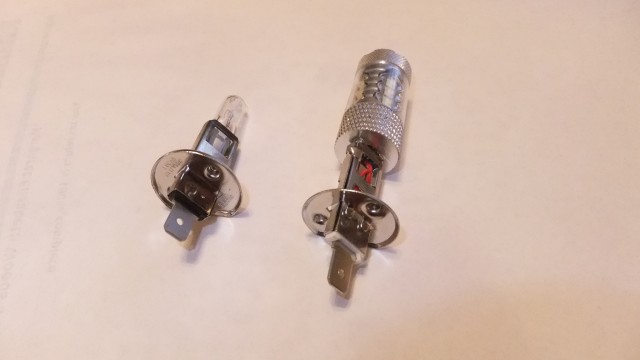

What a mistake to make!!.
The bulbs finally arrived. Unfortunately they did not fit into the headlight unit. As can be seen from the attached picture, the rear connector matches the H1 bulb but the head containing the LED's is much wider and will not fit into the headlight reflector. In hindsight when I viewed the website picture of the bulb I should have noticed the difference but it raises a question, are all H1 headlight fittings the same as on the Calibra, consisting of a narrow slit just big enough for the bulb to fit through. If that is case then the bulbs cannot be described as H1 replacements. I would be interested to hear your view on this issue. One the "bright side" I connected the LED bulb to a 12v supply and it was much brighter than the standard bulb fitted to the car. However the bulbs fitted to the car are the standard filament type which would explain why the headlights are so poor. I am not sure if I will continue my search for a suitable LED bulb, I will be more careful this time. One alternative would be HID's for the dipped beam and halogen for the main beam, is that a good combination?
Regards

Ouch, those things are huge!! I would be asking for a refund, I agree that they can't be called a H1 replacement - the dimensions are wildly off. A quick search on the internet shows that there are other options, some appear smaller - though whether they are or not is quite something else.
I never gave your post a thought regarding this but I had a couple of wedge type LEDs that should replace the sidelights but they don't fit either since the hole for the sidelight is literally slightly larger than the bulb yet of course the LED replacement is not slight...

Hi
Having looked at some more LED bulbs that claim to be suitable H1applications, I my not so sure, they all look bigger than will fit into the H1 fitting on the Calibra. I did fit HID's to my old Calibra and they worked well. The reason I was interested in LEDs was the possibility that they were a direct plug in replacement without the need drill holes into the plastic rear covers of the headlight fitting. But I guess that's not too big a job. So do you think that HID's for the dipped beam and halogen bulbs for the main beam is the best solution. Is there another option I could consider. What headlight bulbs are fitted to yourCalibras.
I have Emailed the supplier of the bulbs explaining they will not fit into a H1 fitting, so far I have not had a reply!!
Regards
Regards

Pinner-man wrote:Hi
Regards
Mine had HIDs on the dipped and full when I got it. However they're an MOT failure here in Sweden so before the MOT I removed them and put high bright halogens in. To be honest, I've left them there.... they're not enough of a problem for me.
Re: Headlight Upgrade
I had read on another forum that the Calibra's problem was poor wiring but I don't agree with this at all. My Mk3 Cavalier would have had the same loom & the lights on that were fine. IMO, it is the Calibra's small lenses/reflectors which are the issue.
I looked at LEDs a while back & also found that the cluster itself was too large to fit in the H1 aperture.

I think from the various comments we can say that LED's are not suitable for Calibras headlights. I have sent a Comment to the Website I purchased my LED'S bulb asking for a refund as they are not a H1 replacement - guess what I have not received a reply - I shall keep trying. As far as HID's are concerned on the dipped beam, my old Calibra had no trouble passing the MOT, I always use the same garage for my MOT so perhaps he was just being lenient. There is no doubt in my opinion that HID'S give a better coverage than the standard bulb. I could always fit them but replace the standard bulb for the MOT.
