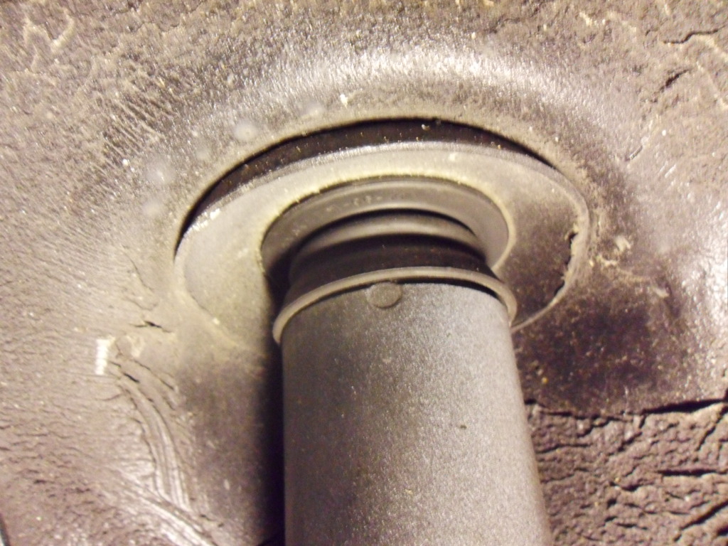

I've been hearing rattle sounds towards the rear...
It sounds like there is something is loose, back there!!! :evil:
At first I suspected that it might be movement, due to worn Rear Axel Bushes!
They were inspected, and were surprisingly found to be still in great condition... :shock:
So while I had the rear inner trims removed, I conducted a Test...
Click on the Photo to view the Video! ;)

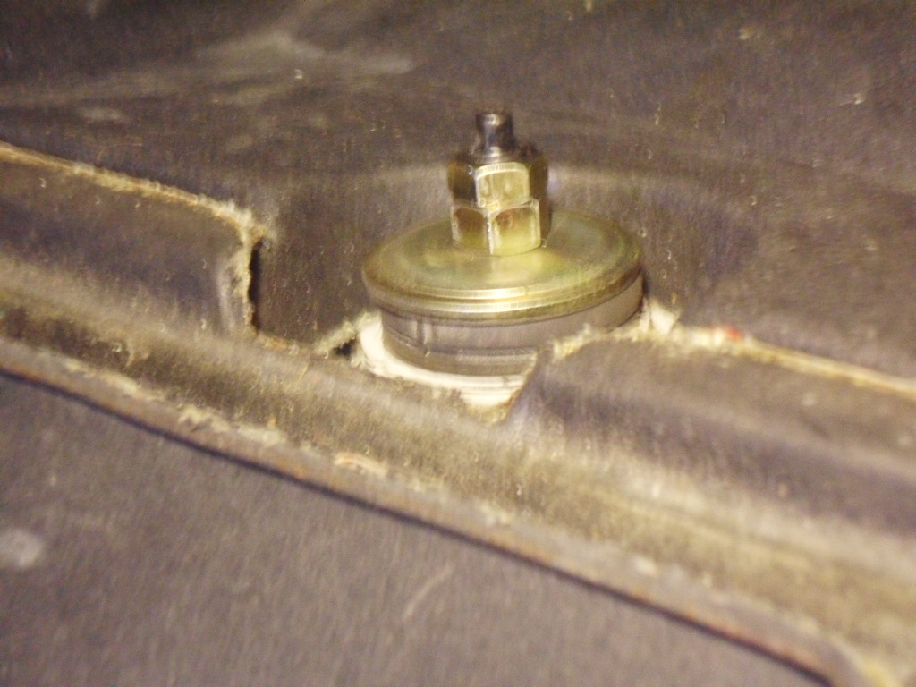

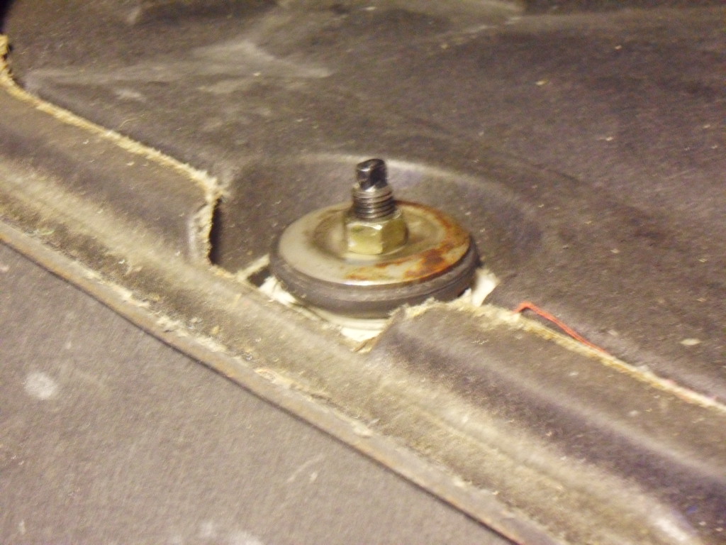

I tightened up them Top Nuts, and the Rattle Sounds reduced greatly...
Whilst driving with a person in the back seat, there was NO rattle sounds at all!
So I'm thinking that it must have something to do with, the Rear Shock Bushing or Mounts!

Before I made this video, I placed my fingers on the top nuts and felt the slight movement with each rattle...
I'm going to check the bottom mounts for wear, but the rattle decreased when the nuts were tightened!!!
So I'm thinking that they are most likely, to be the cause!!!

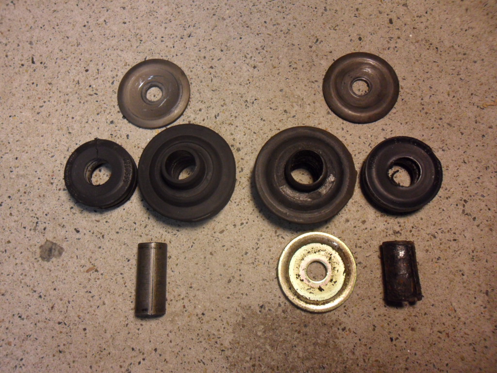

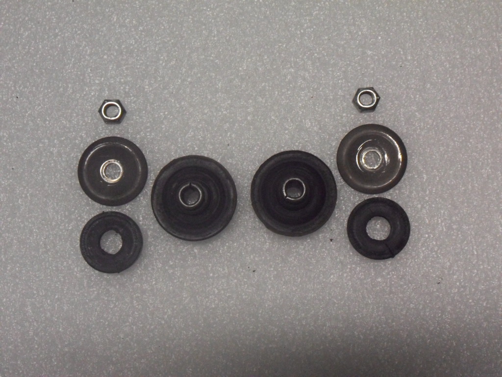

I got these Rear Shocks Bushes off a Barina/Corsa...
The bottom Section is like a smaller version of the Donut 'Rear Axel Bush'
I'll try these out soon, and see if the rattle sounds persist!!! :think:

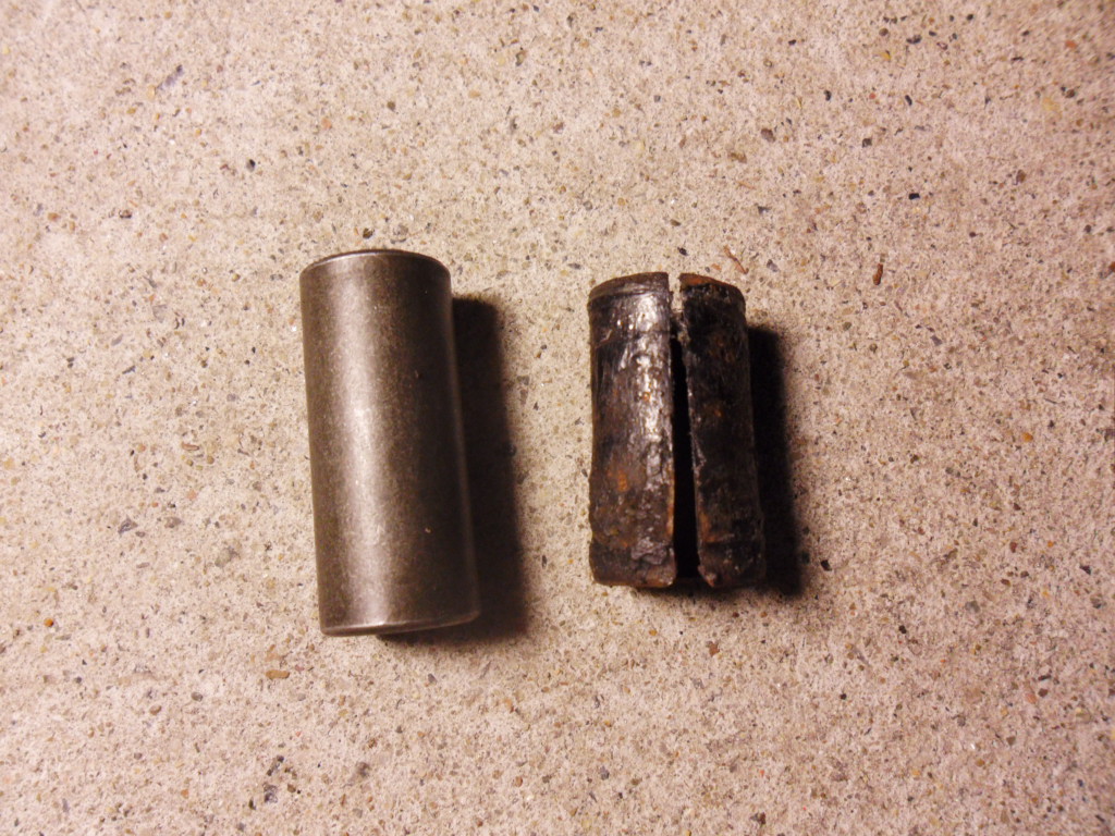

YES... I FINALLY SILENCED THAT ANNOYING RATTLE!!!
Yesterday I fitted the Newer Rubber Mount, Bush and Sleeve...
The Rubber Mounts were fairly worn, but they were NOT actually the problem!
The Metal Sleeve that sits in the Bottom Mount, was the cause of the rattle...
These were replaced, and NOT a single rattle sound anymore!!! :dance:
