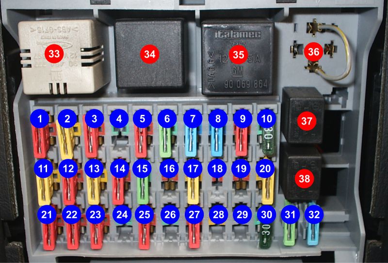

Well I doubt it is just the bulb, I've tried braking super hard a couple of times and the ABS definately didn't engage. Will check everything again though. Replacing the ABS unit is not so expensive though, an used one is like 30€. Another quick question, do you know what kind of relay is used for the foglights? I noticed it is missing.

by Cliff » Tue Jul 05, 2016 1:30 pm
Number 36 in this picture?
Posts: 513
Re: ABS not working
by chargerbandit » Tue Jul 05, 2016 2:57 pm
Nope I am missing 37 which I think is a foglight relay.
