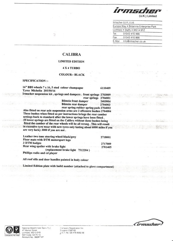

Specific LE parts nos are:
Wheels 6110409
Front Springs 2703009
Rear Springs 2704001
Front damper 2403004
Rear damper 2704003
Rear spring damper pads 2704002
Rear bushes 2704004
Steering wheel 2718001
Badges 2717009
Rear spolier 2701405
Replacement rear spolier brake light 7512204
Thats all the specific parts for an LE.

How's your Turbo LE coming along, Thomas?
Here's the Irmscher spec sheet confirming those part numbers:
Turbo LE Irmscher Parts.jpg (85.81 KiB) Viewed 11703 times

Thanls C411BRAnut and tommyo, ive noted that down for when i do need replacements....
