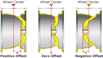

I'm also trying to work this ET thing out...
Maybe this diagram might help clarify...

Thanks the the pic Eddey. Best one ive seen. I understand the whole offset thing, just want to experiment with it, looks like ET35 is the lowest possible. Ive emailed a local wheel importer my requirements their liasing with their European supplier so ill see what they come up with. Damn GM's unconventional offset!
