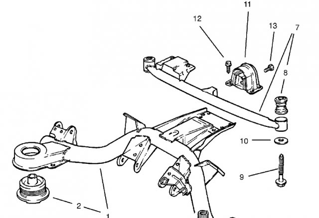

by EddeyDancer » Sat Mar 24, 2012 4:05 am
Is this Diagram of any use?
Can You see the relevant parts, on this???
Diagram Rear Axel.jpg (41.4 KiB) Viewed 14470 times
Re: Rear anti-roll bar links/bushes
by MadOnVaux! » Sat Mar 24, 2012 5:30 pm
I have the parts eddey cheers, they are not on that diagram though....the links attatch the ARB to the trailing arms.
