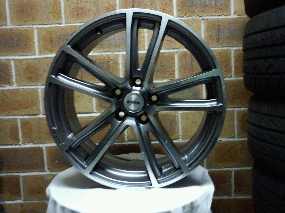

Mate...
I've actually always like that 'Style' of Rims as well...
I also bought another set of mags that turned out to be 112 PCD, and they do fit...
Just gotta get some tyres on them, and they'll be used for the 'Winter Look'

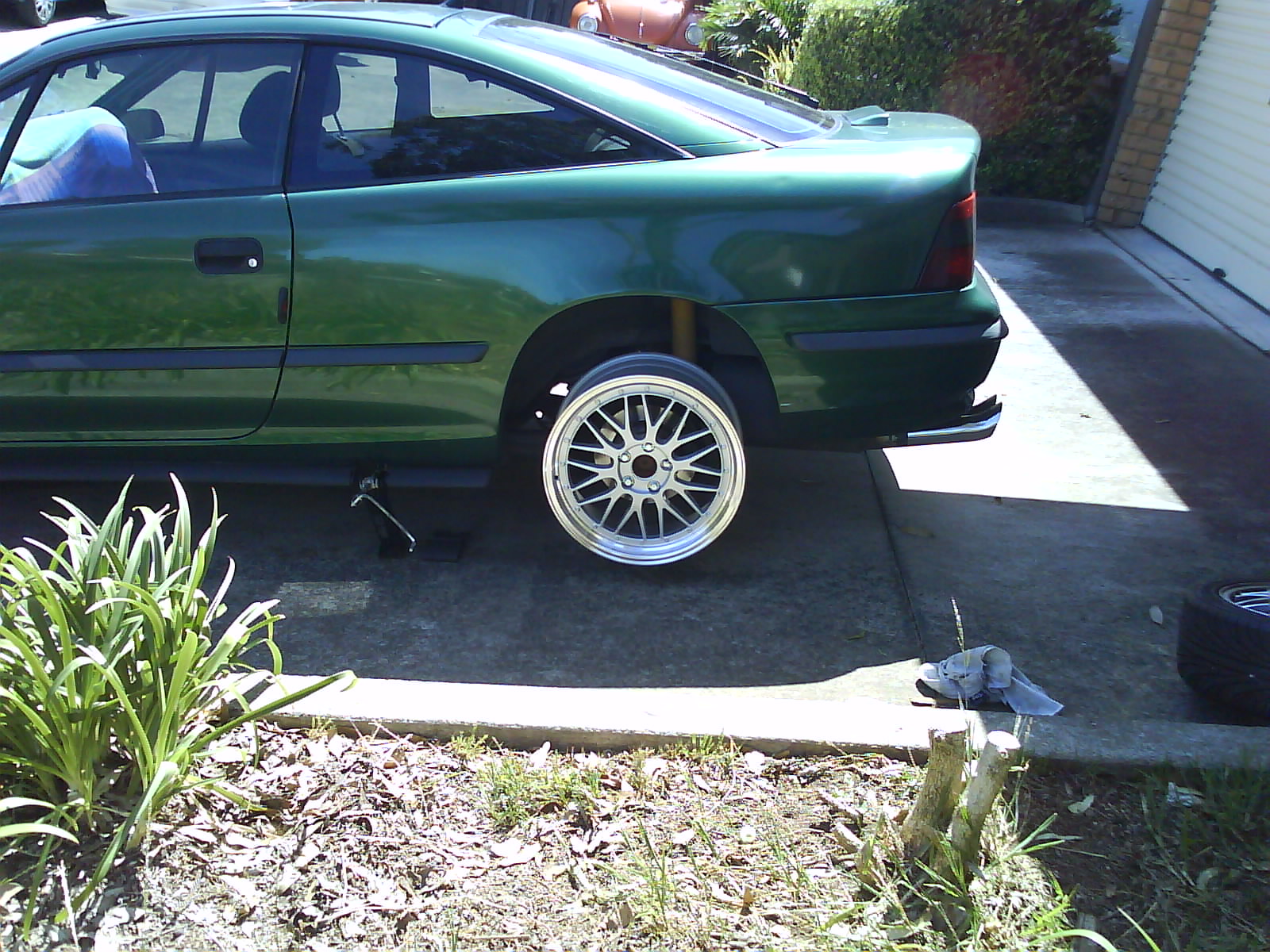

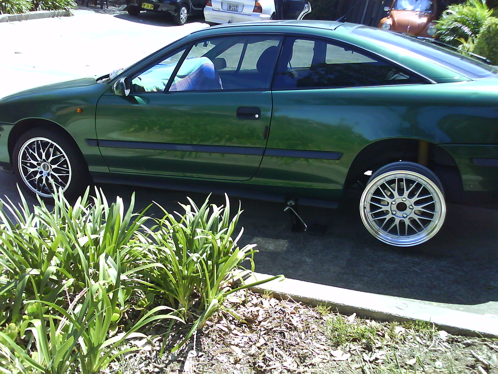

Hi Guys,
Below a photo with the test fit. I took out the old trust vernier caliper to measure up all the gaps and it will be OK with an ET45. The wheels have an ET of 42, but i have some four 3mm and four 5mm shims coming in to set that straight.
