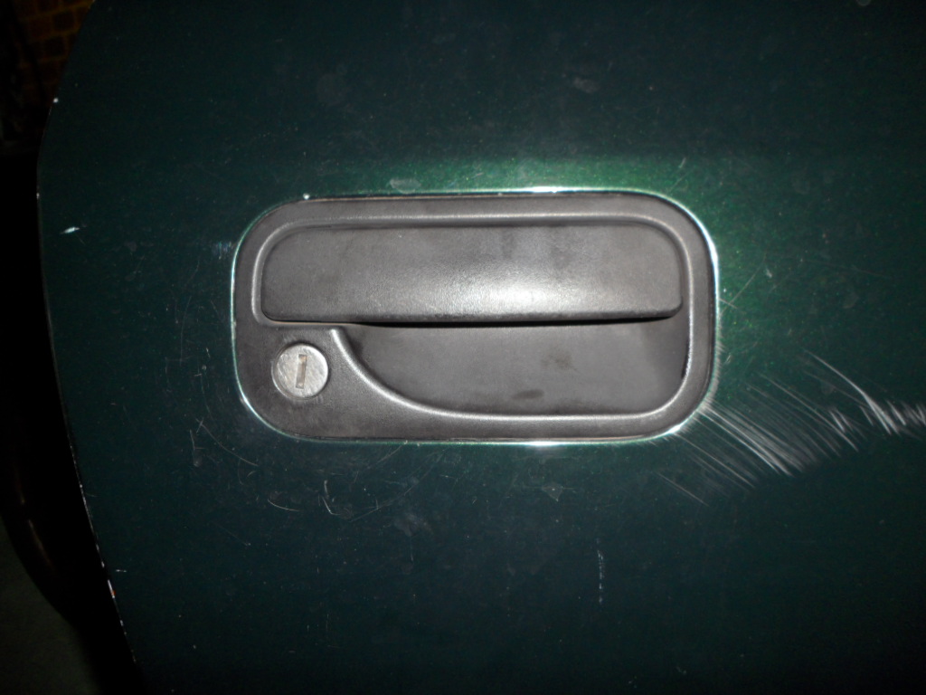

Fitting 'Key Operated' Vectra Door Handles...
Re: VECTRA DOOR HANDLE USING KEY

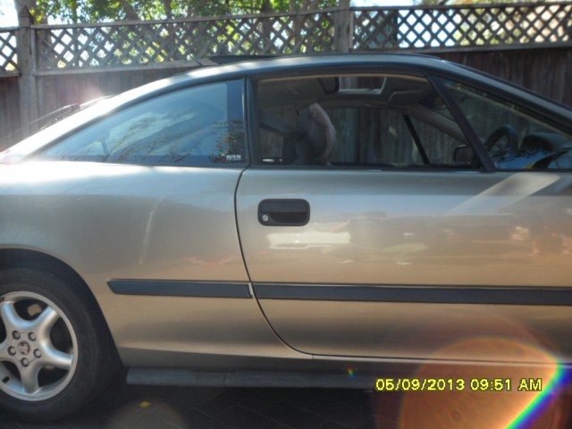

I fitted a Corsa Door Handle to a Calibra recently...
It's pretty much the same as the Vectra Part, just that it uses a different type of Key...
The most important thing in getting the Dead Locking to work, is the Door Locking Link...
There are a few variations of these, but only 2 will actually work...
The Blue one with the Lug off a Corsa, will work...
The Black one that came off the Vectra, won't work...

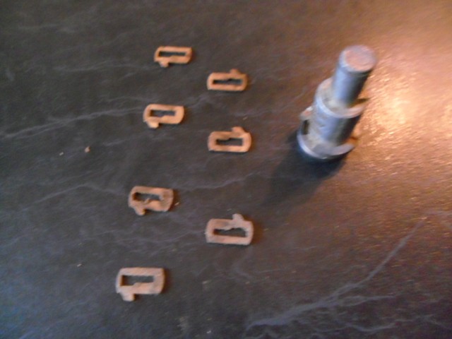

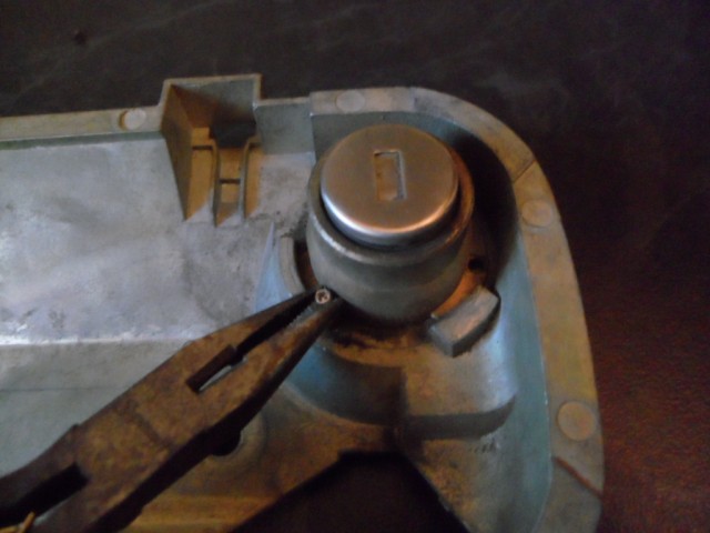

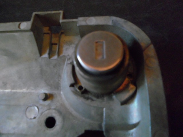

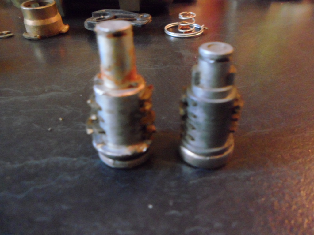

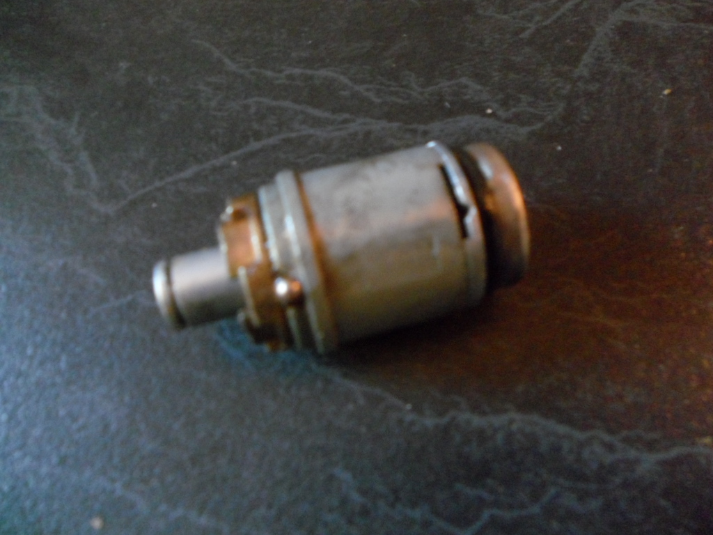

UPDATE...
After many hours of experimenting with the Shorter Calibra Barrel,
and the Longer Vectra Barrel, I finally had some success...
I can now use my 'Original Key' again, to operate the New Vectra Door Handle...
It's quite a delicate job, and it took me a few attempts to get it right, but I knew it had to work...
You simply transfer over the 7 tumblers noting their correct positions, from Calibra to Vectra, Key Barrel...
Yay... No need to have 2 different keys anymore!!!

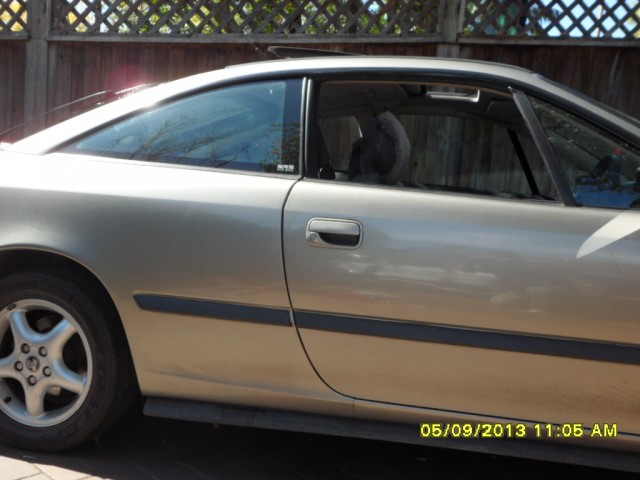

Re: Fitting 'Key Operated' Vectra Door Handles...
At it yet again...
Must Upgrade the door handles on The Stocky!!!
10/10 for effort and commitment!
RedCalibra33 wrote:10/10 for effort and commitment!
Thanks Mate...
