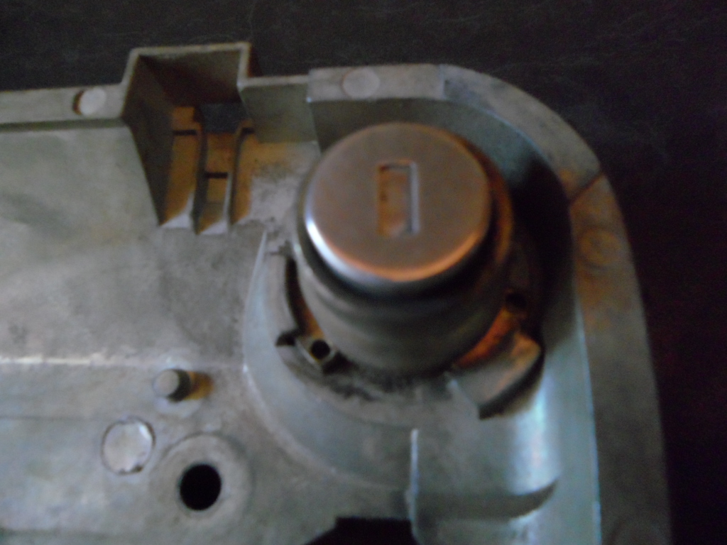

After many hours of experimenting with the Shorter Calibra Barrel,
and the Longer Vectra Barrel, I finally had some success...
I can now use my 'Original Key' again, to operate the New Vectra Door Handle...
It's quite a delicate job, and it took me a few attempts to get it right, but I knew it had to work...
You simply transfer over the 7 tumblers noting their correct positions, from Calibra to Vectra, Key Barrel...
Yay... No need to have 2 different keys anymore!!!
