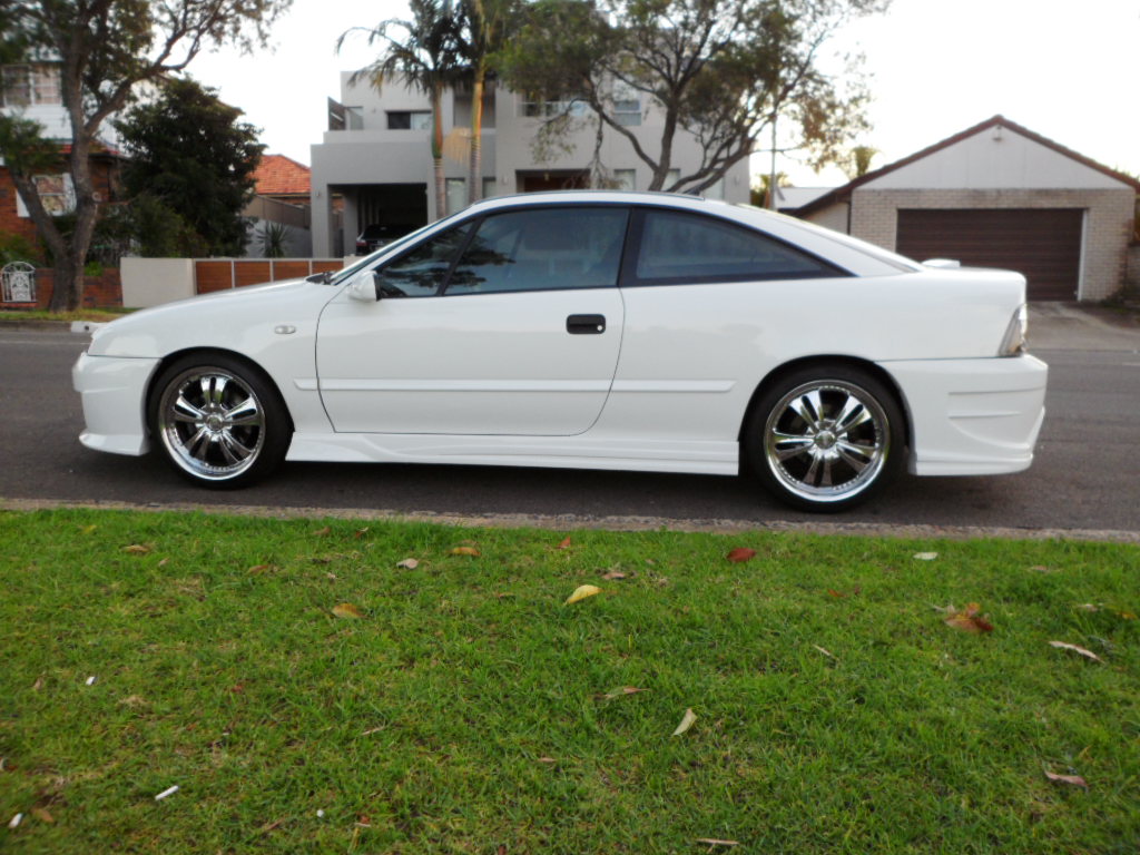

by EddeyDancer » Tue Jun 21, 2011 12:37 am
On 17" Mags with 40ET, I was using without any dramas:
Front: 215 45 R17 and Rear: 225 45 R17
Current Sizes are: 225 40 R18 - Both Front And Rear also 40ET
This size Tyre gives great handling, but does effect the turning circle at the front!
I'm going to put 215 40 R18 on the Front and experiment with 235 40 R18 on the Rear!
