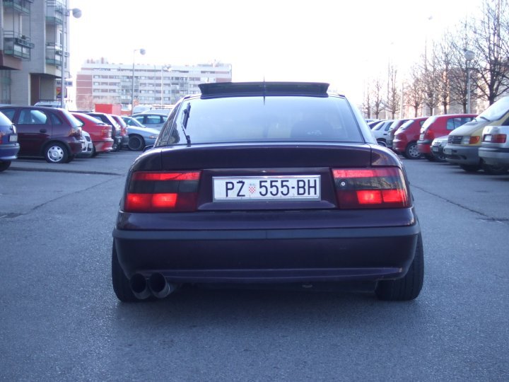

Hi guys.
I just want to show you my modded tail lights :)
hope you like it!
BEFORE
AFTER
Image Image
The LED strip is connected to the brake ligts.
Its easy job, I just put leds on tin strip from laminate, drill small hole at the corner of the light and slip it inside the lamp.
Image Image Image
Patent pending lol :assshaking:
:mrgreen:

so what you done with the reflector ??
Re: My new tail lights
by M4 TEJ » Sat Aug 21, 2010 8:58 pm
nothing really, it still reflects light when leds are off.

looks good u got a little more detail where the hole is

I did a hole ~15mmx28mm at the corner of the light.
Sorry but I havn't other pictures.
Ofcourse hole was made at the back ;)
http://zapodaj.net/f3a662362a43.jpg.html

looks like u broke right through to the front in 1 of the pics :think:
http://img411.imageshack.us/img411/6445 ... ize.th.jpg

That lamp had lots of history ;)
It was just spare light to work on.
If you will do this carefully it will be fine

I like this Concept...
I once saw a photo of tail lights, that looked liked the Guy had done this.
But as it turned out, it was just some reflection of light from the Sun.
I'm not really a fanatic of mixing the LED's with the Standard Bulbs.
As the light dispersion differences, just don't co-ordinate well.
But that's just My Stylish Opinion!!! ;)
