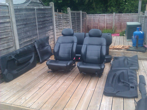

by EddeyDancer » Wed Nov 02, 2011 5:58 pm
v6 steve wrote:I'm pretty sure that all cars have the same loom
I'm certainly hoping that, that's the case...
As I'm really looking forward to fitting the Black Leather Interior, in a few weeks!
If there's no connectors beneath the carpet, I won't be all that sad...
But it would be a nice additional option to have! ;)
