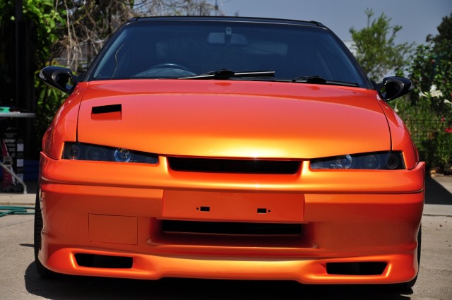

I had one welded one.
The fibreglass one I purchased seemed very flimsy, and when test fitted we almost broke it.
Can get the angle you want exactly too

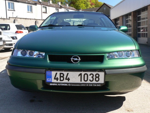

I've got a bonded fibreglass one, I think the body shop used some rivets + glue for bonding windscreens - seems solid enough. So far no cracks at all, but be ready to get your fingers streched, as the bonnet catch is a real nightmare to reach!
