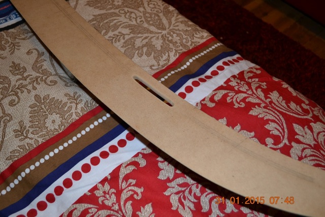

I have the top panel now cut and shaped and starting to work on the vent cut outs.

by cal16v » Sat Jan 31, 2015 6:06 am
Almost there...
Just need the recessed holes to secure it in place and a couple of coats of clear and it's ready.
