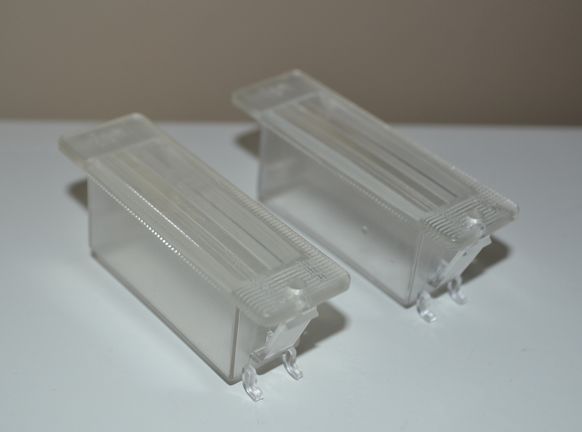

Ran across this website by chance and thought I'd try the process on the rear number plate lamp units. Unfortunately I didn't take any before pictures but they were yellowed like everyone else's naturally. So far they've been soaking for a day in the sunlight (predicted UV index of 9 for today and tomorrow) so I'll pull them out after another day's sun and check the result.
Re: Rear number plate lamps - De-Yellowing
Only got half a day's sunlight but the results have been worth it. Certainly worth doing again during the height of the coming summer...
A reasonably small easy job, for a fairly decent difference...
