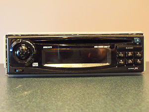

what model of clarion is it ?
Re: Wiring Up an Aftermarket Head Unit
Fraz wrote:what model of clarion is it ?
DRB3375
I don't even listen to music when driving, but I'm wanting to replace the Original Head Unit, mainly because the Tape Deck looks out-dated, and brings down the rest of the interior...
