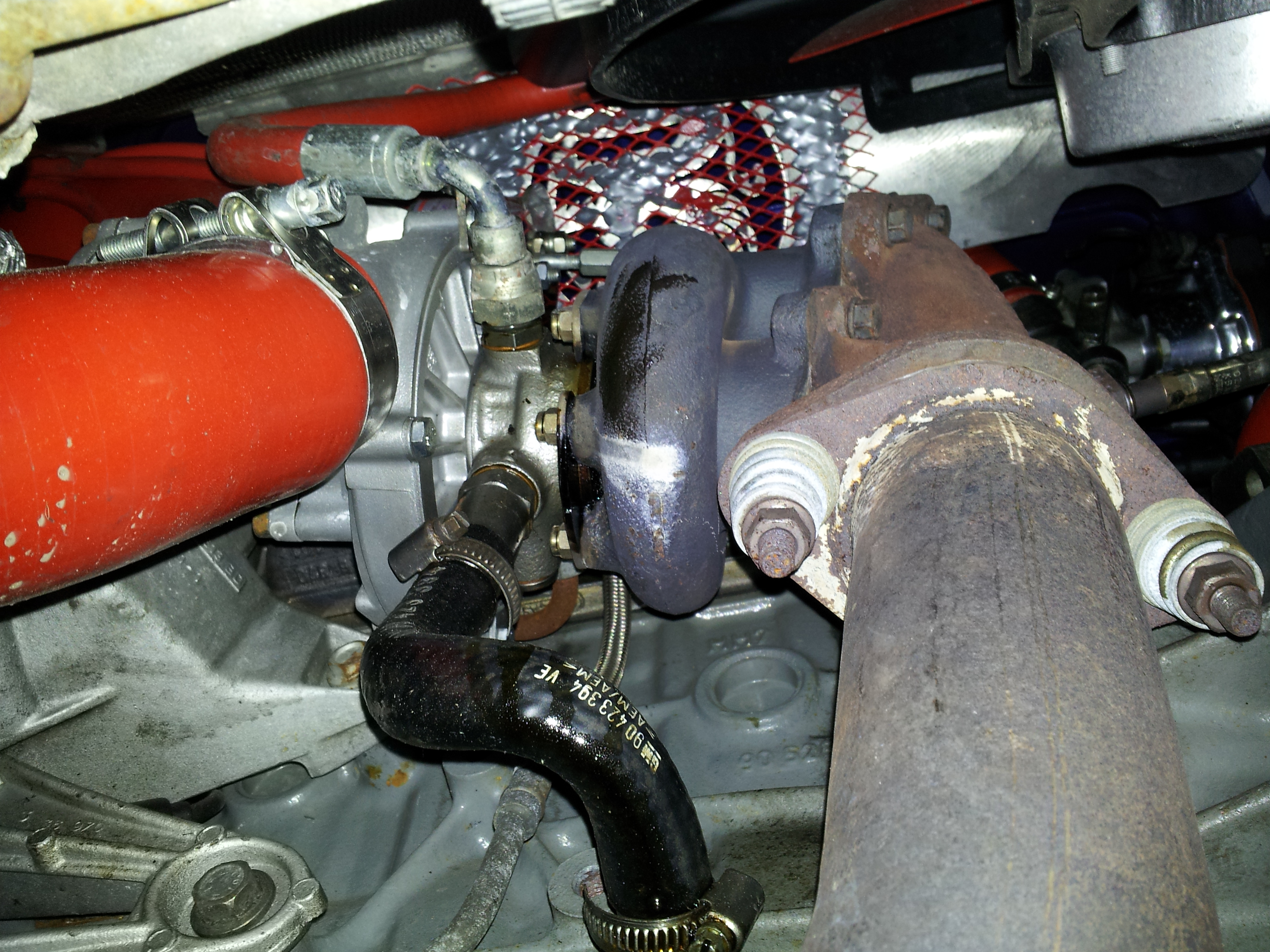

You'll get the smell of burning oil in the cabin if the oil in the turbo bearing is getting past the seal. (fairly common).
Look at the turbo from underneath and look at the exhaust side, if it's black/carbonised on the surface then the oil is getting past the seals and leaking out, but to notice a drop in oil level it would have to be a bad leak, it would really stink.

Hold up! Is that a small crack in the rim i can see there?? only tiny but looks like it might be one

The Turbo can leak oil onto the outer casing. Mine did it.
You can see it on the drain pipe and where I've rubbed it onto the casing. It Wasn't coming from the pipe fitting.
If you have high oil pressure you really need staggered oil seals.
