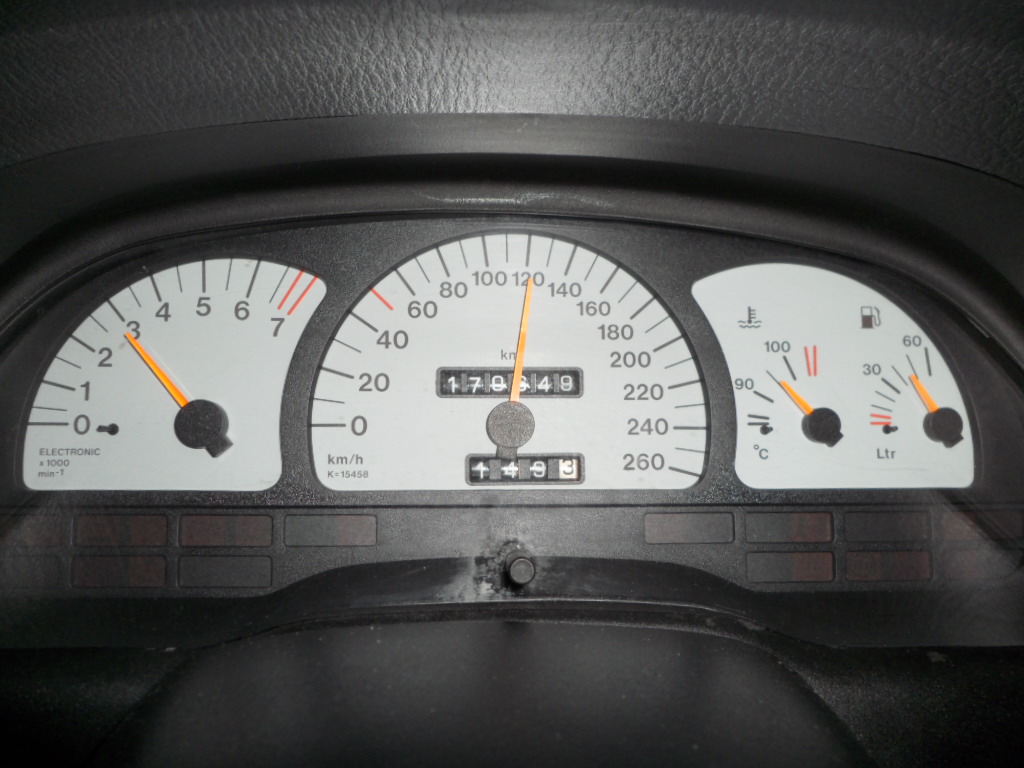

I'm planning on fitting some White LED's in the Dash Instrument Display Panel...
But I don't know how many, and what type of LED's that I need to Order!
Any assistance with this would be Much appreciated... ;)

by RobbieV » Thu Apr 21, 2011 12:19 pm
You will need 4 509T led bulbs for the dash :)

by EddeyDancer » Thu Apr 21, 2011 1:35 pm
Wow... Is that all...
I was thinking that there'd be heaps more!
Is this Link suitable?
http://cgi.ebay.com/ws/eBayISAPI.dll?Vi ... =h:h:alt:3

I put 2 of these LED bulbs in the VDO Oil and Battery Gauges!
There was a huge difference, in the light colour and brightness! :shock:
I'll do the Main Dash Gauges very soon, and Post the pics of course! ;)
