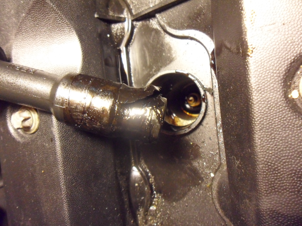

STAGE TWO: Spark Plugs, Leads and Leaking Cam Covers
1 - Removed Ignition Lead Number 1 - It was Badly Damaged and covered in oil
2 - Removed and Cleaned the Rear Rocker Cover - Plenty of Oil in Spark Plug wells
3 - Cleaned up the Oil In Spark Plus wells, and replaced all Spark Plugs with NGK Iridiums
4 - Re-fitted the Rear Rocker Cover and used a New Gasket
5 - Replaced all Ignition Leads with a New Bosch Set
SUMMARY: Service done @ 173,770 Km
For the first time, I got to inspect what's under the V6 Manifold...
I pulled out Ignition Lead No1, and was stunned at it's condition...
It had been patched up with Electrical Tape, and there was heaps of Oil in all 3 Rear Spark Plug Wells...
This Oil Leaking is due to the Poor Design, of the Plastic Cam Covers!!!
Now that I've seen this, I'm Upgrading to the Vectra Metal Cam Covers ASAP!!!
I then cleaned up the Oil in the Spark plug wells, and fitted the New NGK Iridiums...
I then cleaned up the Rocker Cover of the excess silicone, to prepare it for re-fitting...
Once the Rocker Cover was back on, I got out the New Bosch Ignition Leads Set...
I also replaced the Alternator Cooling Fan, before re-fitting the Manifold...

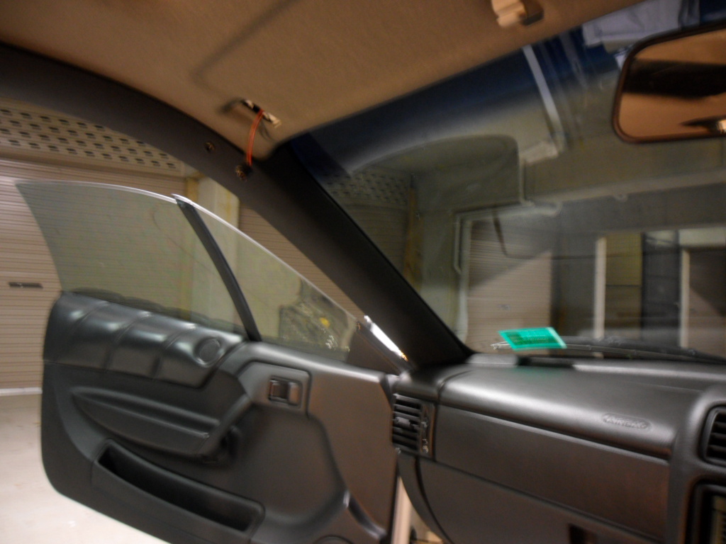

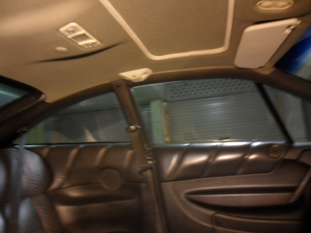

Re: Eddey's V6 - Progress with New Look Interior
by EddeyDancer » Sat Dec 03, 2011 6:09 am
THE PROGRESS WITH MY 'NEW LOOK 3 TONE' INTERIOR!!! :shock:
ROOF LINING:
I was originally planning on using a Black re-trim, but after a conversation with the Trimmers, I opted not to...
So after looking at various materials and colours, I decided to use a Darker Shade of Grey cloth, instead of the Black Vinyl...
Mainly because I wasn't too keen on painting the Sunvisors, and then having to constantly touch them up over time!
Plus the Darker Grey means that dirt wont show up so easily, and it will blend in well with the Black Leather Interior on a White Car!
OTHER INTERIOR DETAILS:
I've always preferred the Black Coloured Pillars over the Cream Coloured Pillars!
So when I got some in Black, I was very excited about the impact that it would have!
When I scored the 'Bug Eyes Style - Interior Light' I actually didn't know if it would even fit the Calibra...
I also bought a Smoked One in the same style as the Original as backup, but Bug Eyes was First Choice, and fitted well :shock:
I then fitted the same LED's that I put in the Original Interior Light, but the difference in light dispersion was Huge!!!
Bug Eyes Map Lights point down, instead of to the sides, and I also like the way Bug Eyes fits in with the New Colour Scheme!
