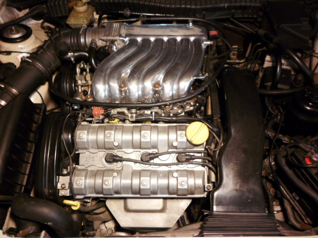

SOME MINOR DETAILING...
I fitted the more discrete Black Oil Cap, and will keep the bright Yellow Oil Cap as Spare...
