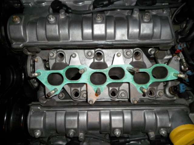

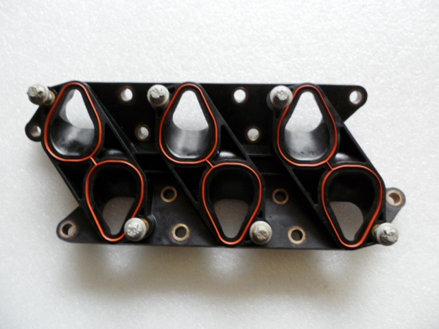

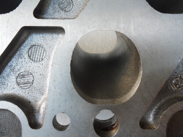

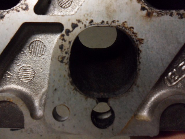

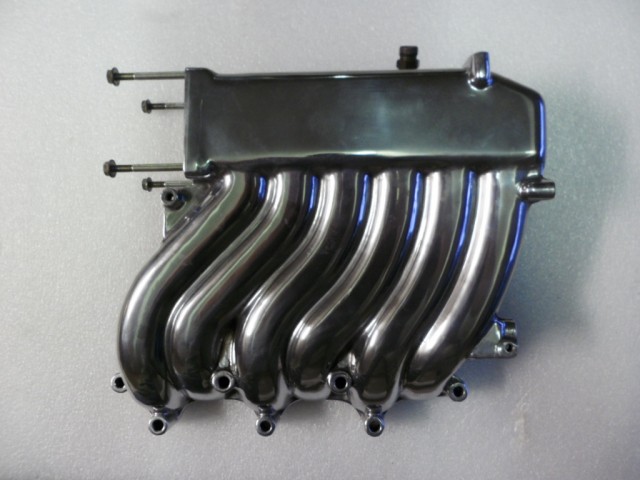

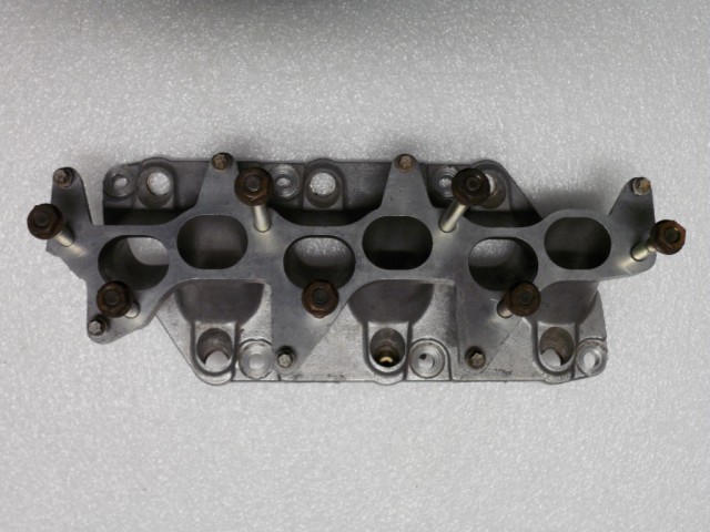

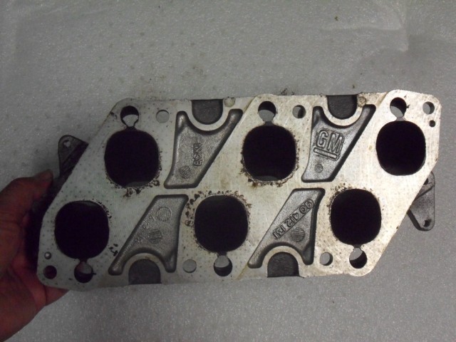

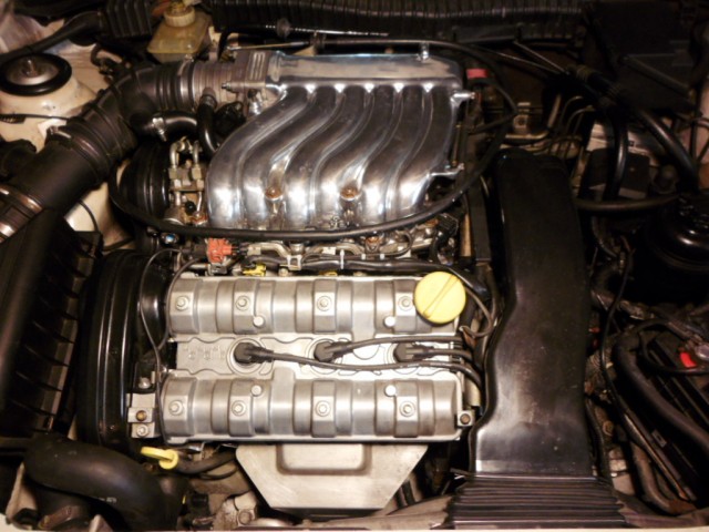

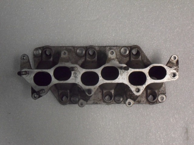

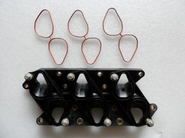

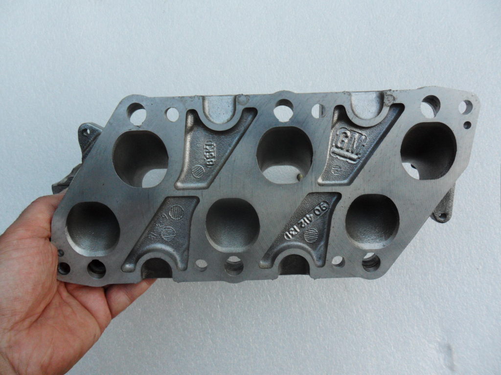

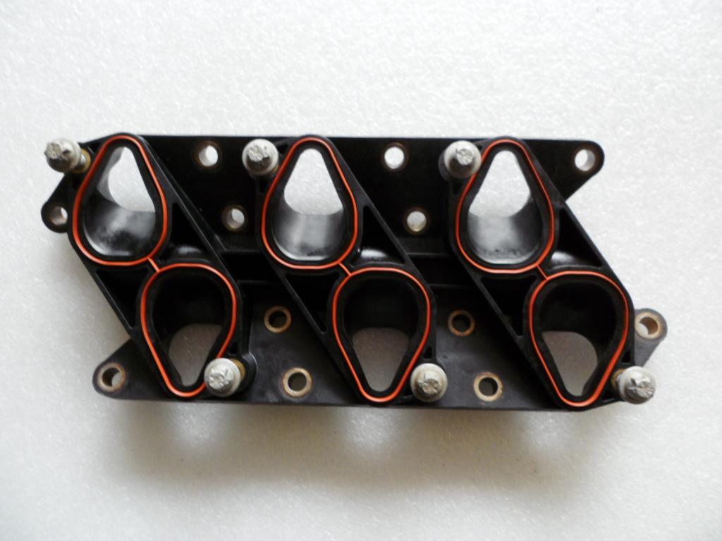

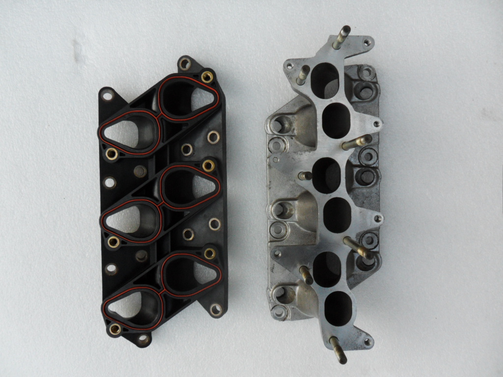

THE THREE INLET MANIFOLDS
Lower Inlet Manifold - Upgraded 3.0 Vectra Part
Centre Inlet Manifold - Replace with Cleaned Part
Upper Inlet Manifold - The Engine gets some Bling!!!
I spent a few hours cleaning up these Manifolds, in preparation for this Phase!
THEY ARE NOW ALL READY TO GO!!!

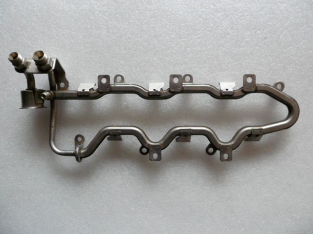

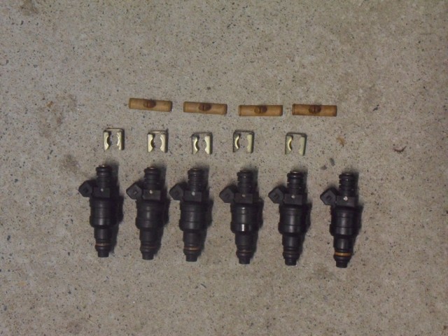

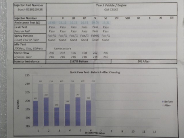

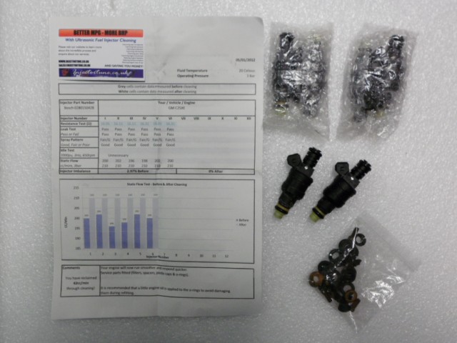

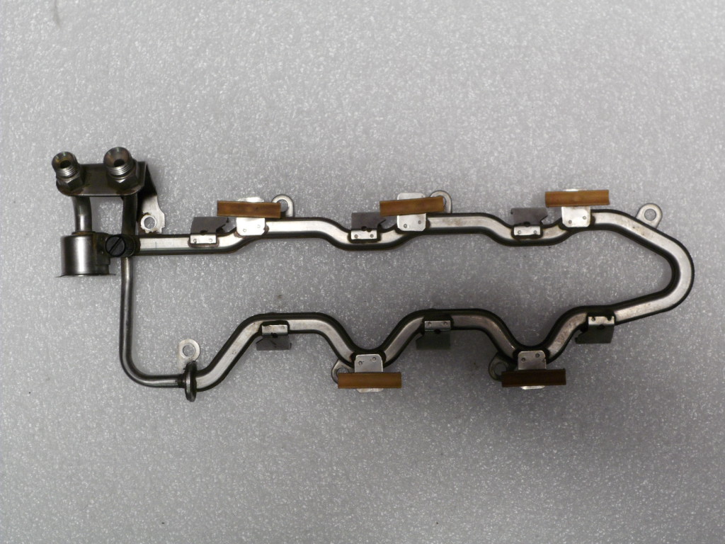

THE FUEL INJECTORS & FUEL RAIL
Fuel Injectors - Bosch Parts Serviced and ready to be fitted...
I gave the Fuel Rail a good cleaning up with Throttle Body Cleaner, in preparation for this Phase!

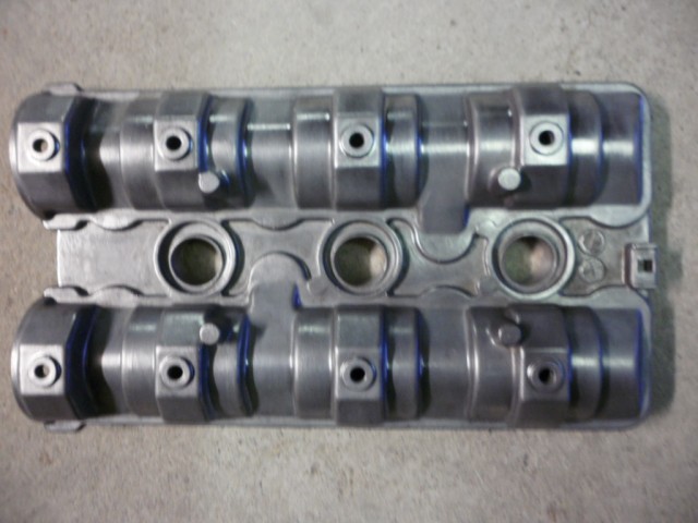

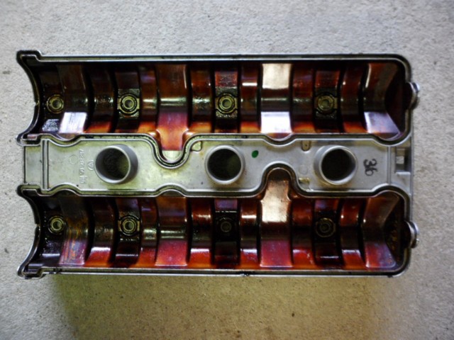

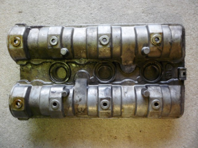

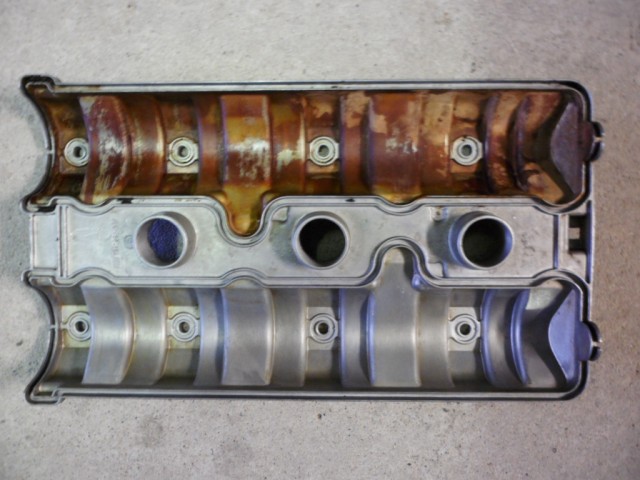

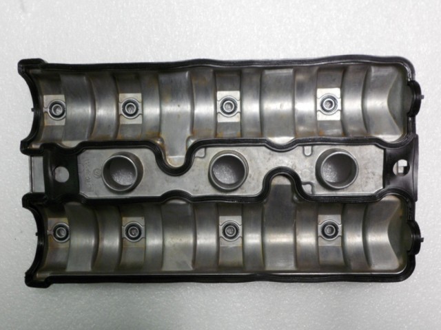

THE CAM COVER METAL UPGRADE
Cam Cover Metal Rear - Upgraded Vectra Part with New Gasket with O Rings (Front Cover already done a few weeks ago!)
I gave the Rear Cam Cover a good scrubbing up with Throttle Body Cleaner, in preparation for this Phase!
IT'S NOW ALSO READY TO GO!!!

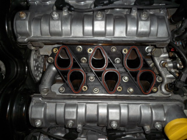

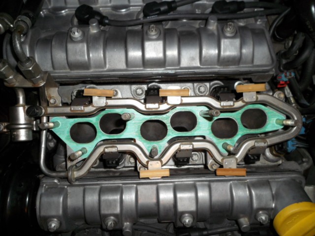

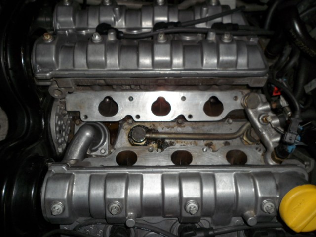

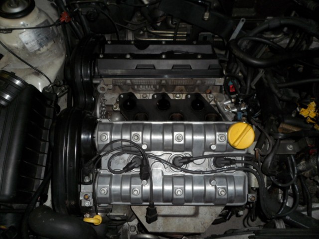

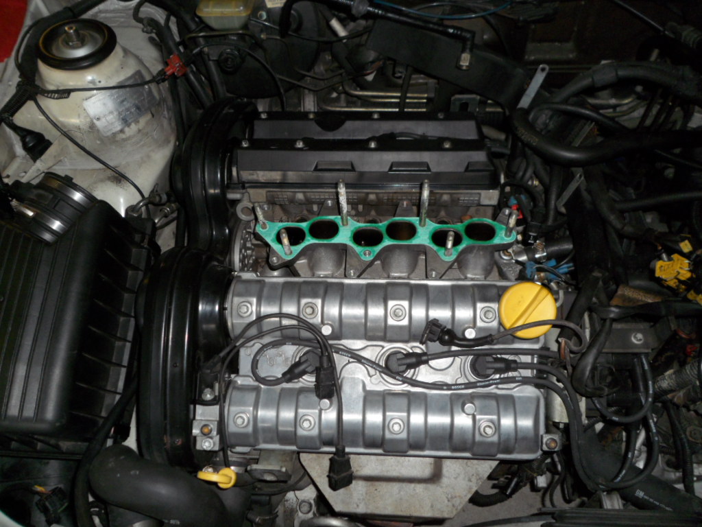

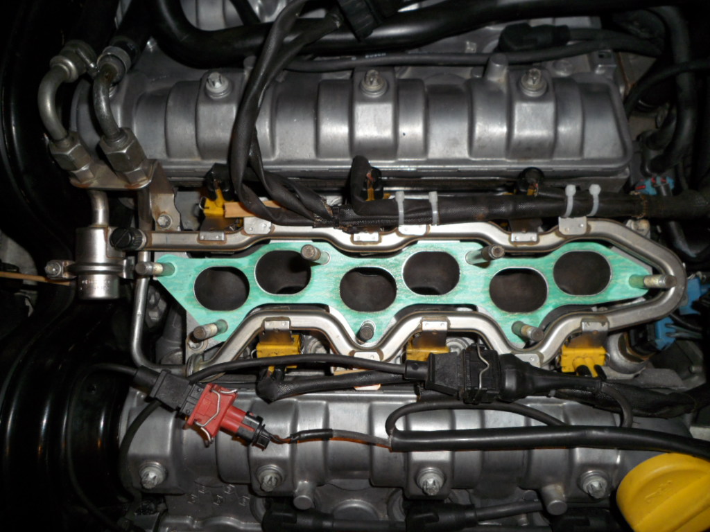

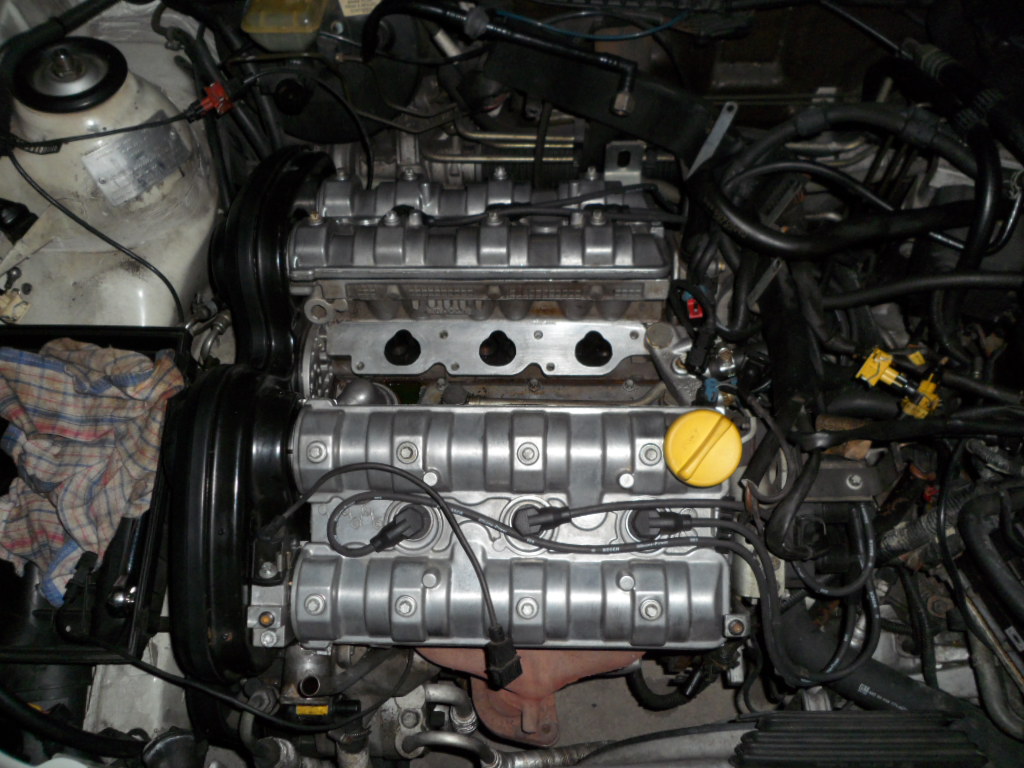

COMMENCED ENGINE PHASE:
I started the 'Engine Phase' the other day, and had a good start...
1 - Removed the Upper Inlet Manifold with ease...
2 - Removed the Fuel Rail and Injectors with ease...
3 - Removed the Centre Inlet Manifold with ease...
4 - Removed the Lower Inlet Manifold with ease...
Then the Headaches started...

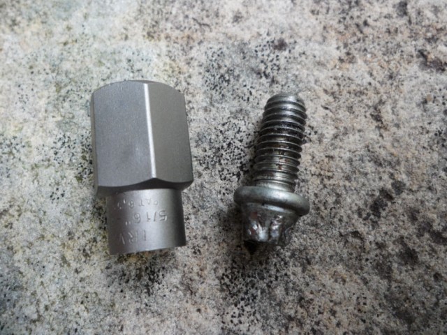

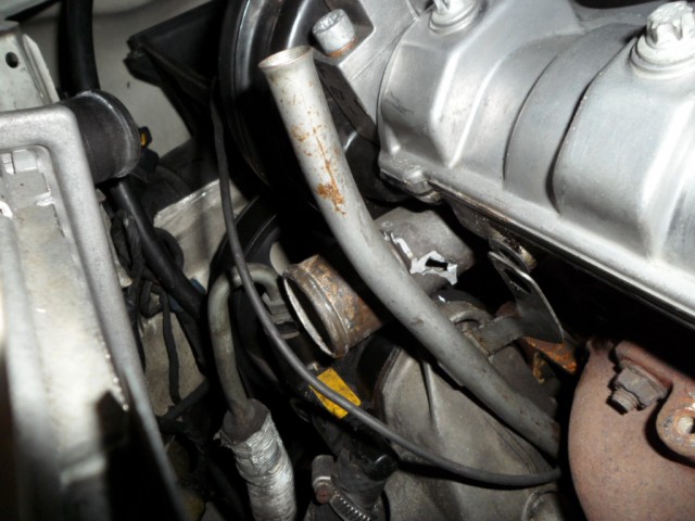

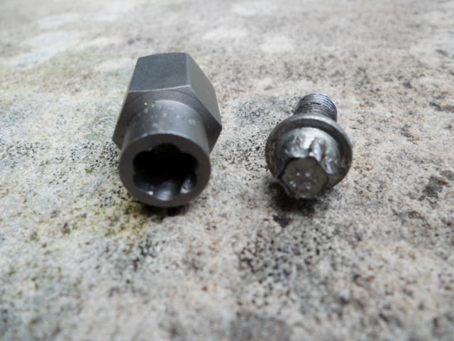

Whilst trying to remove the bolt that secures the 'Thermostat Extension Pipe' with 8mm socket, it slipped...
Tried various different size tools, but none were gripping the damaged bolt, so I decided to give it a break and do some other work...

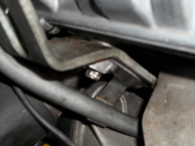

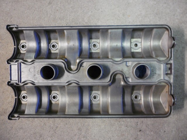

So I fitted the Metal Cam Cover on the Rear... All was going well till the last bolt... It was not tightening, and just kept turning, but the
worst thing about this was it's R1 location... I knew that the Cam Shaft Retaining Bracket was threaded, but the R1 Bracket is one that
I didn't have a spare... I tried several different bolts, hoping one would grab, but there was to be no suck luck...
I gave up one this R1 bolt, and continued with stripping the Original Upper Inlet Manifold...
I removed the all of the components, and transferred them over to the Polished Manifold...
Now that's ready to go, I then fitted the Serviced Injectors onto the Fuel Rail, and clipped them secure...
That then disappointingly concluded Day One of Engine Phase...

Re: Eddey's V6 Profile
ENGINE PHASE DAY TWO:
I was off to a good start being that...
I Modified a Bolt, that eventually did secure the R1 Bracket... So Rear Cam Cover is now done!!!
I was also in luck being that the Local Mechanic lent me the Special Socket, and I was able to easily
remove the bolt that secures the Thermostat Extension Pipe...

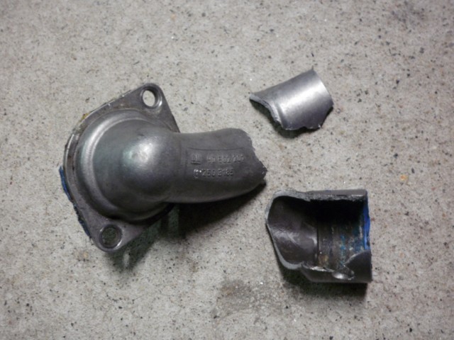

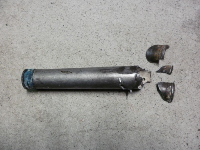

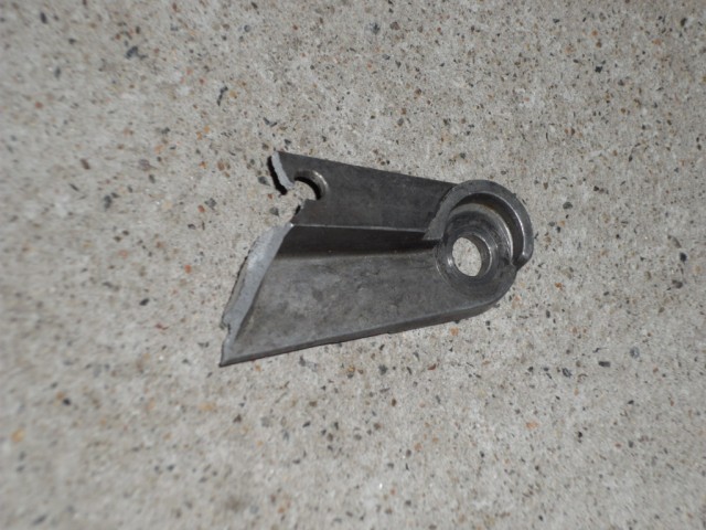

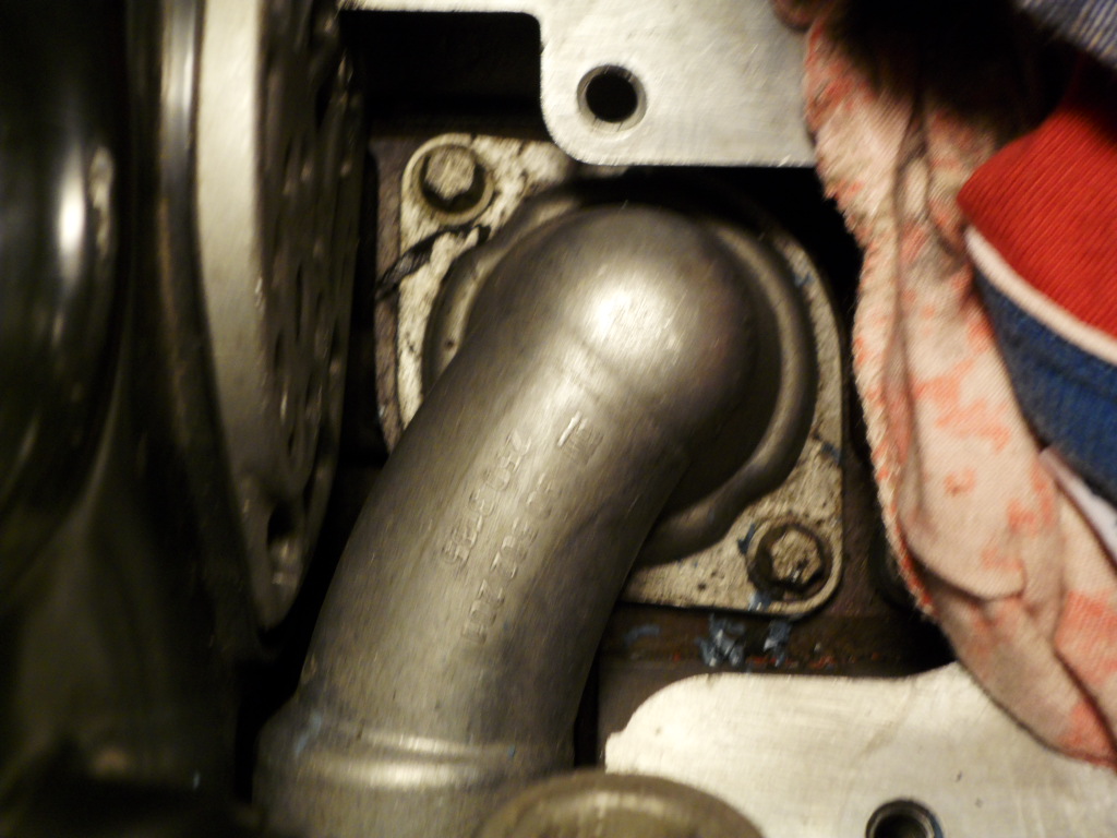

I then got to the 'Hard Part' of removing the Famous Pipe...
I spent a few Hours on this and yes, the Tab broke off...
So that's where I'm at right now!!!

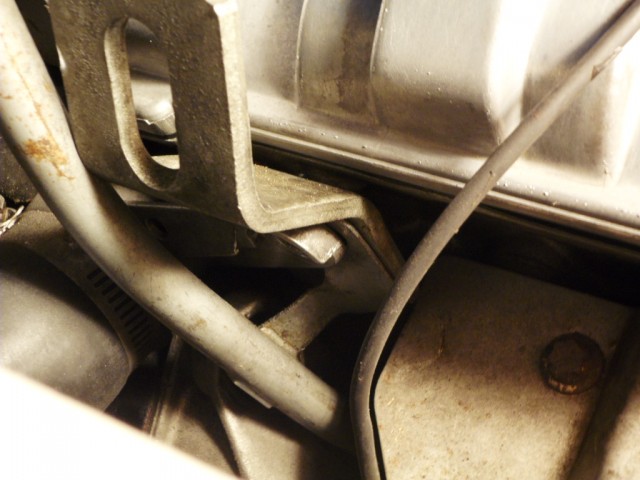

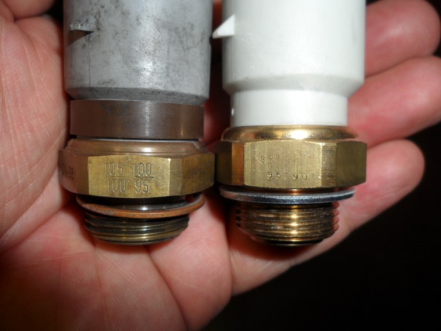

thought the bolt on that was a female torx and not an 8mm
v6 steve wrote:Your doing a great job mate keep at it
THANKS MATE...
Fraz wrote:thought the bolt on that was a female torx and not an 8mm
This is what stopped the Progress that day...

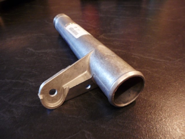

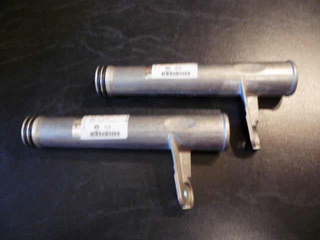

The 'V6 Thermostat Extension Pipes' arrived...
Ordered & Paid: 25 Jan 2012
Parts Delivered: 29 Feb 2012
5 weeks in total waiting time...
After all that time waiting, I can now get on with completing the Engine Phase!!!

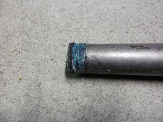

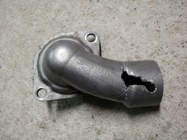

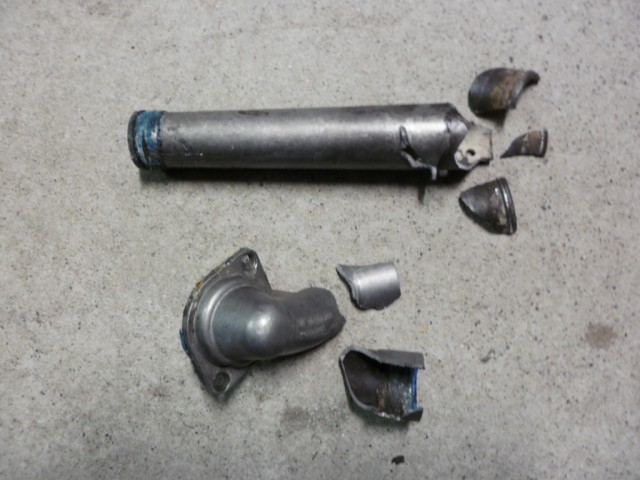

I actually made some progess today, in that I finally removed 'The Headache' Thermostat Extension Pipe!!!
The Extension Pipe was really corroded, and the only way to remove it, was to smash the Thermostat Housing...
I drilled a few holes into the Thermostat Housing, to weaken it... I then got out the Hammer and Chisel and went to work!!!
I'll be getting stuck into it tomorrow, and I'm hoping that the 'ENGINE PHASE' will be completed by the weekend...
If all goes well with re-fitting the New Thermostat Housing and Extension Pipe, The Ghost will be ready even sooner!!!
I'll know more, this time tomorrow...
Having ditched the distraction, AKA The Useless Ex-Girlfriend...

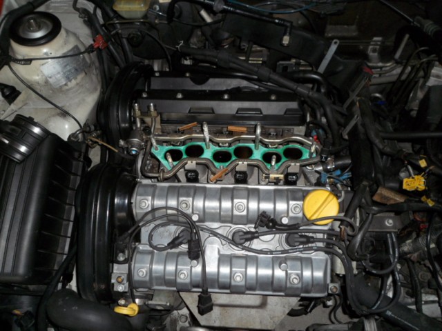

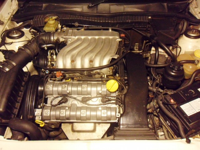

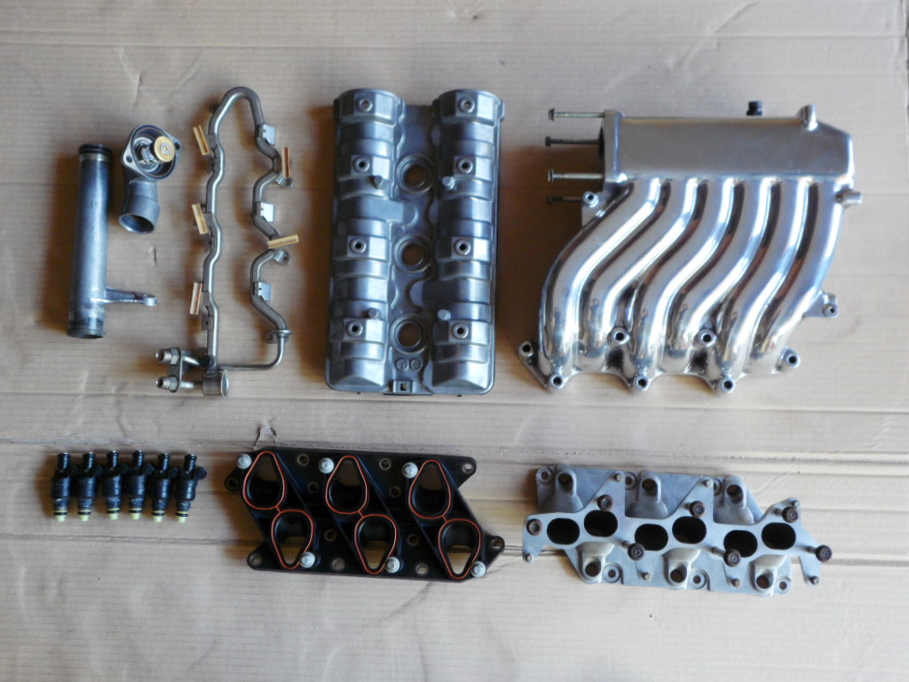

ENGINE PHASE: ACTIVITY UPDATE

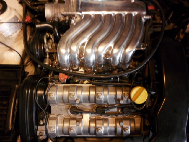

I got right into completing the 'ENGINE PHASE' last night, and I actually did pretty well...
I was hoping to fit the New 'Thermostat Extension Pipe' without having to remove the Radiator, but that's not happening...
Anyway, I decided to use an Old Pipe that has a Broken Tab, just so I can fit the rest of the Engine Parts back on and get it started...
As the Radiator will have to come off when I fit the New Condensor and the Lower Temp Radiator Fan Switch, I decided to wait till then
and do them all at once, but who know's what will happen in the next week or so... I might change my mind, if I feel motivated...
But it certainly started up with a 'ROAR' so I'm very keen to see what impact, the new parts will have...
Just the New Condensor, New Radiator Fan Switch and the New Thermostat Extension Pipe to be fitted now...
