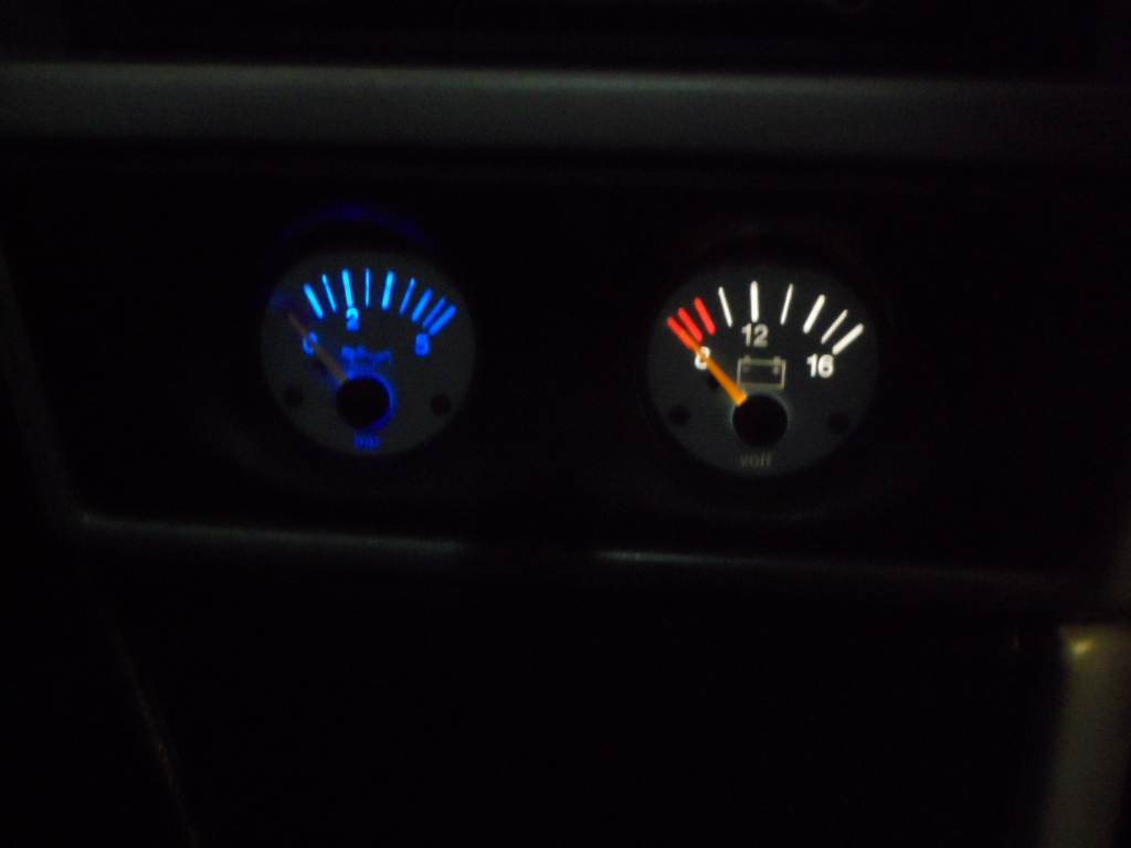

Just an 'Example' of some work I've done recently, for others...
Thought I'd share this Information, so others can use it as a Guide to check up on Your Calibra!!!
Where shall we Start???
FUSE BOX:
Inspected both Fuse Boxes - Some missing and some were incorrect
DASH AREA:
Steering Column Shrouds fitted correctly - Wrong/Missing Screws
Dash Display Shrouds misaligned - Fitted Correctly
Fitted Heater Control Panel Bulb - Was blown
Fitted Trip Computer Bulb - Was blown
Replaced some Instrument Panel Bulbs - Blown
Replaced Ingnition Key Surround - Was warped
Fitted Bulb in Oil/Volt Gauges - Was blown

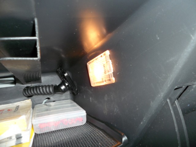

Replaced Glove Box Light Unit - Was burnt out

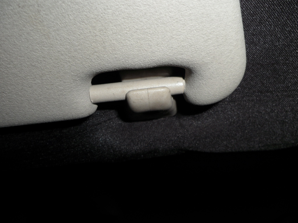

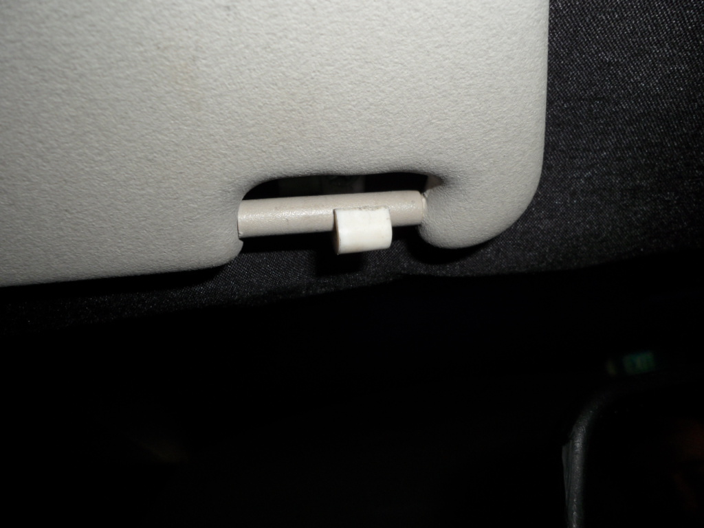

Replaced Sunvisor Clip - Was Incorrect Part

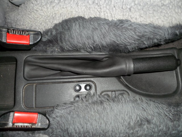

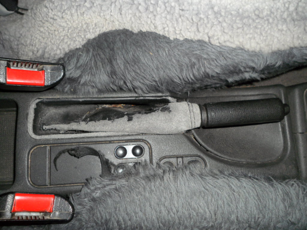

Replaced Handbrake Gaitor - Flaking Badly

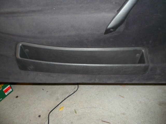

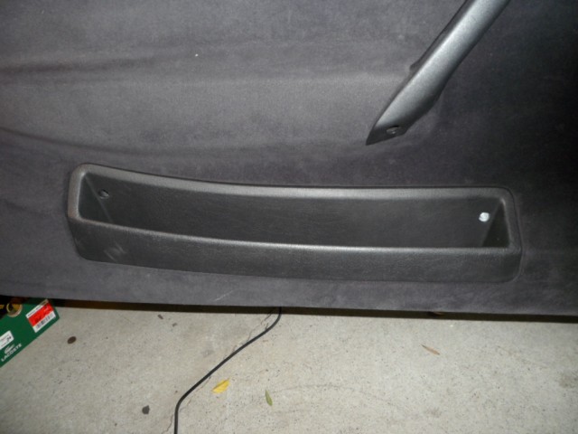

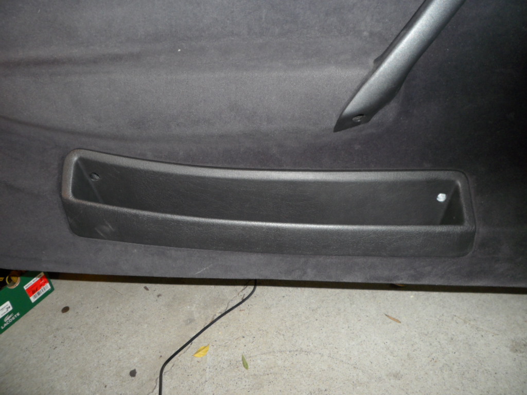

Tightened all Screws on Door Trims and fitted Trim Caps - Loose and missing caps

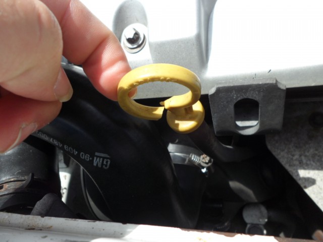

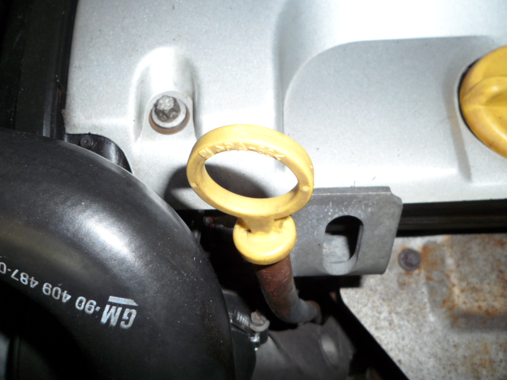

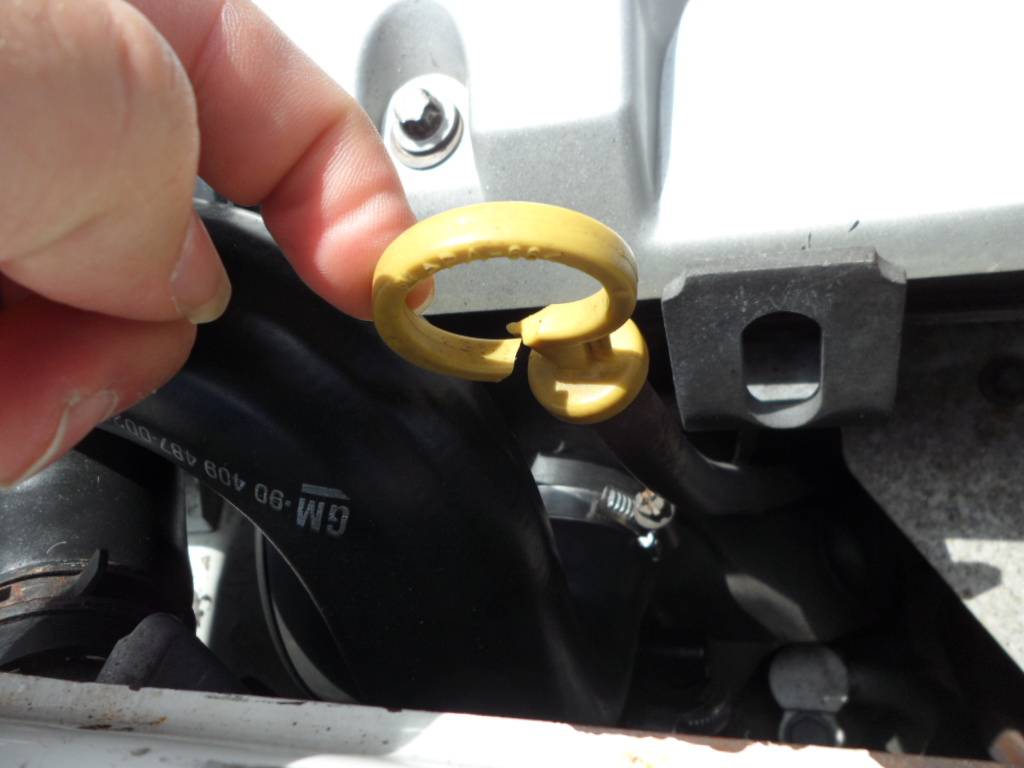

Replaced Dip Stick GM Unbroken - Was Broken

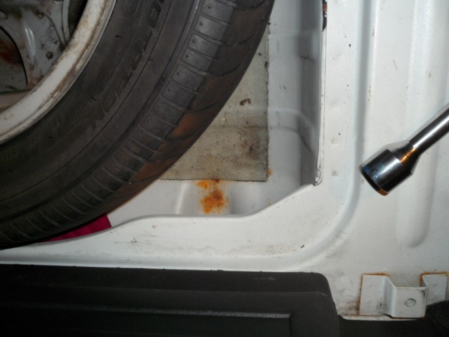

BOOT AREA:
Fitted correct Knob to Storage Section of Safety Triangle Reflector - Was missing

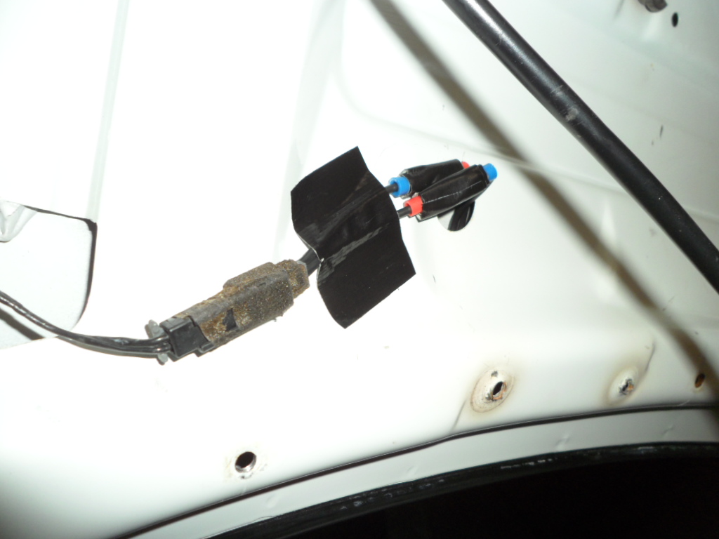

Replaced Centre Brake Light Unit and did the wiring properly - Kaput
Fitted 4 x new Bulbs in the Centre Brake Light Unit - 1 was blown
Fitted Rubber Gasket for Centre Brake Light - Was missing
Aligned Rear Wiper Motor and Wiper Arm - Used better Bolts - Was loose and incorrectly fitted
Fitted Tailgate Trim properly, and changed all bolts - now tight - Incorrect Bolts used
Fitted Boot Rubber Mat Sound Deadening - Was missing

Whats worrying is the broken dipstick?? I hope it wasnt the wrong end that was broken and there is a bit of metal floating around your engine!! haha

Jamesyboy wrote:Whats worrying is the broken dipstick??
Indeed...
See the difference, such a small thing can have!!!

whats with the two dead sheep on your seats
Re: TIDY UP YOUR CALIBRA...
Glad you asked that
v6 steve wrote:whats with the two dead sheep on your seats
EddeyDancer wrote: Just an 'Example' of some work I've done recently, for others...
Mate... I've got Style... Did you seriously think, that those were my seats???
Just so you know, I did tell him that those seat covers had to gooooooooo!!!

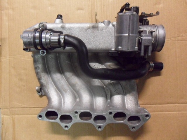

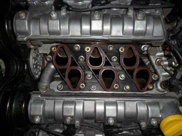

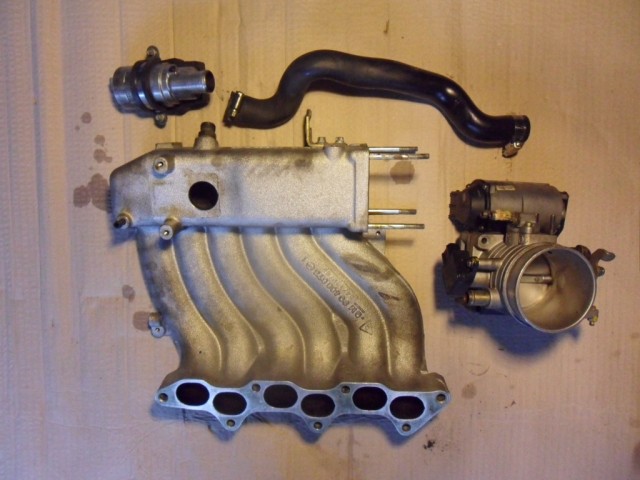

I replaced his door handles, and finally convinced him to ditch the shaggy seat covers...
Also did some Engine Work and for him recently, so he's happy with how it's running now...
- Attachments
- Lower%20Manifold%20Fitted.JPG (72.89 KiB) Viewed 78663 times
- Inlet%20Manifold%20Stripped.JPG (65.7 KiB) Viewed 78663 times
- Inlet%20Manifold%20Reconditioned.JPG (62.39 KiB) Viewed 78663 times
Hmmmm, shiny, what a shame you won't see most of that when it's in situ

How easy was the handbrake gaitor to fit?..I need mine doing....aswell as a list of little jobs.

lammy wrote:That's some list of jobs!
How easy was the handbrake gaitor to fit? I need mine doing as well as a list of little jobs.
Mate...
Use this list to help you go over your car...
Obviously not everything will apply, or need doing, but it's a good Guide anyway...
The Handbrake Gaitor is a Pest of a Job, being that the plastic mounting bracket, isn't that strong...
It may even break during removal, so try and score a spare bracket, and get the Gaitor fitted on that first...
Then it's just a straight swap...
when fitting it back, I tried using a staple gun, but it was a fail...
I removed all the staples using a small screw driver, then fitted them all back by hand...
I also suggest to get a decent quality 'Real Leather' Gaitor, instead of the fake Original Style...
I glued my handbrake gaiter on as the leather was a bit thick to get the staples through, use super glue and do it in stages like the front first and once dry start on the sides and work your way back. only thing i had to do was stop the leather wearing away at the front right side of the bracket and did this by whittling away some of the plastic at that edge. about 4mm did it.
It is an easy fix and worth doing with a matching gearstick gaiter
