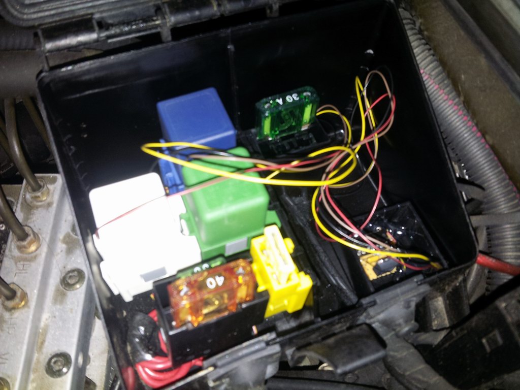

Just recently, however, the fan came on and stayed on until I pulled the green relay in the engine bay relay box. This time the thermostatic switch (Haynes S29) really has gone bad. So I googled around for a replacement and found it costs around £30
Now call me tight but no matter how fancy the housing, that's plain silly for a bi-metal switch. Given that this is there to circulate coolant and blow air through the radiator/over the alternator after a hot engine is turned off, I've knocked-up a timer with some old-school logic gates that switch on the relay (Haynes K27) for a few minutes every time the ignition is turned off. All the wires are just pushed into the relay bases but it works a treat
The white relay (Haynes K22) has a handy tap point for the ignition on terminal 86 and ground on terminal 85 while the green relay (Haynes K27) has constant 12V on terminal 86 and grounding terminal 85 with the timer (S29 Disconnected) does the job.

The only problem I can see is that it won't run the alternator cooling fan if the block gets hot with the engine running. I don't know if this is a realistic situation given that the main electric fan should keep temperatures in check. Wish I'd wired a LED on that circuit before (often wondered about it!).

Do you have a Listing of what them relays and fuses are, and for their functions?
