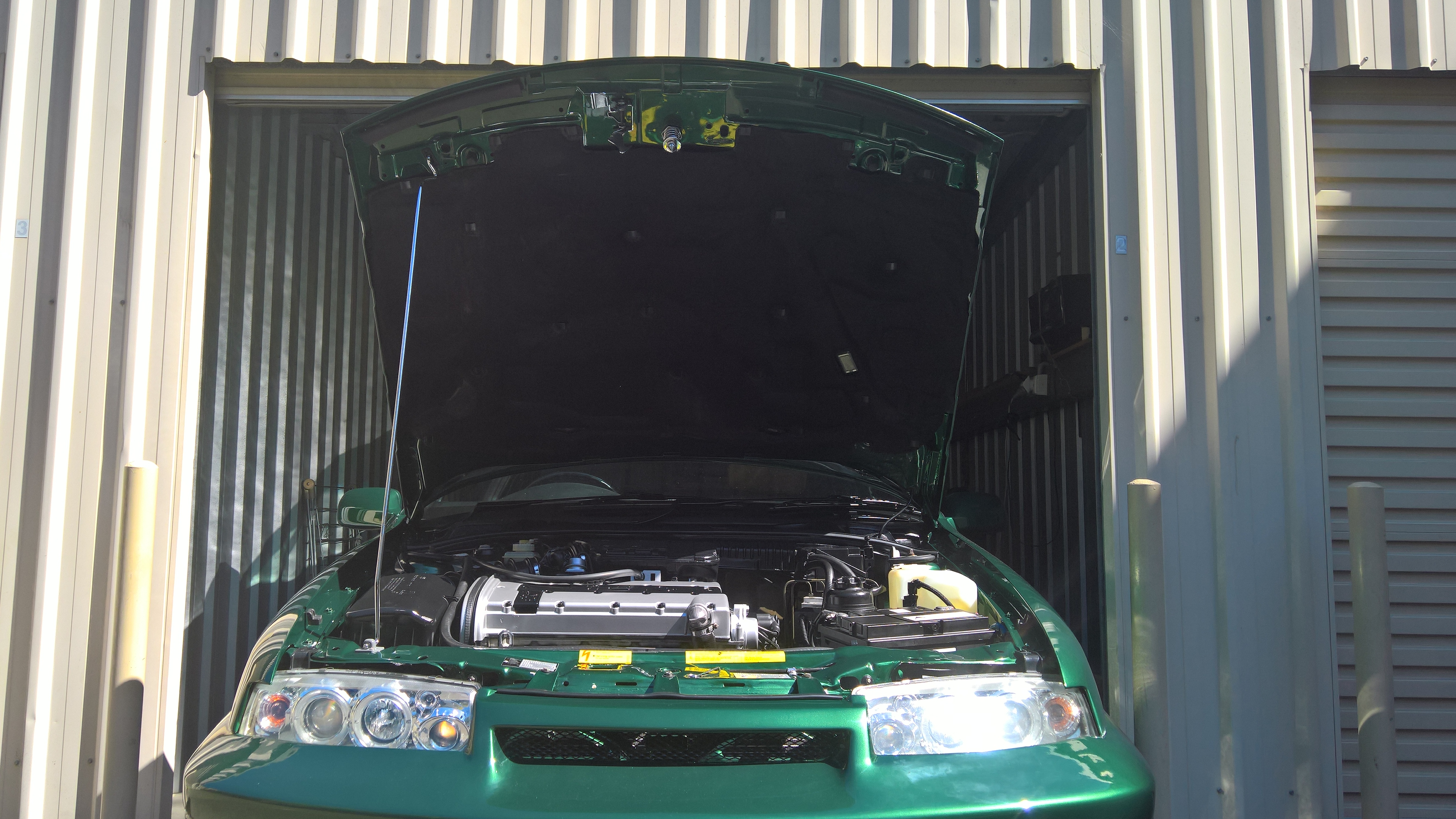

by cal16v » Thu Mar 30, 2017 7:24 am
Bonnet has been returned and the re-spray has turned out spot on. Very happy now :lol:
Need to fit up the bonnet latch and mounts etc and install the underside padding and that's another task completed. Looks like the rain has set in here for good... it's been raining most everyday here for the last month with another fortnight at least predicted :cry:

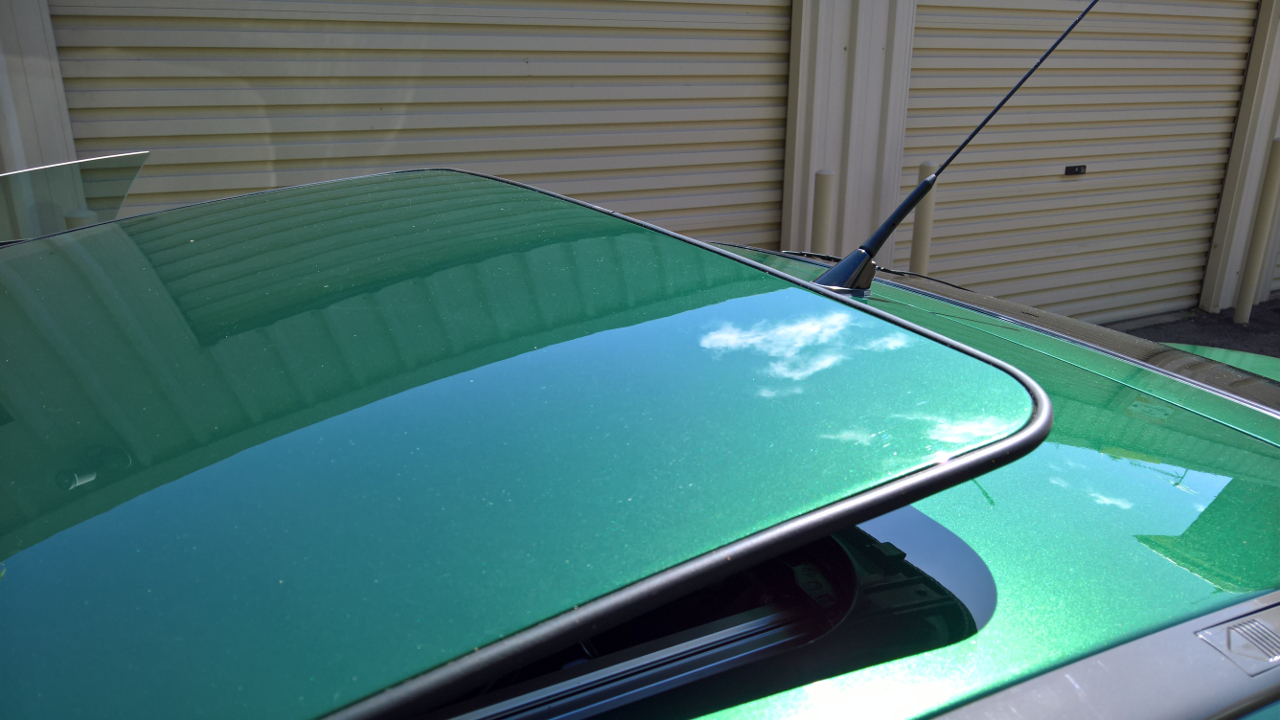

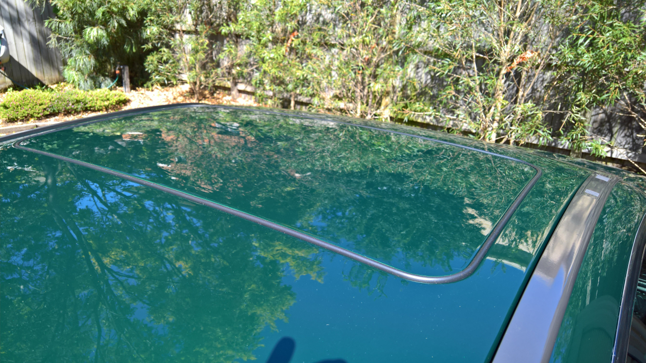

by cal16v » Fri Mar 31, 2017 6:07 am
Sunroof rubber...

Re: cal16v's WIP
by cal16v » Sat Apr 01, 2017 2:26 am
Under bonnet lining...
