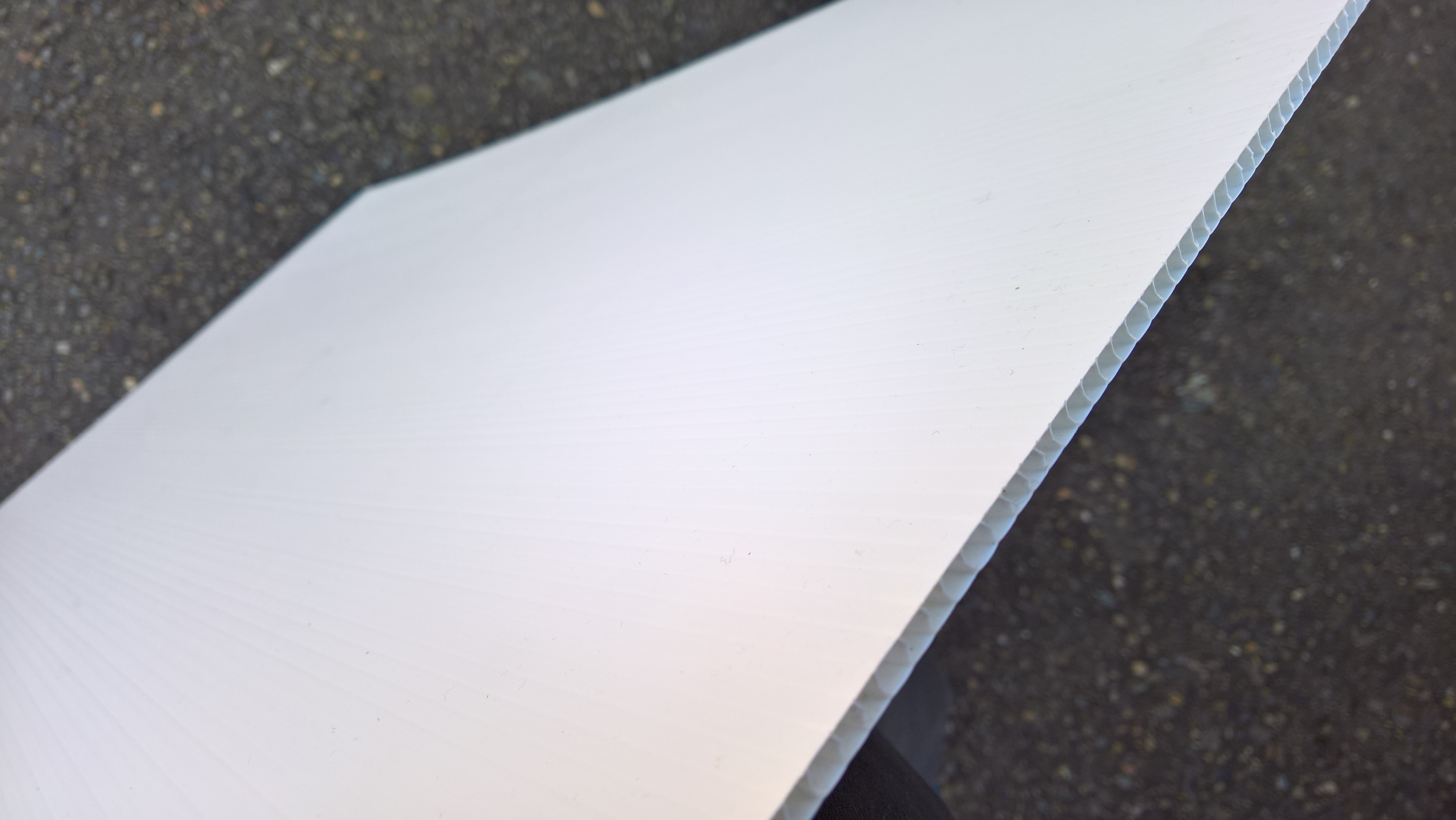

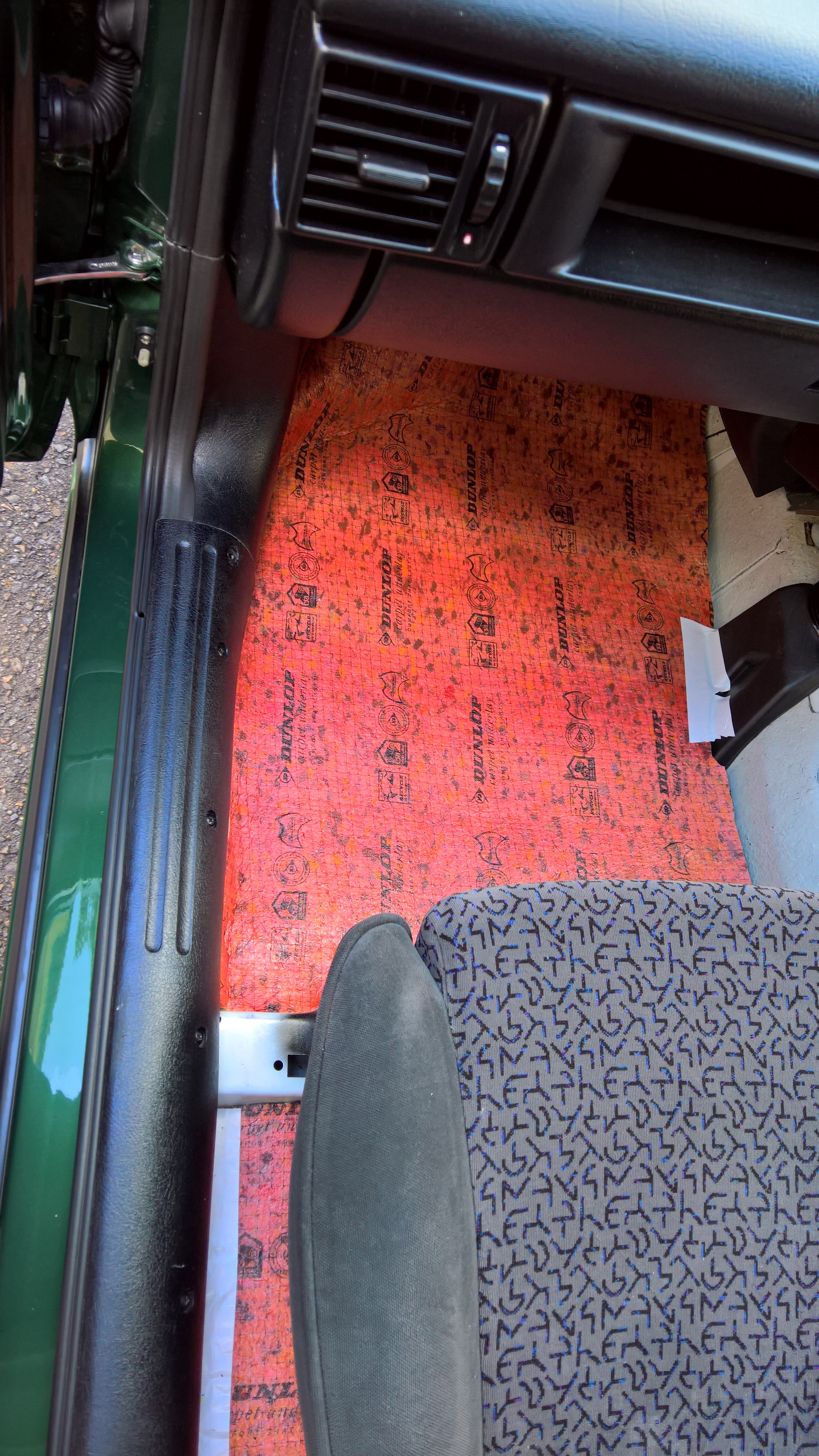

Anyway the task is not rocket science but some pics of what I used and how I went about things.
Fluted board 5mm... to level to base floor
Marking to cut around rear heater ducting
Regupol underlay in place
Just need to finish taping the foam around the edges in the passengers footwell (I ran out of cloth tape :oops: ) and layer either side of the tunnel to build up the carpet layer to finish flush with the sides of the center console.
Thin layer of foam over the top.

by cal16v » Fri Jul 21, 2017 8:16 am
Better late than never.
