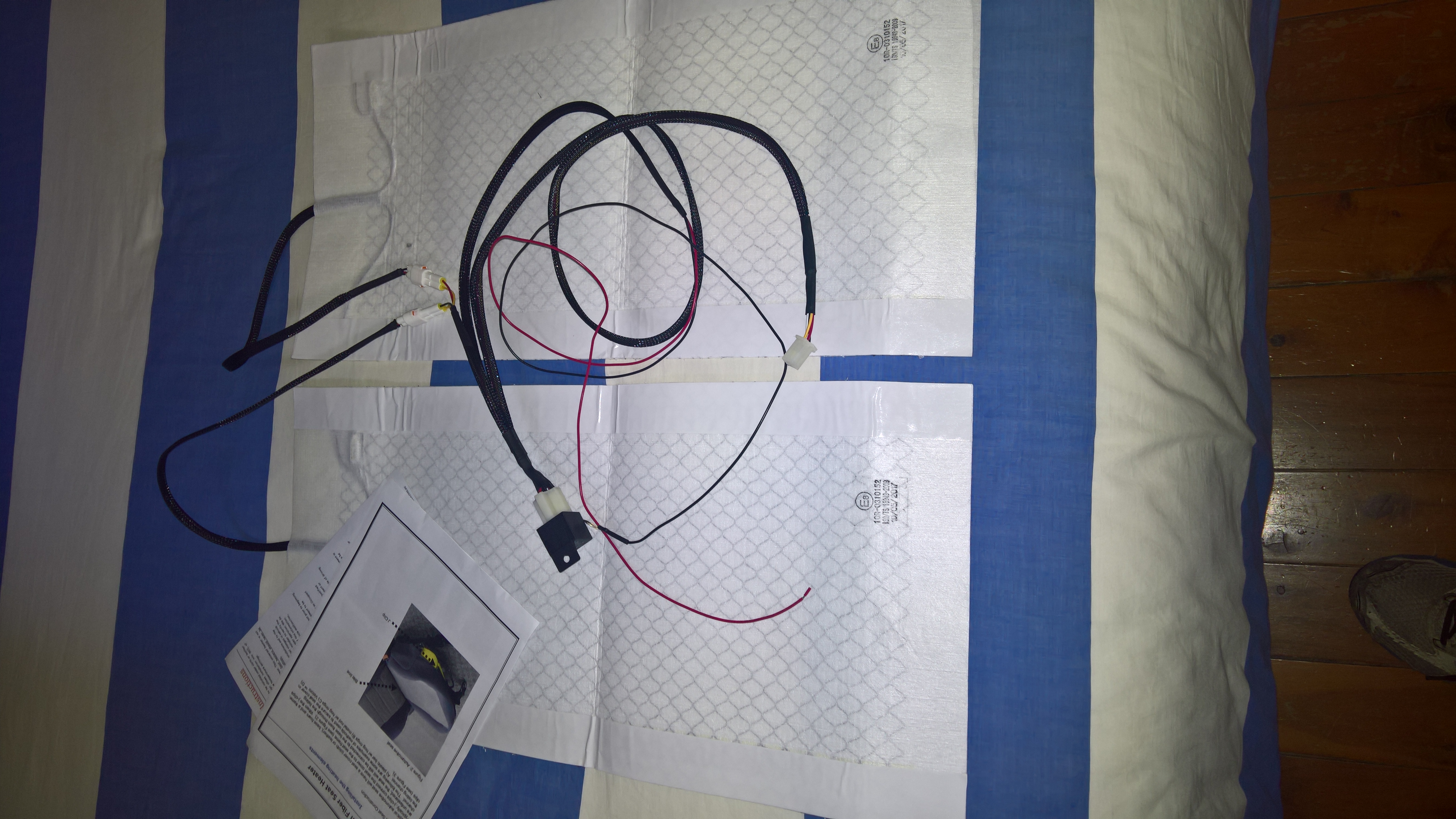

On somewhat of a brighter note this morning I received the following in the post;
The seller very kindly included the relays and the additional harness required. I like that the elements themselves are edged taped and even the additional wiring is properly harnessed. The elements also can be trimmed to tailor the fit with additional edge tape supplied to complete the job properly.
